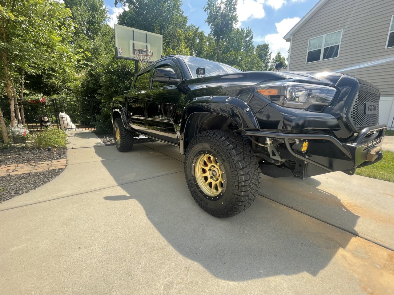

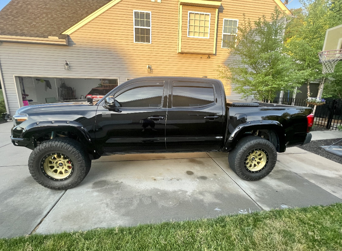

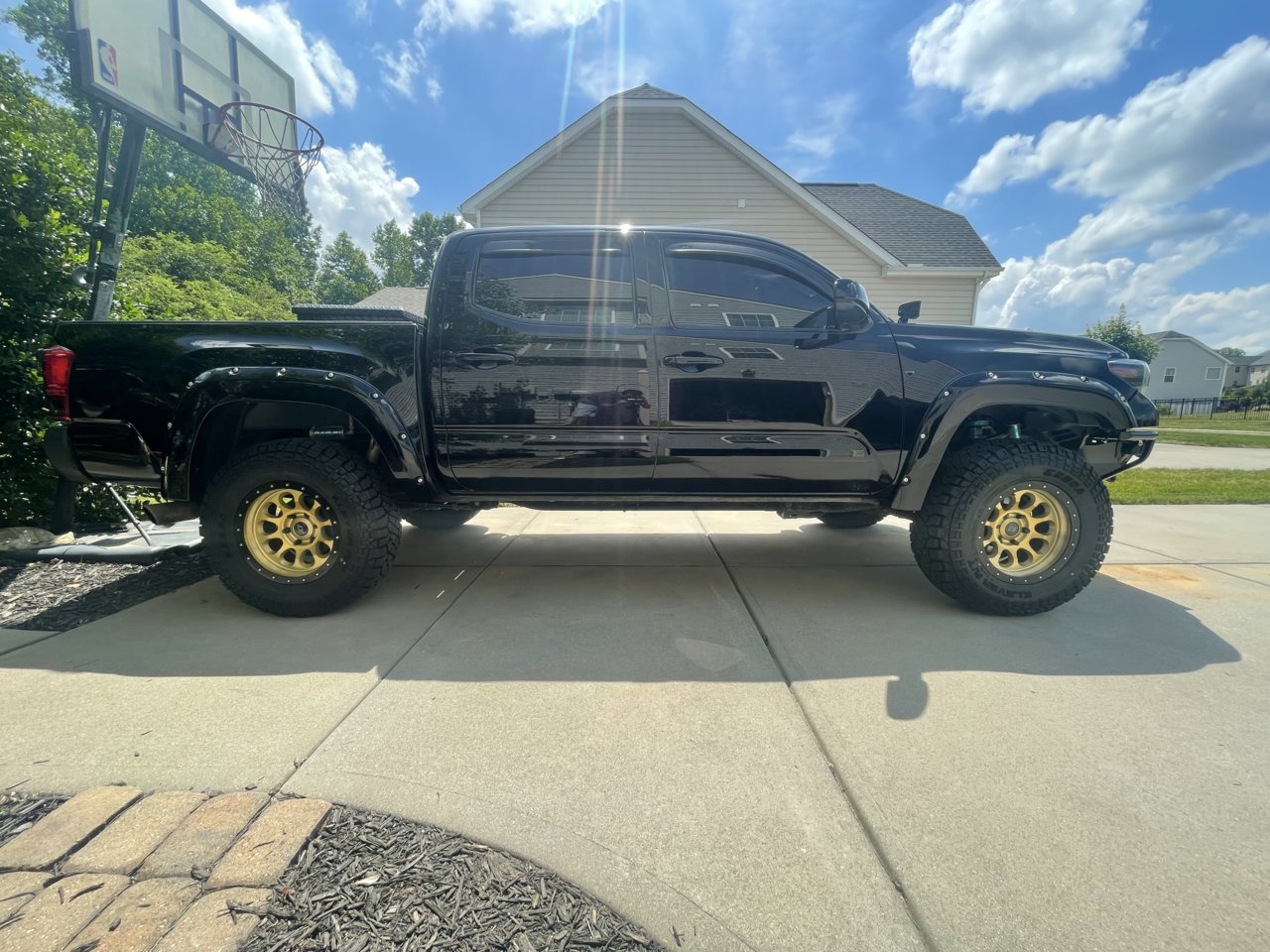

    33"s
    33x10.5-17 Kenda Klever on a 2021 bone-stock SR5
    The wheels were advertised as 17x8et15 but actually measured out to et8 (4.75" backspacing on 8.90" overall width).
    Under heavy braking while turning I got the tire to -just- touch the front spoiler. Otherwise, no rubbing.
    The tires have a 1/4" smaller section width, and about 1-1/8" taller diameter than the easier to find 265/70-17
    In front of the front wheel.
    Behind the front wheel

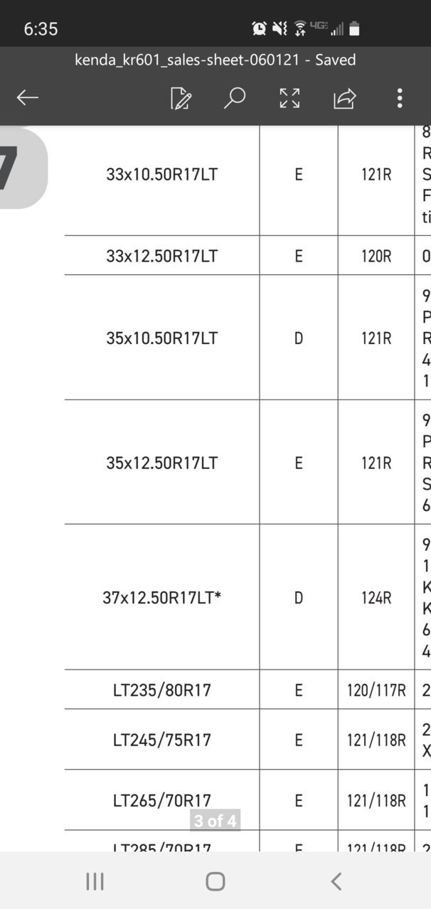

    Y they no make the 37 in a 10.5, guess I'll have to get them anyways in the future once mine wear. Screenshot_20210728-183537_Office Mobile.jpg

    They are about to be released in a 37! I’m running the Maxxis AT’s right now because Kenda didn’t have them out yet. ETA is August or early September from my source.
