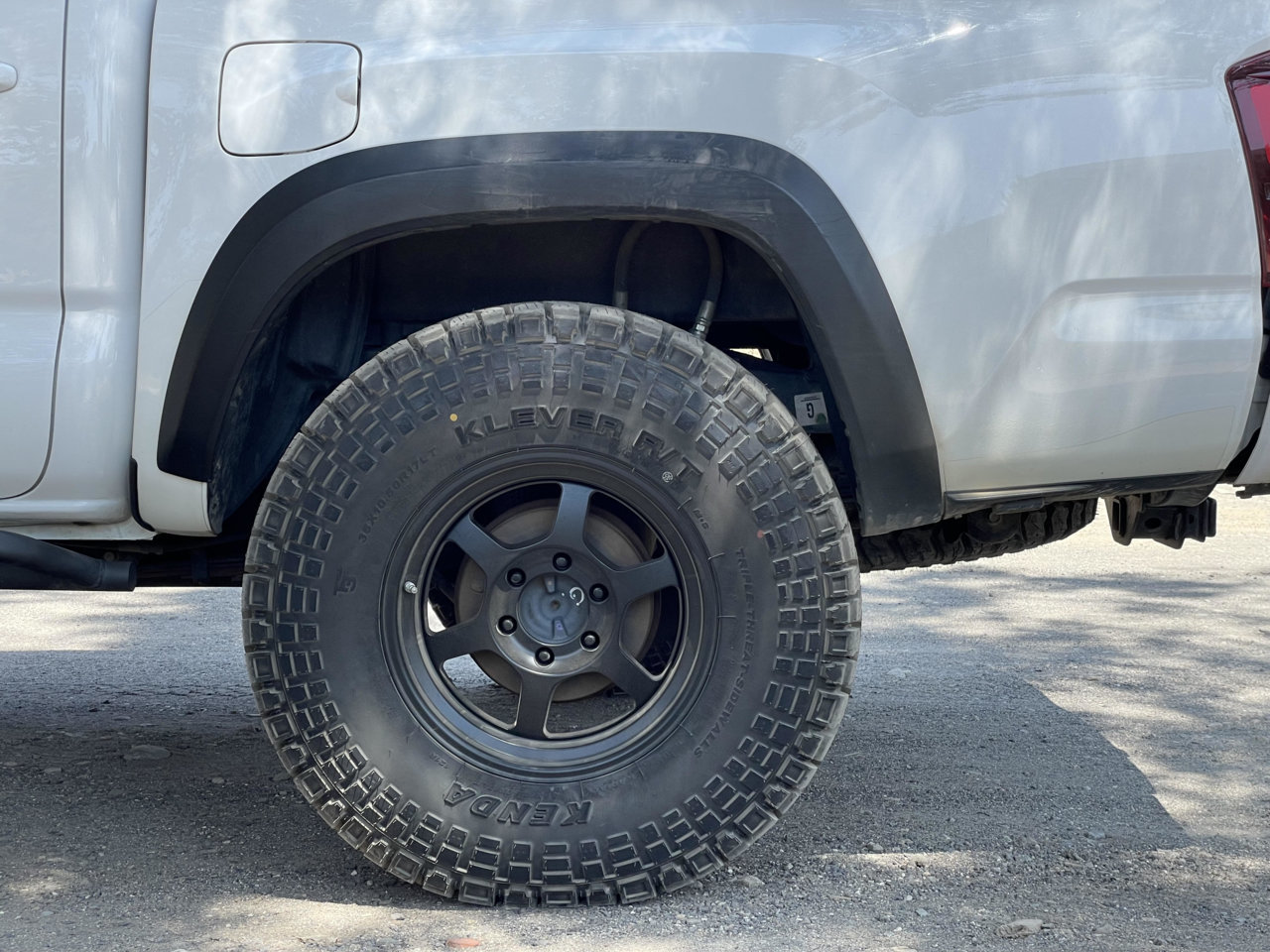

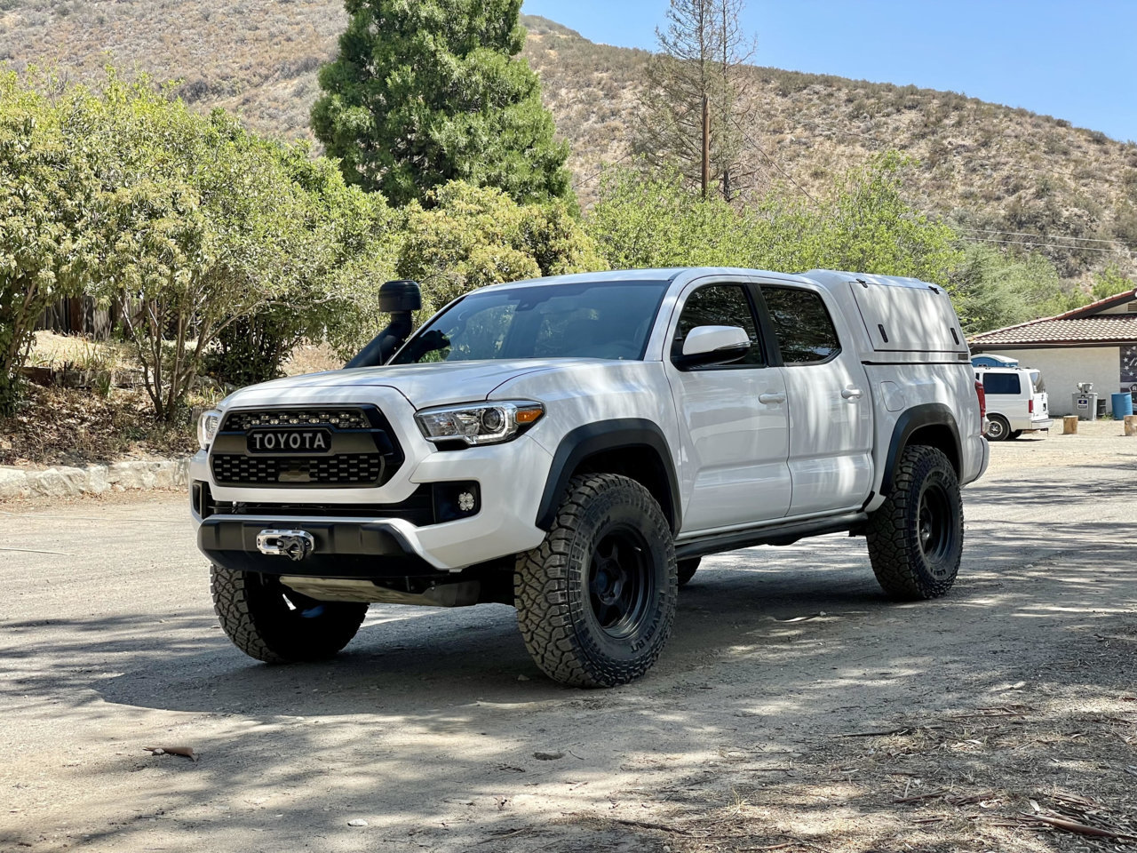

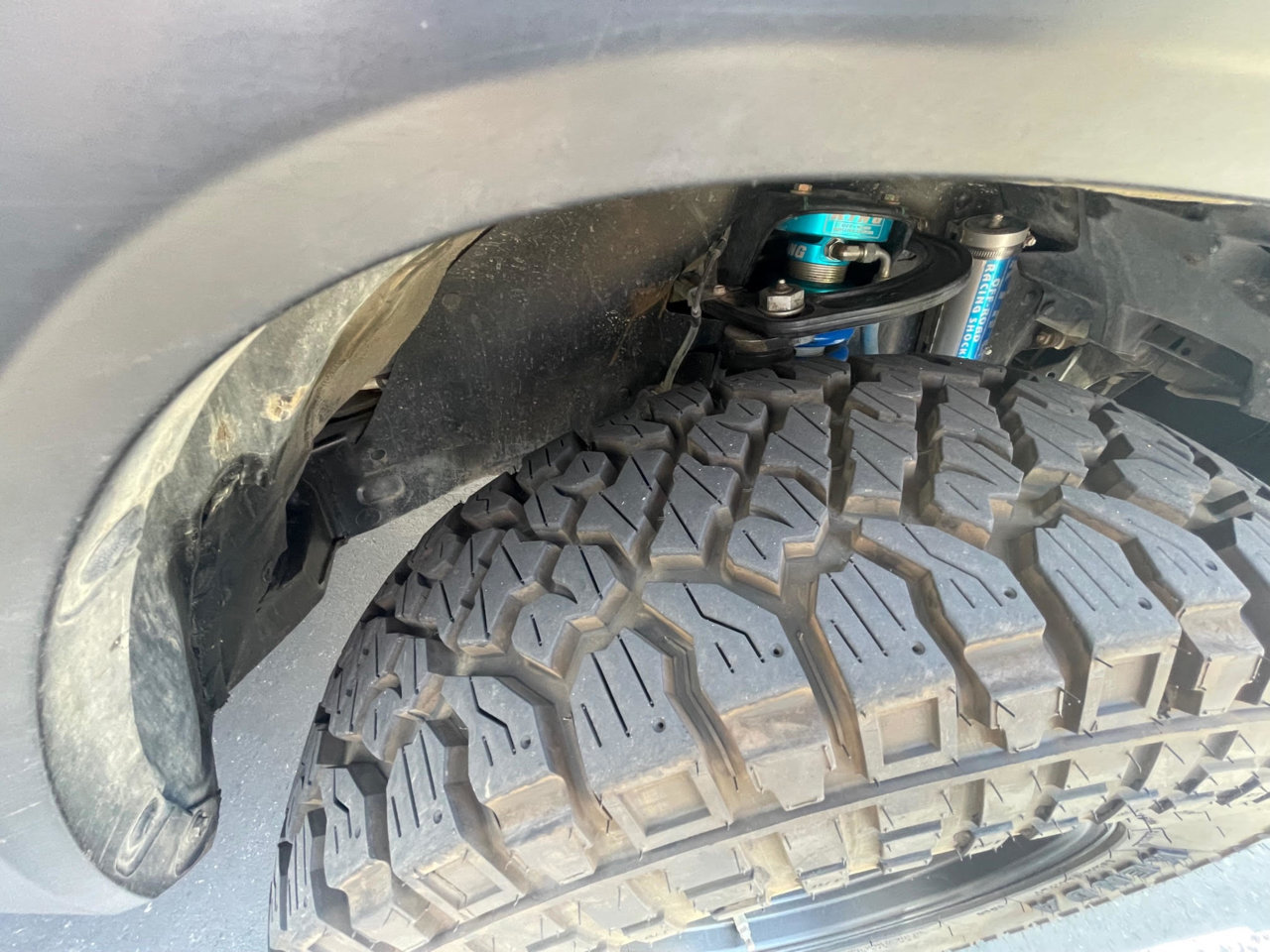

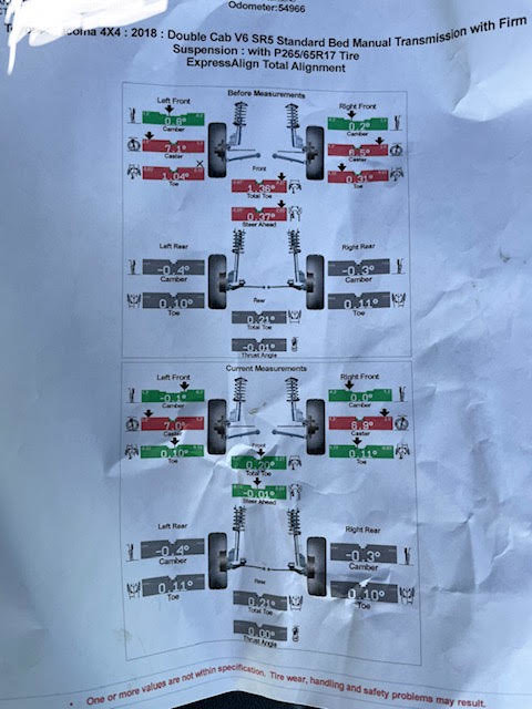

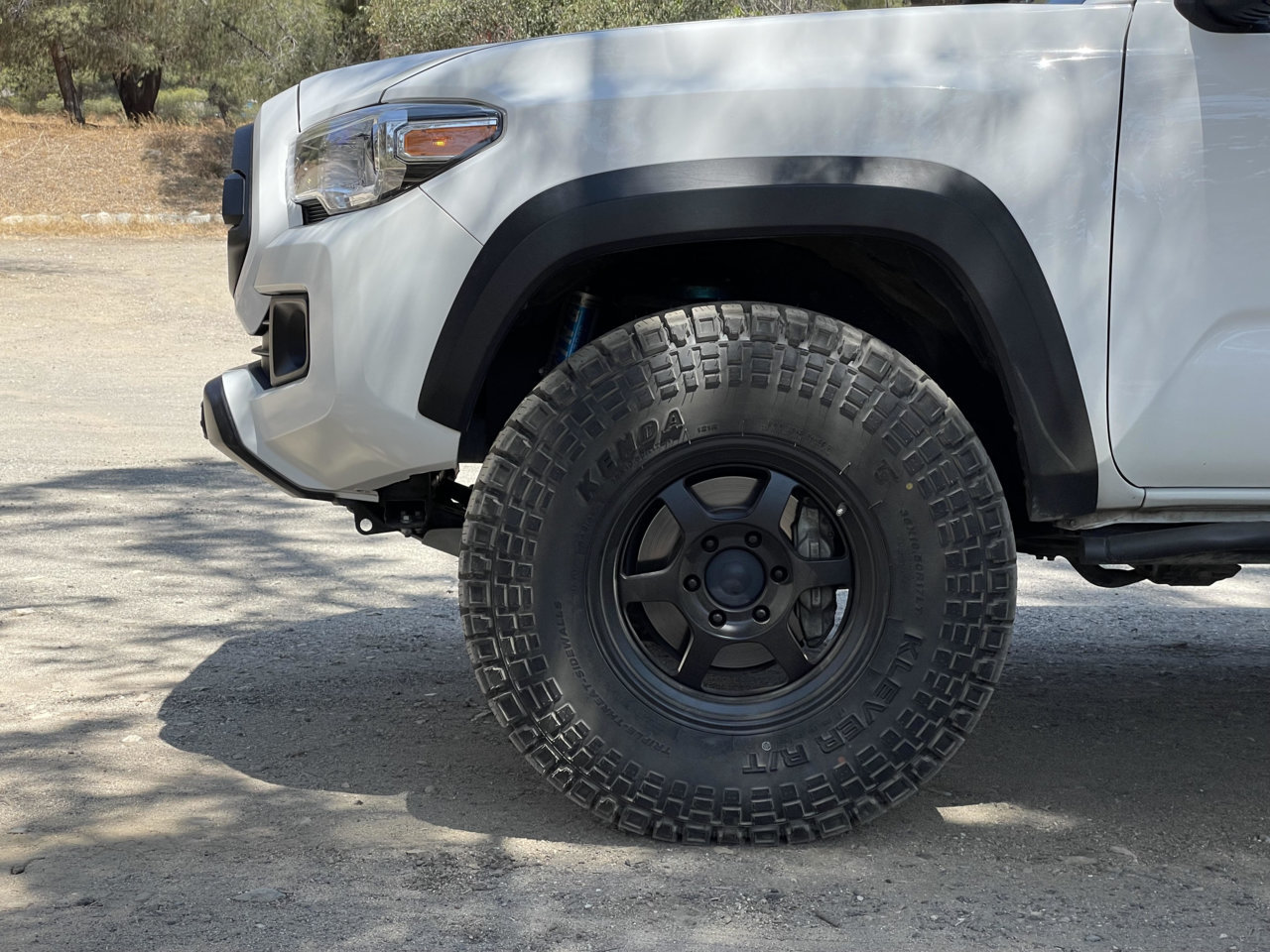

    Alignment & pics:
    FYI, shock in THIS close up, has two turns more pre-load than when i took the pics of the truck below. Going to add a few more to help but I prefer the least amount possible.

    Wow that is a lot of caster. How heavy does that thing feel to drive?!
    My trick is position D for the balljoint, eyeball camber for top bolt (but slightly positive camber on drivers side), lca maxxed out in rear and pulled in in the front.
    Caster is fine at 3.2 driver and 3.6 passenger.

    I can see your UCA ball joint is in the rear most position. Flipping it all the way forward will make a huge difference.

    Way too much caster the 3rd gens really only need 3 degrees to bee gtg

    This truck is absolutely perfect. Love the height and the 35x10.5 look like the perfect aspect ratio. What was your lift height, front spring rate? Rear leaf setup?

    Update: I re-did the caster plate on the SPC upper control arms to roughly the middle spot, which has helped a TON. My friend warned of going all the way forward for handling reasons so we're going to try this out for a while first. I also added some more pre-load to the Kings in the front and went to a stage II Deaver in the rear which Deaver was awesome about helping me get done quickly before Overland Expo. Lastly I did a tiny bit more trimming on the inside front, now that the tire is pushed more forward. Day to day I am not rubbing at all, even turning hard in to ramped driveways. I did some wheeling out in Prescott last week before the show, and it did rub again at roughly 15% (a slight amount) of steering angle at full stuff. Full lock and stuffed it does fine. When I get some more time I will find where specifically it is rubbing and see if it is easy to trim. I'm also still leaning towards switching to a 4Runner wheel with zero offset which should help a lot by pulling the tire in .4ish inches... Overall I'm much more happy with the fit now, thanks for the help and advice. Also full size spare is in stock location, I chopped the exhaust to a turn down out of the muffler and cut off the hangers / tire guides. On to the pics:
