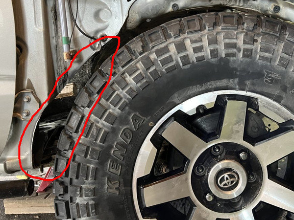

    35x10.5 On a first gen 1.25” spacers +15 offset
    Clearance at full bind of ball joint with tub and hammering

    That's indeed a lot of tubbing :thumbsup:

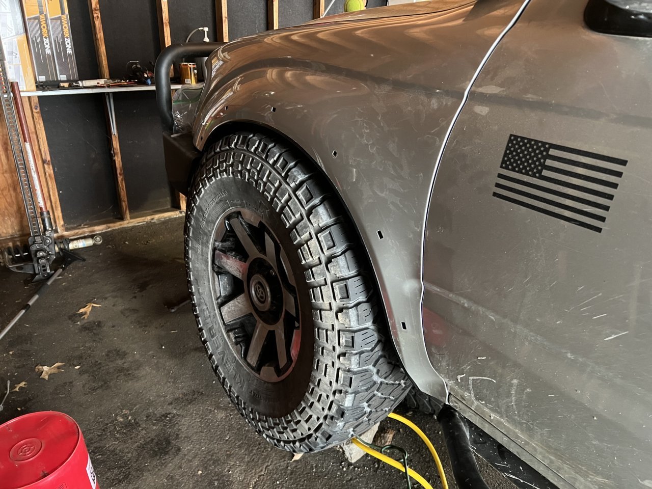

    You definitely don’t need to cut that much out of the a pillar there. While I’m at it I would rather it clear if (when?) I decide to go with a bigger offset or 12.5s.
