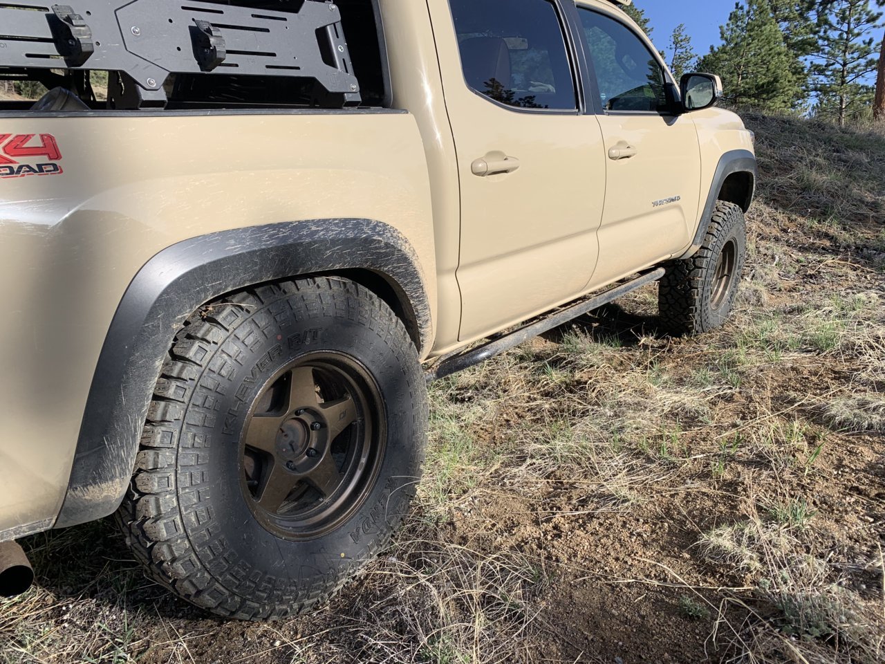

    E14E95BF-C869-4E48-94D0-B10415EA9FC3.jpg Checking on clearance now that I’ve got the alignment squared away up front, good news is the rear looks like it’ll clear the fenders, still some trimming to be done up front

    Any pics of the trimming you’ve done up front so far? I’m thinking about getting these tires or the 255 85 r17 Baja boss. I have icon delta joint UCAs so I won’t be able to push my wheels forward like with SPCs. I do plan to relocate the body mounts so hopefully that will help.

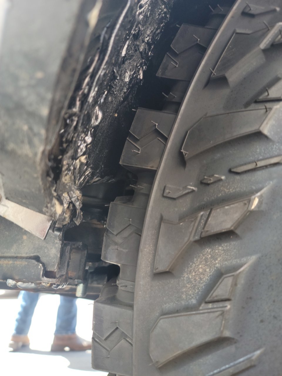

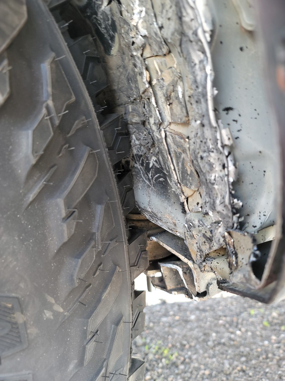

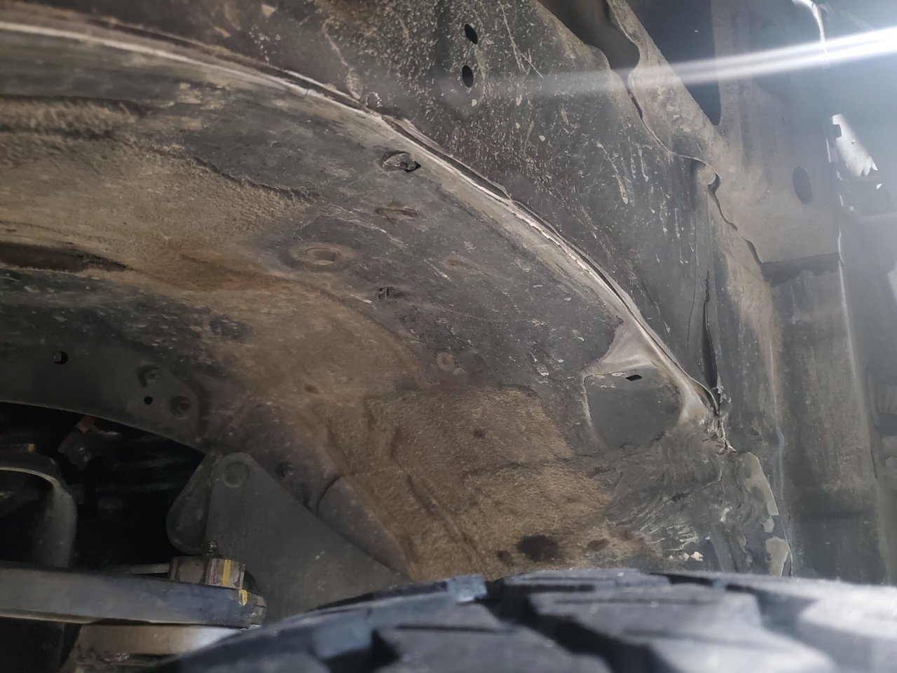

    Skinnies rub so bad on the inner fender, its now all cracked and bent up (self clearancing I guess?)

    Because I wanted to see what @Chadr7858 did. I’m well aware of what is required to fit 37-40” tires. I asked what HE did, not everyone else. My inner fenders aren’t too bad. They have been hammered but no cracks. Maybe it’s my super bumps up front.

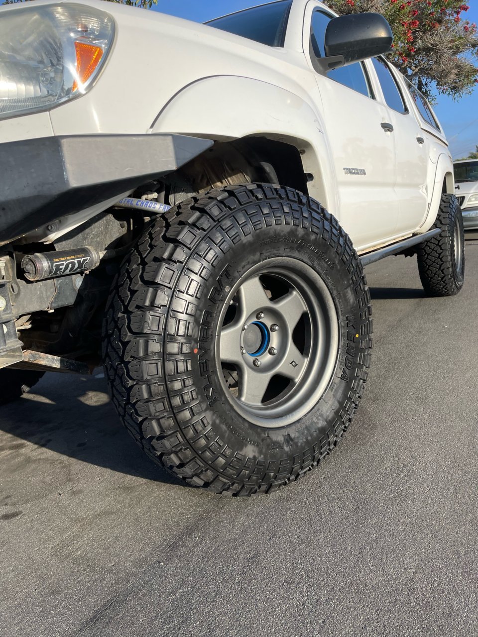

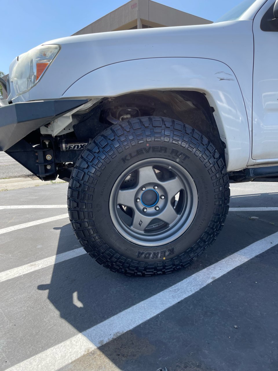

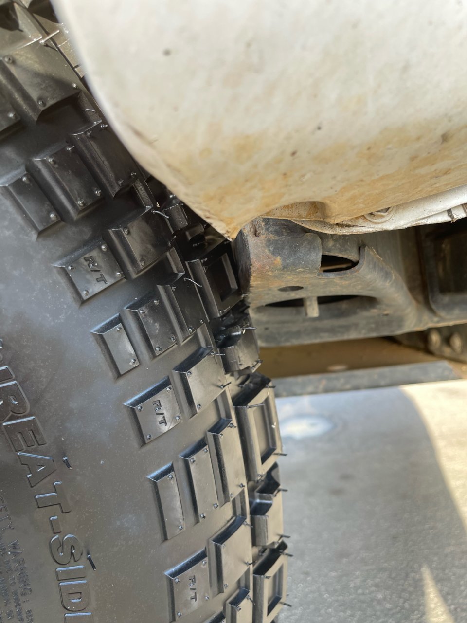

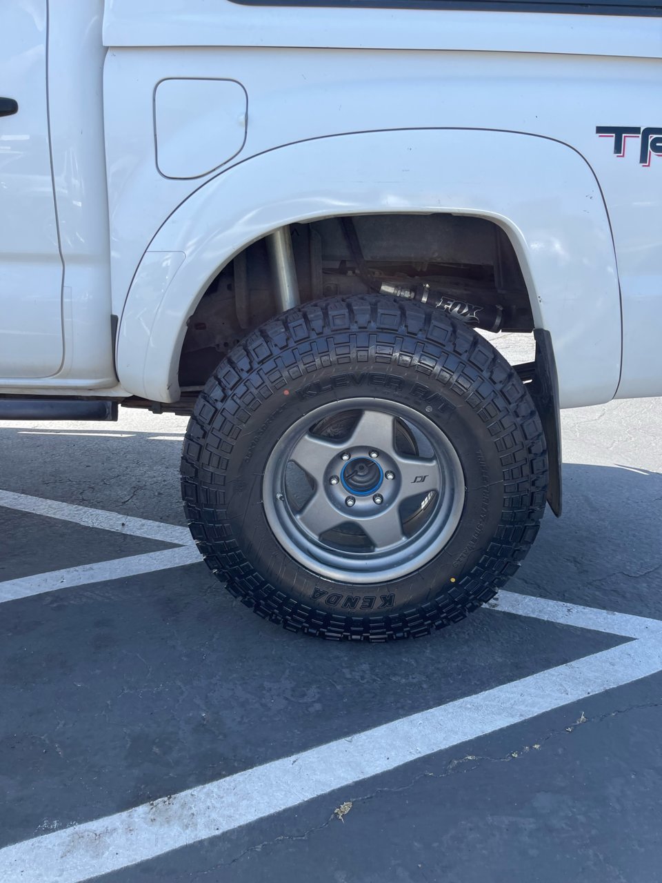

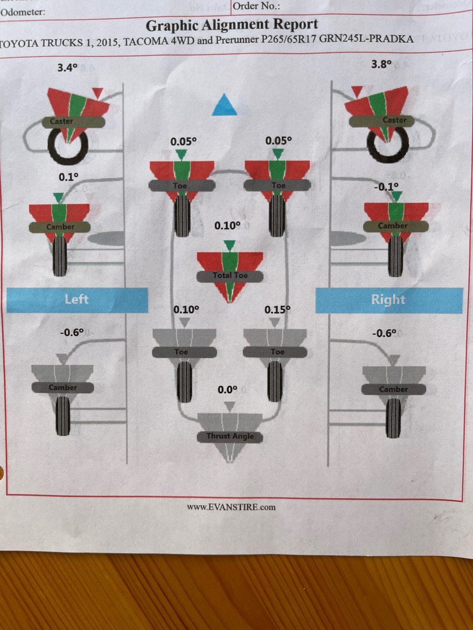

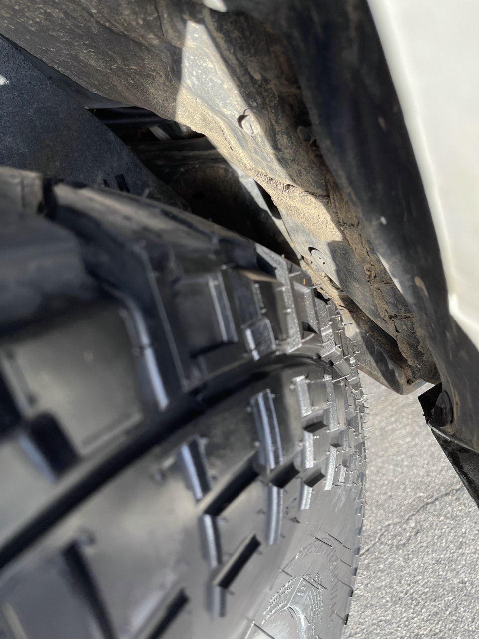

    Well, they are on. Mounted, balanced, and aligned at Evans Tire. It looks like I'm in the cab mount at full lock. Am rubbing a bit on some plastic in the same area. I'm wondering if the alignment is partially the reason?
