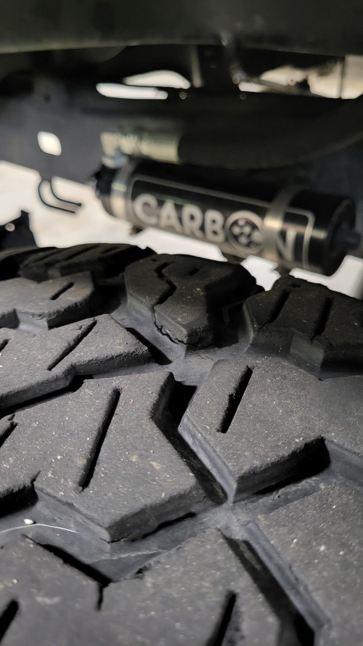

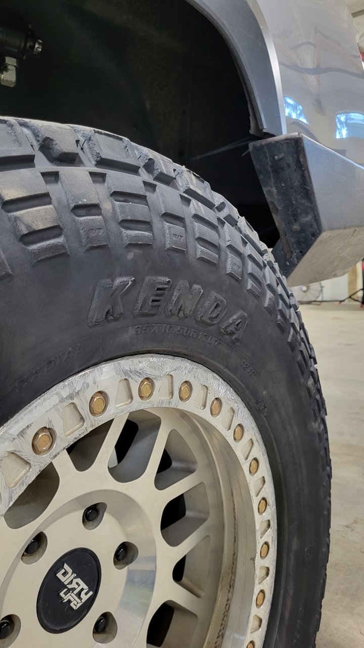

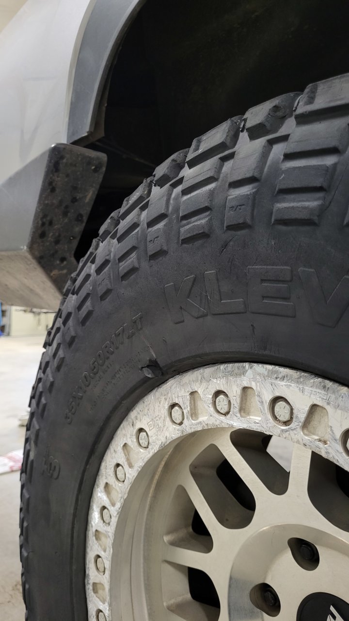

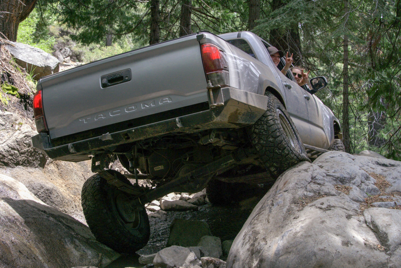

    Well almost time to call it a day for my Kendas! 49k miles on them and they are still inching by. Never have had an alignment, have knocked my junk out of alignment almost every trip and they still lasted this long.
    Couple chunks along the bead down to the cords (run them around 8-10psi so I bottom the wheel out pretty regularly), tread block cracks, and almost have wore the labels off on the sidewall. Zero complaints, they have been a phenomenal tire. Live in the Pnw so they see constant rain driving, snow wheeling, etc. 1st drive on them was Moab, and just did the Rubicon the other day as the last big trip for them. Going to run them again (only have to buy 3 as I have a brand new spare still) and then after those wear, do the 37s in either the RT or their new MT.

    Is that tread pic from 49k miles?!

    Yup! Fronts are a little more worn right on the insides now since I wear out tie rods pretty fast, but still reasonable tread in the rear
