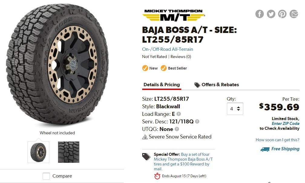

    255/85R17 is right at 34", but 4Wheel Parts calls this size Baja Boss AT a 33.2(not sure what thats about).. I like the 255s, and wish there were more 85 options.

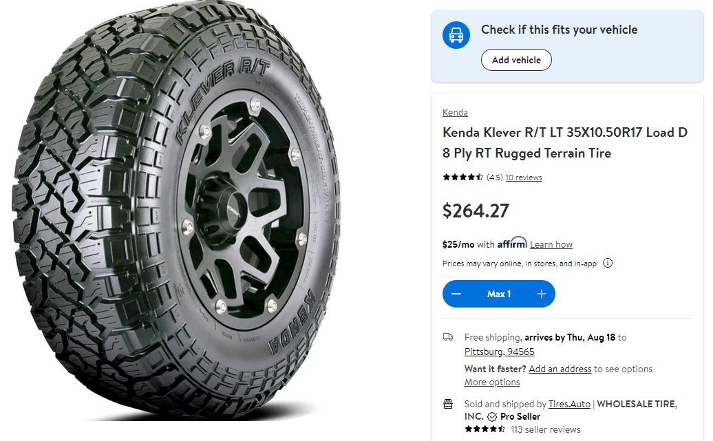

    I’m curious where you’re seeing the prices for each tire?

    4Wheel Parts' website is wrong. MT website shows 34.6". I can confirm the 34.6", I bought one to test fit on my Tacoma.

    Well 255 85 17 is 34”, so i guess the next option to size it would be 255/90R17 so maybe it was safer to call it a 85 than a 90.

    That makes sene. Pretty good price difference.

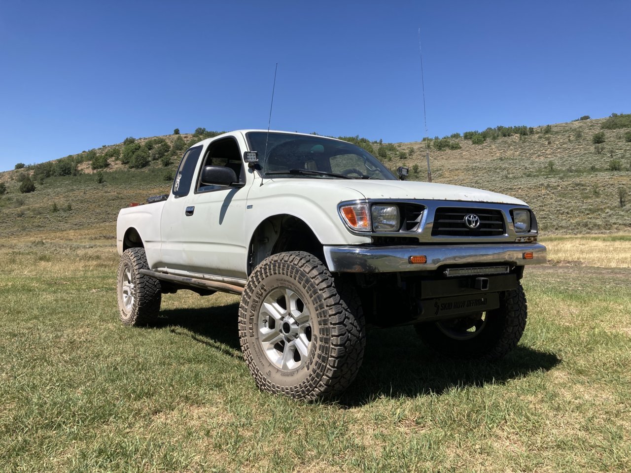

    Recently got me some For the 1st gen. Look forward to testing them out. Love me some skinny’s.

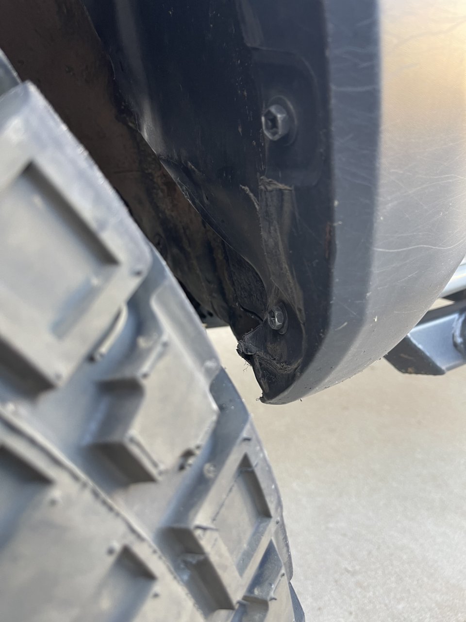

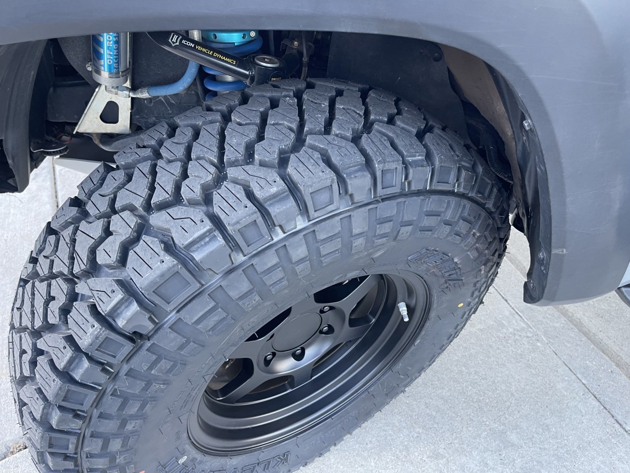

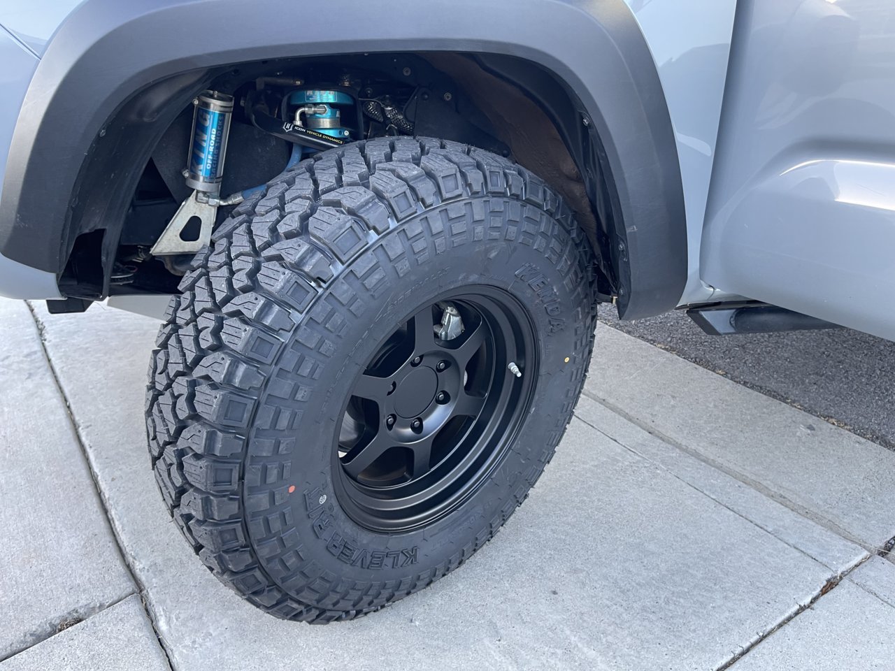

    What are your wheel specs? width and offset specifically? And how much cutting did you have to do? Thanks
  16. Aug 24, 2022 at 5:16 PM
    #416
    99ranged
    99ranged Well-Known Member
    Feb 29, 2020
    #320675
    305
    Northern CA
    '19 TRD OR

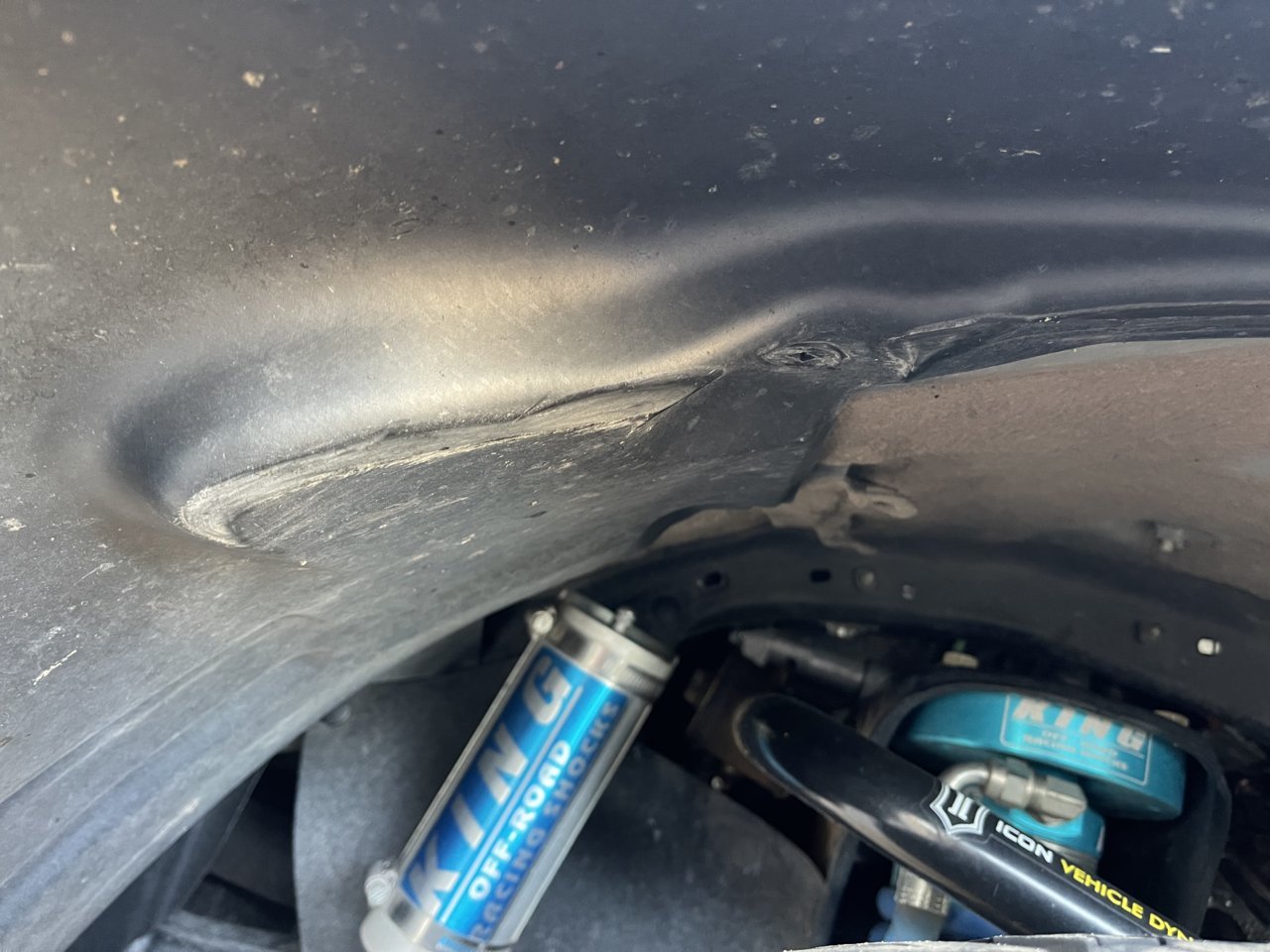

    Wheels are 17x8 -10 offset. I had a cab mount relocation done using DRT fabrication body mounts. I still need to cut more of the inner fenders and also it rubs at the top of the wheel well. At this point I’ve accepted that rubbing is a way of life.

    Man, I was really hoping to pull these off on my 17x9 -12ET wheels but I have zero desire to get into a cab mount relocation or severe trimming. Maybe 33's are more up my alley, unfortunately I will have to look at getting narrower wheels to do the skinnies in 33's.
    Thanks for your feedback

    ^You can avoid a lot of the cutting if you get rid of your -12mm wheels and get something with 0mm offset.
