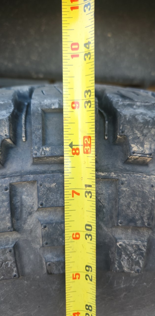

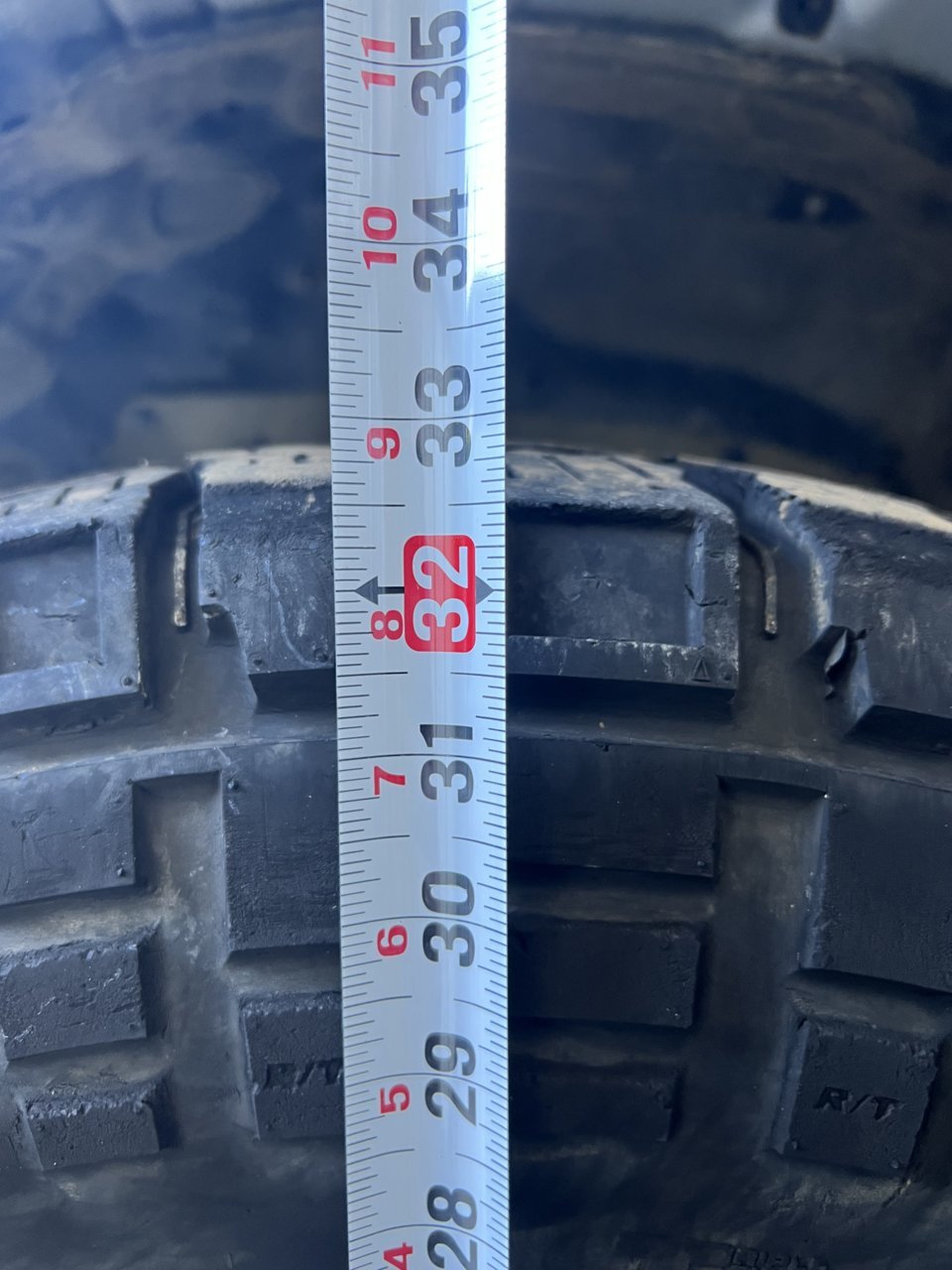

    Do you have rim width and air pressure for those measurements?

    Lost close to 1" with the weight of the truck?
    This is a good question. @Buttskevin21 Do you recall your measurements?

    Yeah most tires lose about an inch with tacoma weight.
    I think mine measured the same 34.75ish on 17x9 wheels at 30 psi

    First gen is 30psi 17x7.5 4 runner trail wheels
    third gen is @95tojo I think 17x8 probably between 30-35psi?

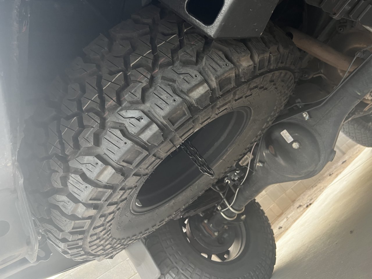

    I've seen it mentioned in a few other threads but has anyone here actually stuffed one of these in the stock spare location under the bed?
    I'm wondering if it's worth it to have one of these as a spare for a 35x12.50 setup or if I should just get a 34 spare and deal with the small size difference.
    I've done all the mods to fit a 33 under there (with a small bit of room to spare), just looking for experience with this size since it would be nice to have a matching (ish) diameter skinny underneath for clearance. I also have hammer hangers, which I've heard can be an issue as well.

    It fits. Rubs the diff a bit but it fits.

    Awesome, thanks for the pic. That's exactly what I was looking for.

    Do you carry it deflated? That's what some Gladiator owners do to stuff a 37" under the bed.

    I think I did deflate it when I first put it in there. Stock hangers allow more room too.

    I think he meant that is why he ordered 5 online, but keeping the spare at home because he didn't try to fit it in the stock spare location. The difficulty driving with an undersized spare was more the point of the post maybe? I thought I had read that the Kenda will fit if you chop the exhaust at the axle and move the mounting point back a bit to avoid rubbing the diff when flexing as long as you aren't running aftermarket leaf shackle hangers that get in the way.
