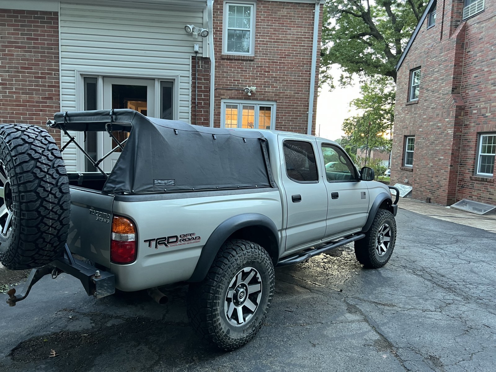

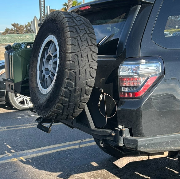

    Anyone know if Kenda 35x10.5 fits steelie?
    looking to run steelie 17” as 5th non-rotate swingout spare
    I think width 7.5”
    hopefully Kenda 35x10.5 fits that
    only 1.5” wider on both sides of the wheel
    according to one site minimum width for 35x10.5 is 7” wide
    So maybe 7.5” width is fine
    don’t really see the point to get another Method 701 17x8.5
    if 17x7.5 steelie would work and probably even look better. $50 vs $300+
    (On swingout)
    gonna have to figure out what hardware regarding bolts or studs to counter hold from behind the different nuts a steelie requires. Current swingout (weld on pending) has a circle mount plate with holes but no hardware.
    swingout addition is vertical with holder arm that looks flimsy. Might have to change it to beefier square or rectangle tube
    I don’t know if angled is better and if wheel specs are a factor to allow for angle…

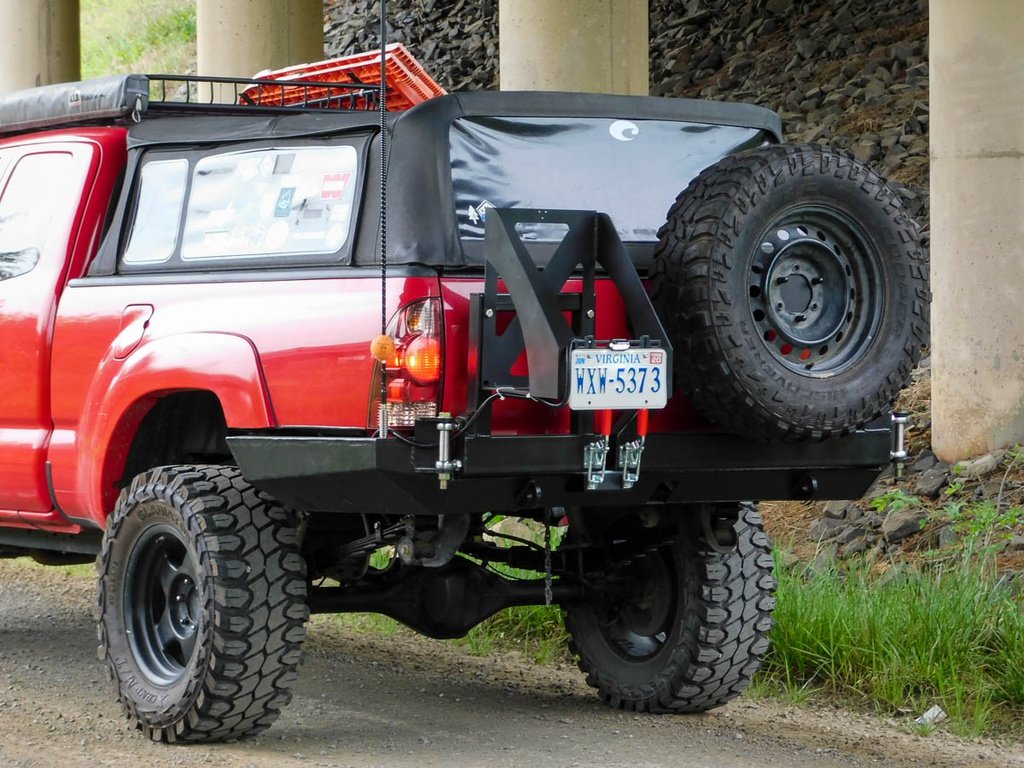

    saw this truck with angle from Nguyen Fab
    looks good but the more I look at it the more angled seems to just worsen departure angle and gain clearance up top where it’s not needed
    Well I mean it raises the bottom corner outside of the tire so maybe that increases departure angle
    but at that point likely negligible
    And any bumper swingout probably worsens departure versus a bed rack mount or bed tiregate mount.

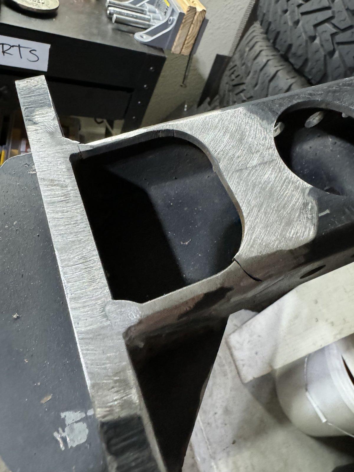

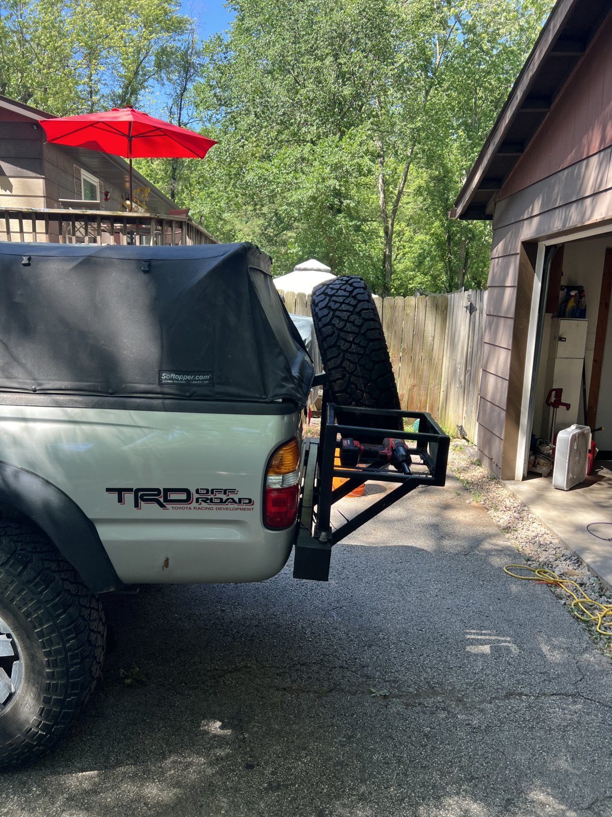

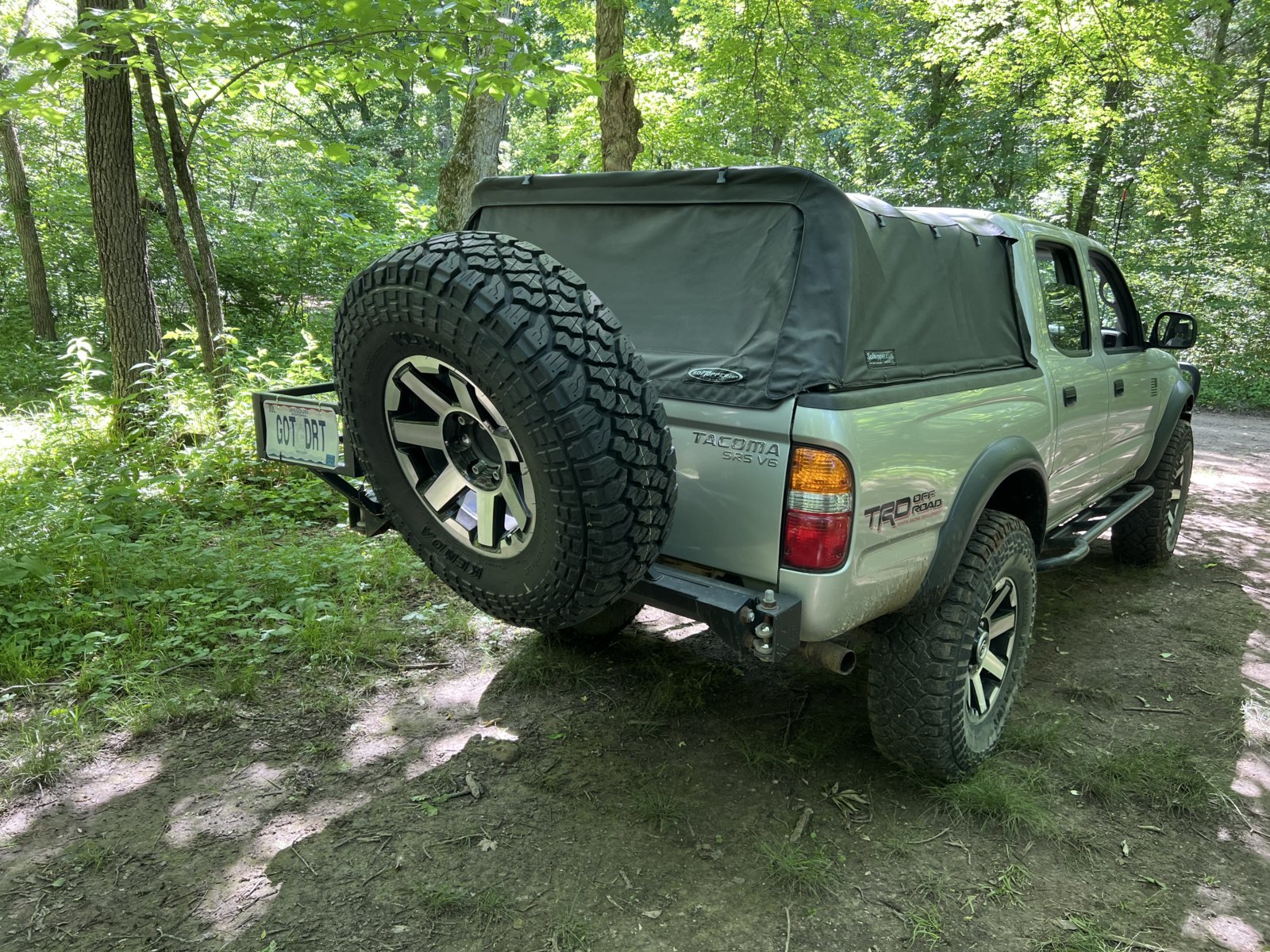

    17” 7.5 wide TRD offroad T4R wheel, I liked it better angled with my soft topper
    and I’ve broken two swingouts so I vote reinforce it. Neither broke from dragging the spare on the ground despise doing it often, but I did get rear ended in the tacoma which could have hurt it.
    Tacoma swingout broken
    4runner swingout cracked up and twisted

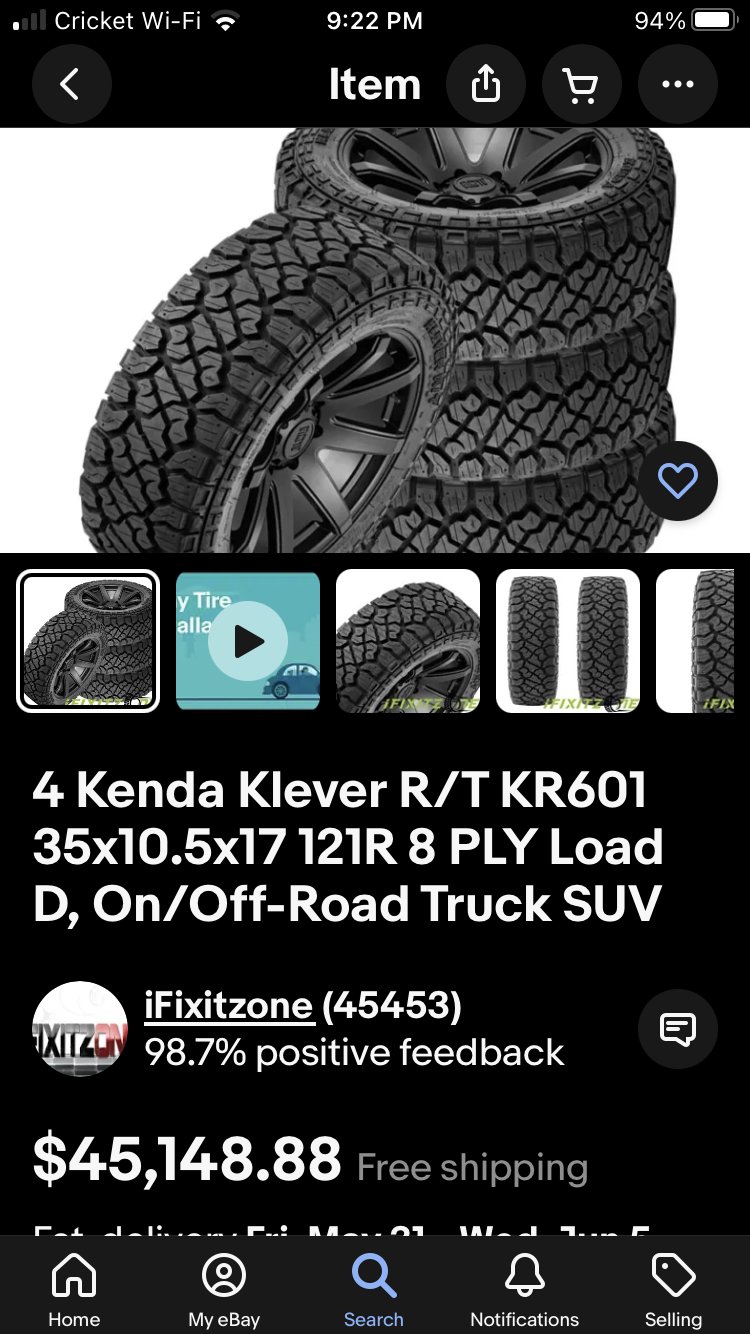

    IMG_7842.png Word must have got out how good these tires are. Bummer, I didn’t think wearing out my tires would total my truck:rofl:

    Money laundering at its finest lol
