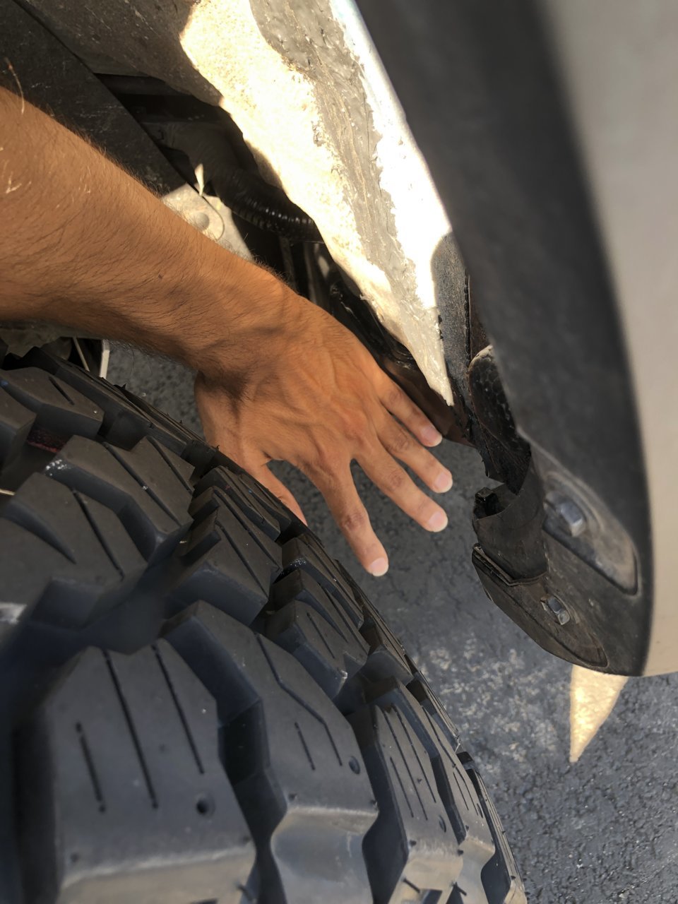

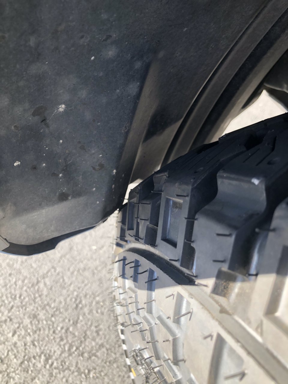

    What is your wheel backspace? Assume CMC and pinch weld hammer?
  6. Apr 12, 2020 at 11:03 AM
    #46
    socalexpeditions
    socalexpeditions [OP] IG: @socalexpeditions
    Sep 22, 2017
    #230791
    5,405
    17x8.5 -6
    CMC done, pinch weld hammered.
    SPC UCA, lowers maxed, fronts pulled in, and on setting E.
    I did do some front trimming to the plastics, as well as heating them up and pushing them in.
    I do not rub at all street driving, reverse lock, full lock, etc.
