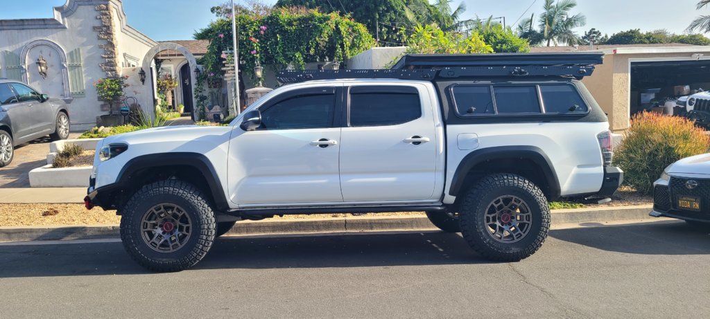

    I'm super glad this thread existed for the motivation to get off my butt and get the Kendas. I've been running kenda 37s on my Gladiator for the last couple years but I've been holding off on the Tacoma because I thought I wasn't properly equipped. But what makes this possible is the fact that it's 10.5 wide. I've already been running about a 2-in lift and got CMC about 3 years ago and a regear about 2 years ago to 5.29s. suspension I've been running the OME bp51 since 2017. I've also had the bumper clearance for awhile. So basically I've had everything I just didn't know I could get the 35s to fit. I just had them mounted yesterday on some of my old wheels and they fit perfect and no rub whatsoever. I see clearance on the JBA UCAs and at the cab Mount no issues. Now wishing I would have done this years ago. I've been running 33s since 2017. I'm in love with the additional height now and I feel like 35s just make the truck perfect.

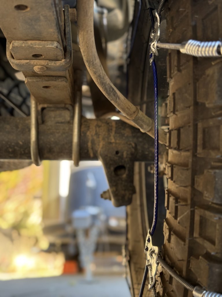

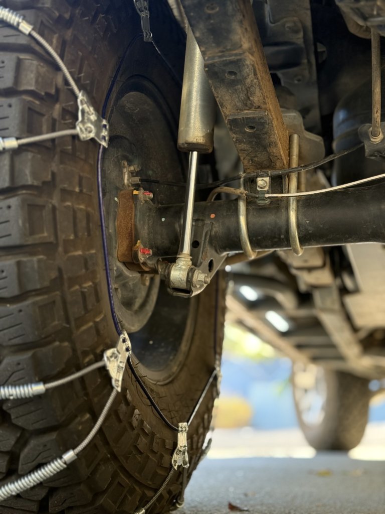

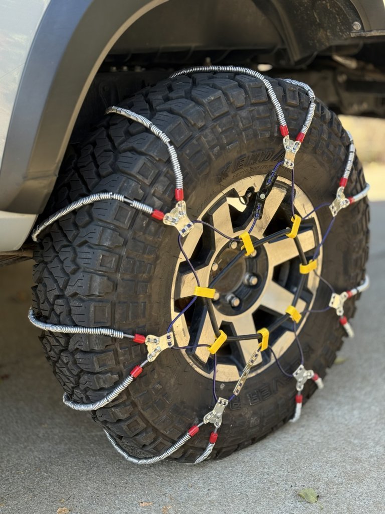

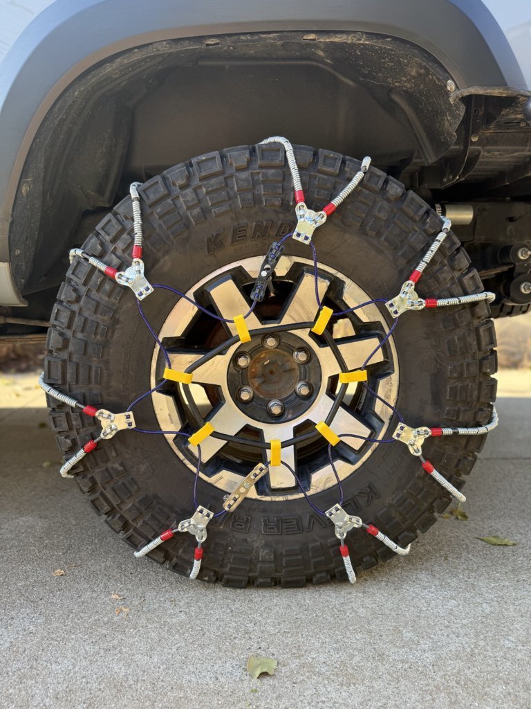

    I tow a trailer and sometimes there are chain controls on the highways in the sierras so I picked up some SZ486 Super Z8 8mm Chains and they look like they are going to work on the skinny Kendas.
    https://www.amazon.com/dp/B000HZA2QA
    Shows they fit a 35x12.50R20 so did some math:
    35x12.50R20
    35" - 20" = 15" + 12.50" = 27.50" outside rim edge around the tire to inside rim edge
    35x10.50R17
    35" - 17" = 18" + 10.50" = 28.50" outside rim edge around the tire to inside rim edge
