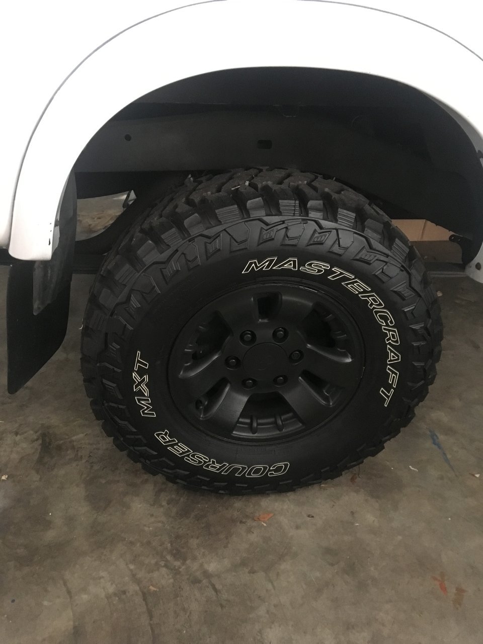

    If I have a 4” lift on will I be able to fit 35x12.5’s on without cutting?
    Here’s what it looks like now with my 2.5 inch w 31’s:

    Also if I take these fenders off will there be holes underneath on the vehicle?

    If you plan to never off-road then you will get some rubbing on full turns. if you plan to do any dirt road or more then you will need to cut. 33's require a little love from the hammer to not rub at certain places.
    those look like later model fender flares on the '00 so there may or may not be "holes" where the fenders flares attach. the wheel wells will be solid with no gaps to the fender but you may have to trim the fenders depending on vehicle use

    They won’t fit without cutting. You’ll need to cut the fenders front and rear to off road and cut the firewall back

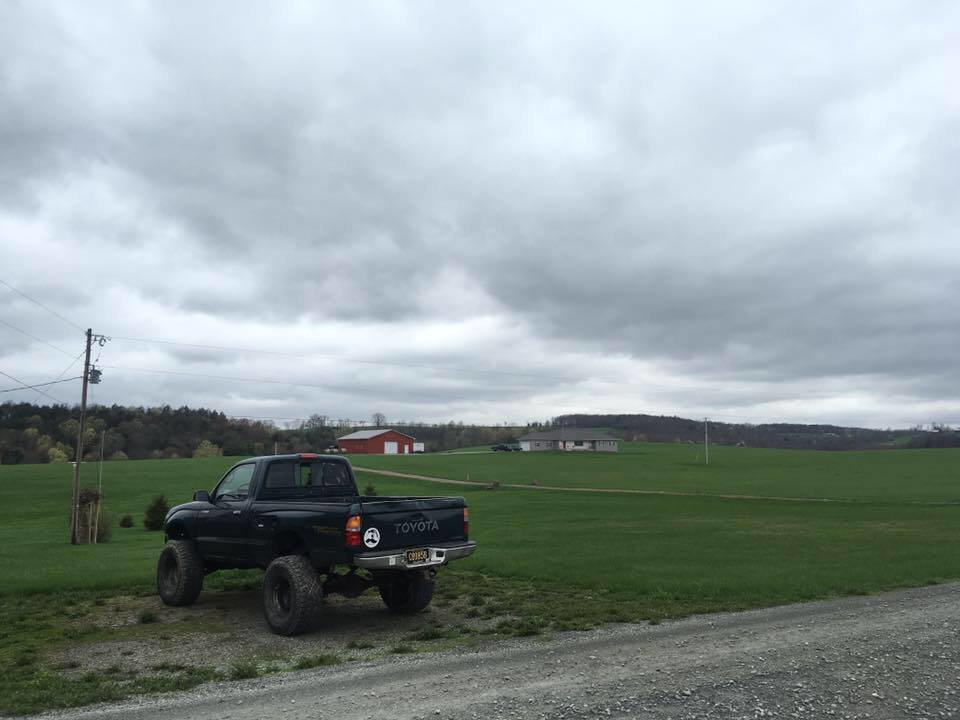

    18057007_1495689533775003_80960767971326_163535bd02428da244bba4284d3e628000b73d6f.jpg
    33x12.5r15 with 4in of lift, never rubs, 35's will probably rub, i plan to get 315/75r16's soon witch are almost 35's.

    No they won't fit without rubbing
    And yes there will be holes under the fender flares
