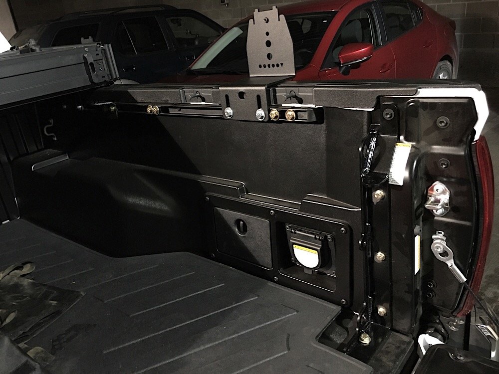

    The following couple weeks, I picked up a fair number of items for the bed. Relentless Fabrications had a sale for Memorial Day and that was just the motivation I needed to pull the trigger on some items I had been looking at.
    I picked up their Dual Quick Fist Mounts and a Hi Lift Jack Mount. As an impulse buy, I added a couple of their Accessory Mount brackets as well. I never had a vehicle with bed-rails like the Tacoma before, but I was quick to find value in them.
    Here, I've installed the Quick Fist Mounts and added a small, but quite functional shovel and bow saw.

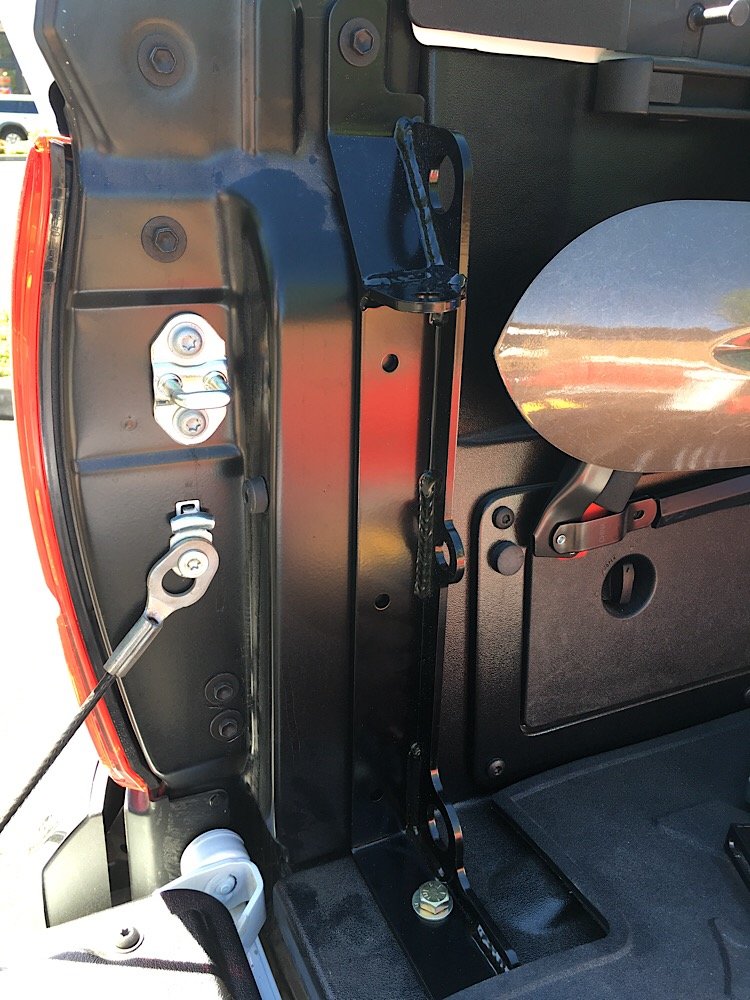

    The first thing I did, knowing that either a canopy or RTT would be mounted over the bed, was to buy a set of bed stiffeners. I went with the Total Chaos set through Wheelers. I really like the attachment points they provide and the way they blend in visually once installed.
    Here's a pic from mid-install, but it's the best one I have. I mounted the stiffeners to the existing bolt locations, then removed the tail light to drill the remaining holes. I sprayed the holes with a metal primer to prevent rust and then performed the final install.
    I mentioned that I don't have a garage, right? I did this work in a taco bell parking lot while eating taco bell. Of interest, I had found an empty corner in the parking lot to work in, but was then interrupted as two cars collided right behind me headed for the drive thru. Literally, right behind my tailgate.

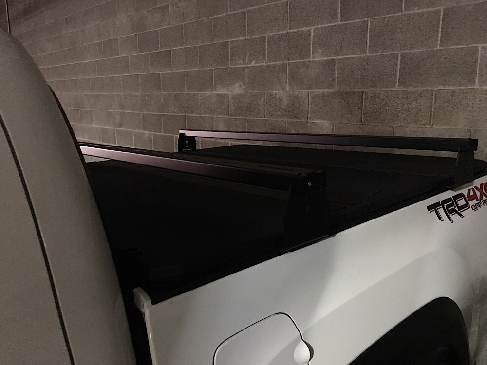

    I have been scouring TacomaWorld for ideas for camping and there are plenty of options to drool over. Ideally, I might go with an in-bed camper like the Four-Wheel Swift, but because of finances and our rushed timeline that will have to come later, if at all. I also very much like the idea of a hardshell tent mounted above a canopy; I may eventually get a SnugTop Rebel and either a CVT hardshell or Roofnest or similar. There is so much good eye candy on this forum. So many wants.
    For now, however, the timeline demands that I take the quickest line to an acceptable solution as our trip is only a bit over a month out. I'm going with a RTT, so now my priority is a mounting system. I don't think I'll be able to swing a canopy on this timeline and I've grown quite fond of the tonneau that came on my truck, so whatever method I choose will need to work with this cover.

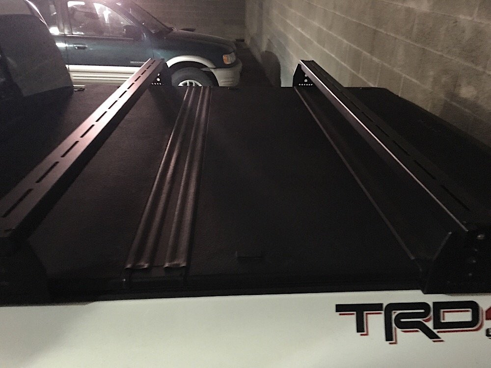

    I picked KB Voodoo's Hi Rise Crossbars for the task. They are a simple design, extremely versatile, and utilize the bed-rail for mounting.
    Here are the brackets mounted to the passenger side. The extra bolts you see in the channel are from the Hi-Lift mount that I'll be installing later. You can also see the bed stiffener in this pic with all mounting bolts installed.
    These bars are hella strong. I am impressed. I have absolutely no worries about overloading them.

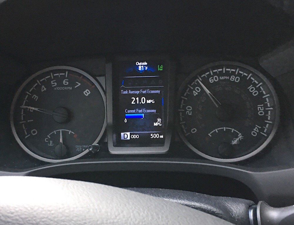

    Shortly after taking that last pic, I hit 500 miles. :humble:

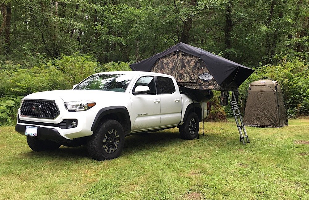

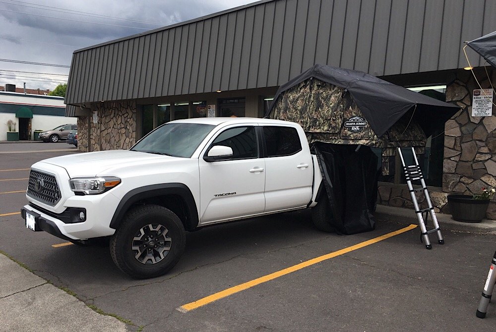

    Made the trip to Cascadia Tents in Bend to pick up the new tent. I went with the Mt Shasta Summit in CVTree Camo. I knew that I wanted one of the more ruggedized versions, whether I went with CVT or Tepui. I lamented a bit about missing the 20% coupon that REI had, but during that time our trip plans hadn't been finalized. I might have gone with the Tepui Kukenam Ruggedized mostly out of convenience, cost savings and REI's stellar return policy in the case the tent had any issues. I was only disappointed for a short time, until the moment I found the sale Cascadia Tents had on their CVTree Camo. It has the important Summit features, including the heavier diamond plate base, thicker water resistant mattress, condensation mat, and heavier fabric. It doesn't have the LED lights or USB plug ins, as are typical of their Summit series, but I can add them later if I decide I need them. For now, I don't.
    I'm generally not a camo kind of guy, but in this case, I'm seeing some benefit. Even in the above pic, you can see the truck, but the tent doesn't draw attention to itself. Also, the darkness of the material will keep the inside nice for sleeping in in the mornings.
    Travel mode:
    Out of necessity, I have to keep the tent low as the garage at my work has a low roof and a max vehicle height posted of 6' 5". I do miss having an open view of the vehicles behind me, but I still have an adequate view of my blind spot for lane changes.

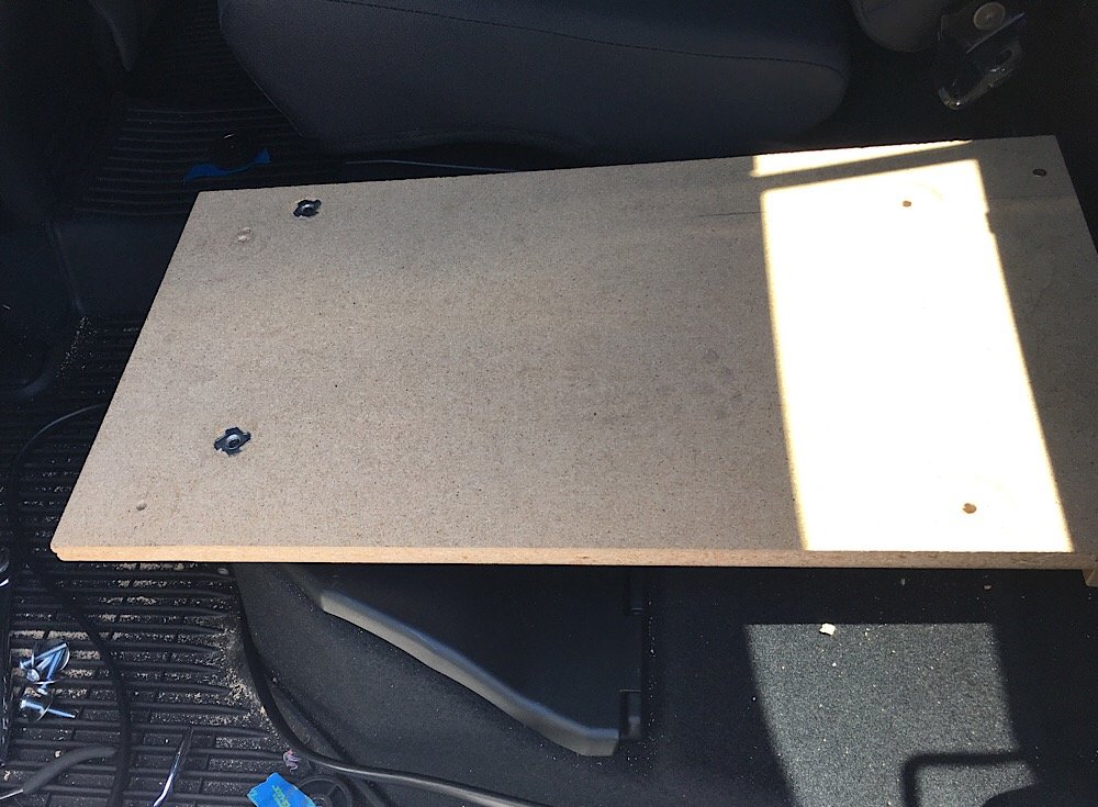

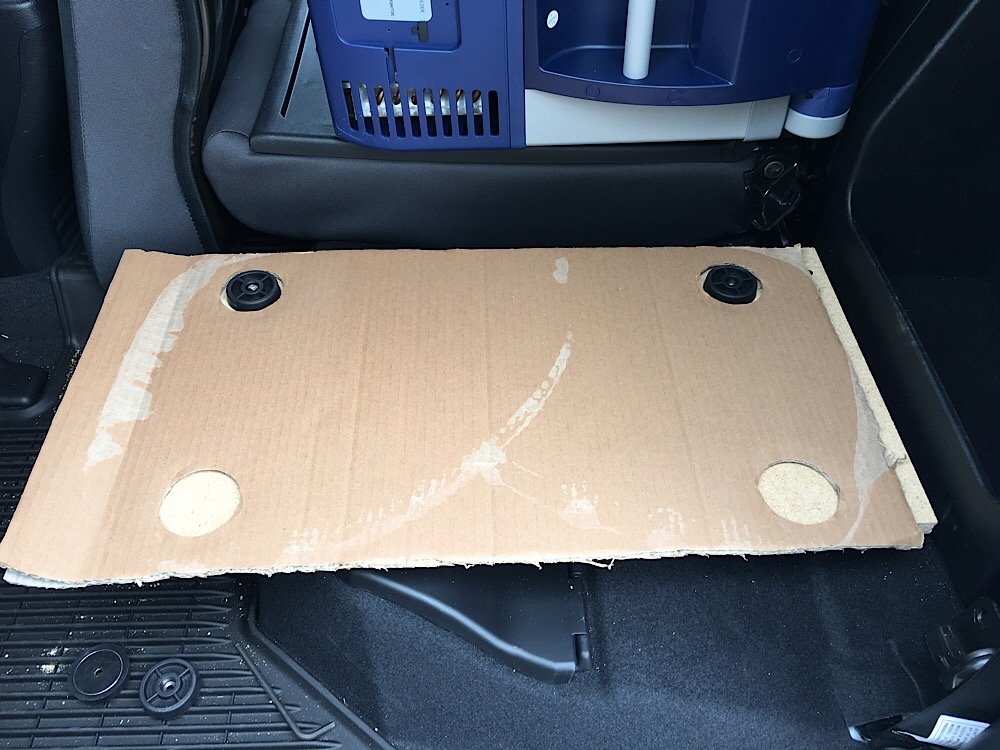

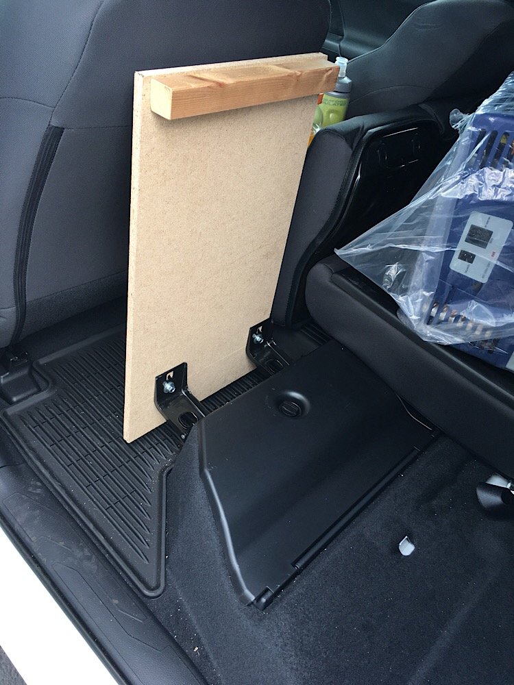

    My wife thought I was off my rocker the first time that I mentioned installing a fridge in the truck. However, the closer we get to our road trip, the more she welcomes the idea. In fact, she even pushed for me to get it installed before a smaller camping trip we have planned for this upcoming weekend. She now wants it as much as I do.
    For this install, I decided to do the work in the Lowe's parking lot. I figured, the sun is out so I can see what I'm doing and I'll likely need supplies mid-project, so why not? A handful of hours, a sunburn and several trips inside for misc supplies later and I now have this:

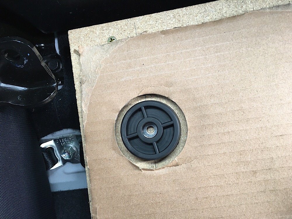

    To keep things simple, I decided to utilize the seat mounts for the platform. I went inside and got some scrap particle board cut to size, 13" wide (I'd have to measure again for the length). I also picked up a piece of 2 inch (ish) railing to use for my leveling piece (it was inexpensive and wasn't likely to have splinters).
    I had to mount it a bit offset so that the fridge wouldn't hit the bracket from the upper seat mount. The gap on this side is also good because there is a vent on the fridge at this location.
    Here's where I think I really got lucky. (or maybe I'm just that skilled!)
    When it came time to mount the holes for the fridge, I decided to use part of the fridge packaging as a template. I drilled a single hole for the inner front mount; I actually drilled this hole twice to get the correct placement in front of the seat mount. I measured and drew a guide line to make sure the next hole would be square. I then placed one of the rubber feet with a bolt through that first hole and laid the piece of cardboard packaging over it.
    I set the next rubber foot in the cardboard template and squared it up with my mark and marked the site for my next hole.
    I repeated this for each of the mounting holes. There was a lot of potential for error with this plan, so when I drilled the last 3 holes, I went up on my drill size just a little bit to give me some wiggle room. I'll be damned if it didn't work.
    To finish the mounting, I have ARB mounting straps incoming that I plan to run from the front and back handles to the seat mounts. I really only need this in the back where the platform is unsecured, but I will likely do the same in the front. I also plan to order some carpeting to make the shelf look finished in the near future, but it for now it just feels good to have this thing mounted.
    Next, the wiring...

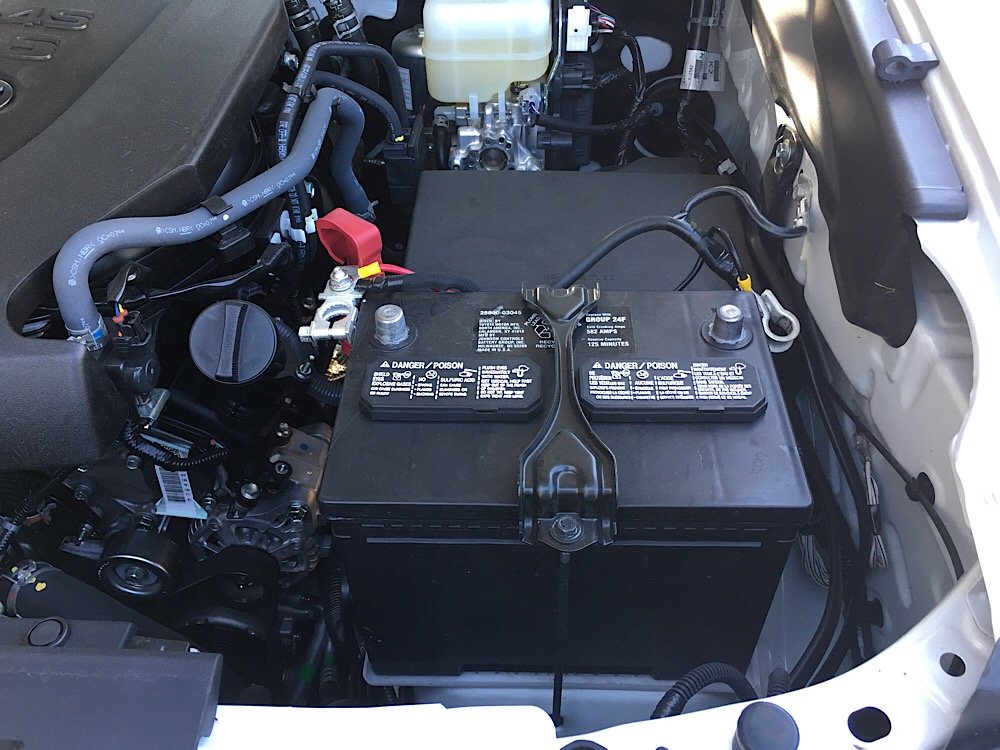

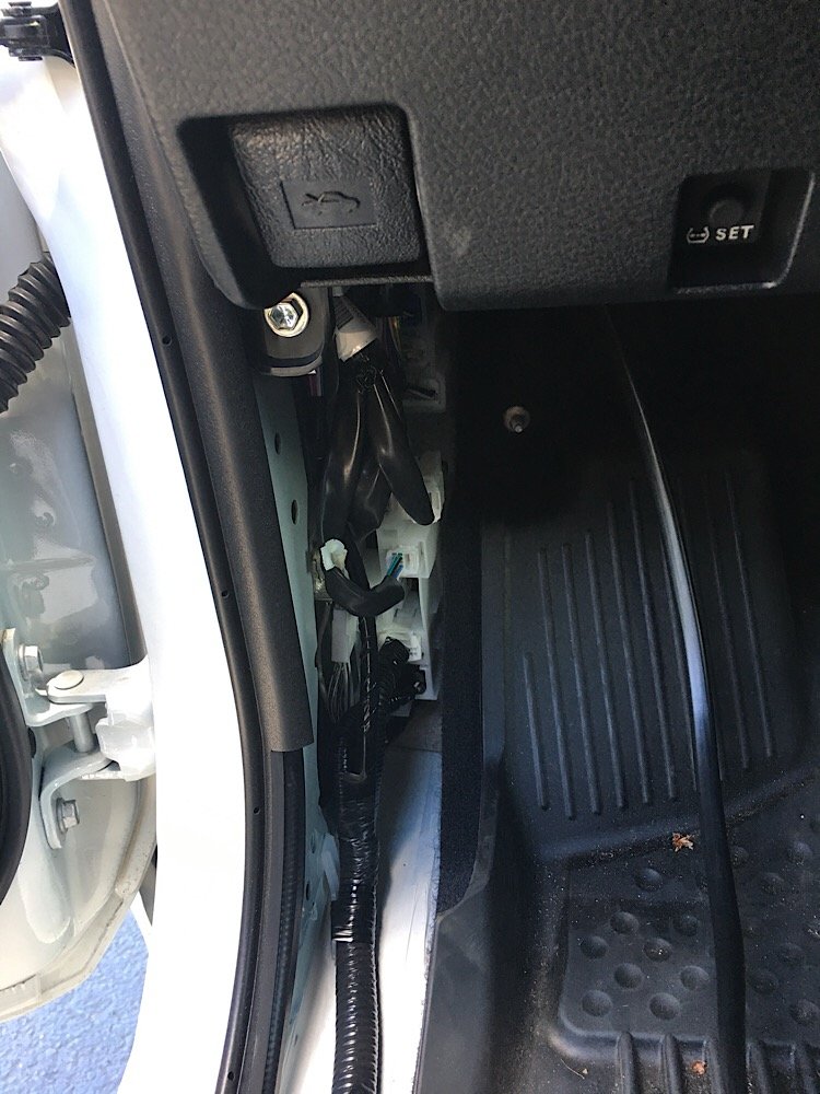

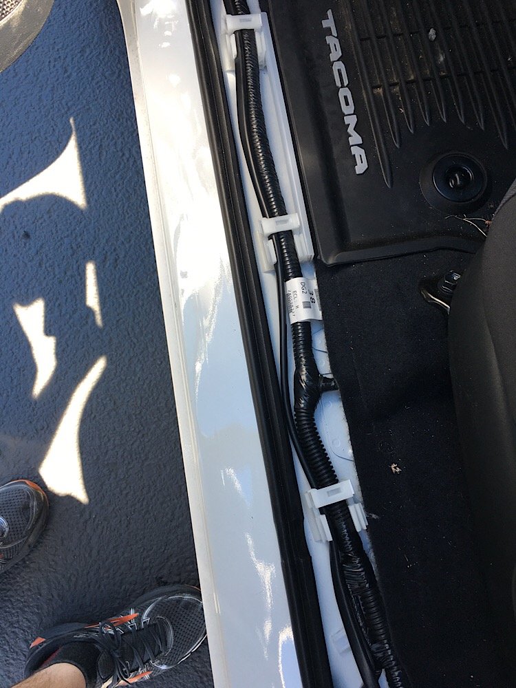

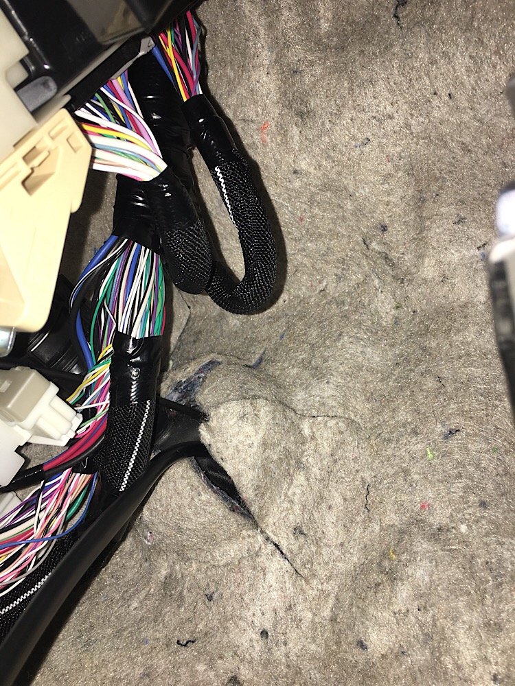

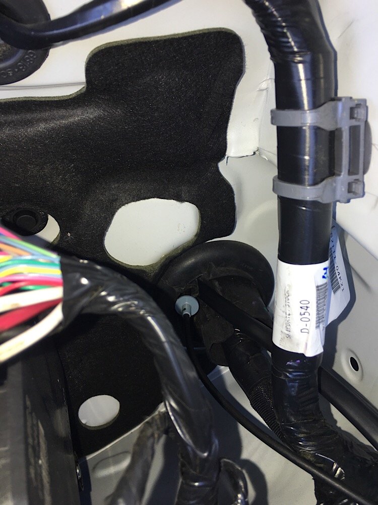

    Using the ARB wiring kit, I ran the cable through the firewall. I initially measured my length from the battery, but then re-measured from the passenger side to make sure I will have enough wire once I mount a secondary battery there.
    Here's a look at where I passed the wire through from the engine compartment side. I poked a hole through the surrounding boot with a screwdriver from the engine compartment side, then from inside the truck, pushed some needle nose pliers through the hole, then back outside the truck, I placed a zip tie around the end of the cable and placed the zip tie into the jaws of the pliers so that I could pull the wire through from inside the cab.
    From inside the cab...

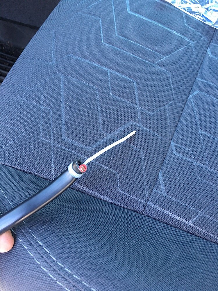

    The zip tie that made it all possible...
    I fed the wire behind the panel and underneath the trim all the way to the back.

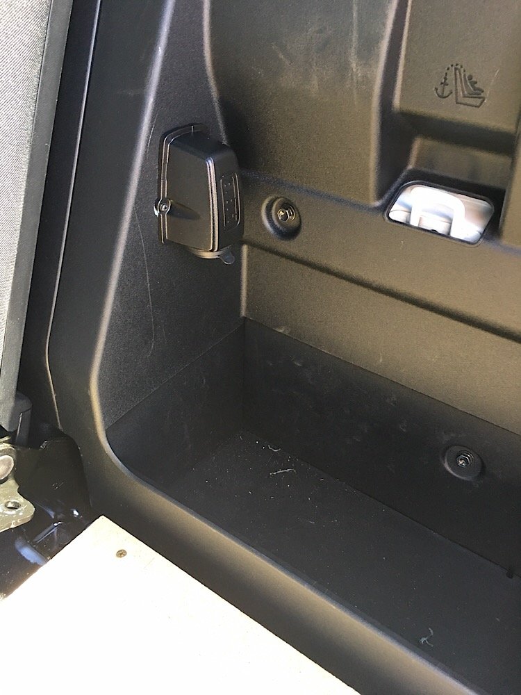

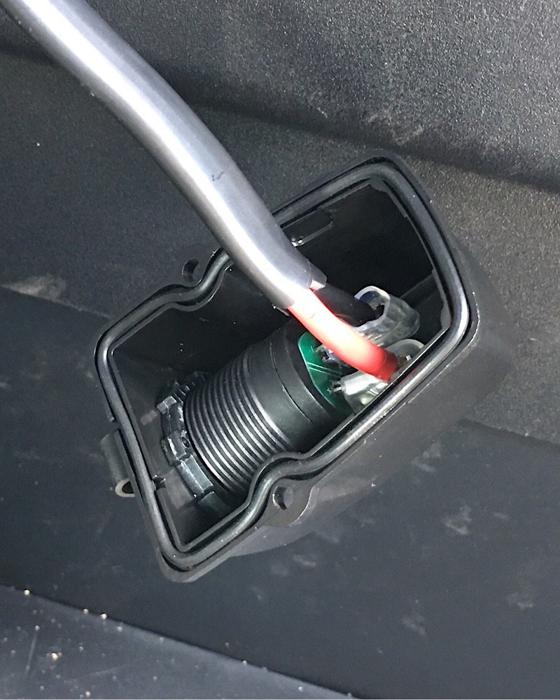

    After removing the three bolts, I pulled the rear seat panel out and ran the wire behind that and drilled holes for my plug in. After another run into Lowe's, this time to buy a soldering iron, I finished the connections and installed the jack.
    I chose this location because I may eventually move the fridge to the passenger side. Some of my plan has yet to be developed. I oriented the plugin this way because it is easy enough to reach and the plug will be somewhat protected should I choose to use the cubby for storage.
    I reinstalled all of the body panels, mounted the fridge again and hooked up the battery. But then before plugging the fridge into the newly assembled jack, I had a panic moment. Did I put the red wire to the + side of the jack..?! Crap.
    The good thing about taking photos while you work, aside from being able to post about it online, is that you can double check these things without having to fully disassemble your work.
    Whew!

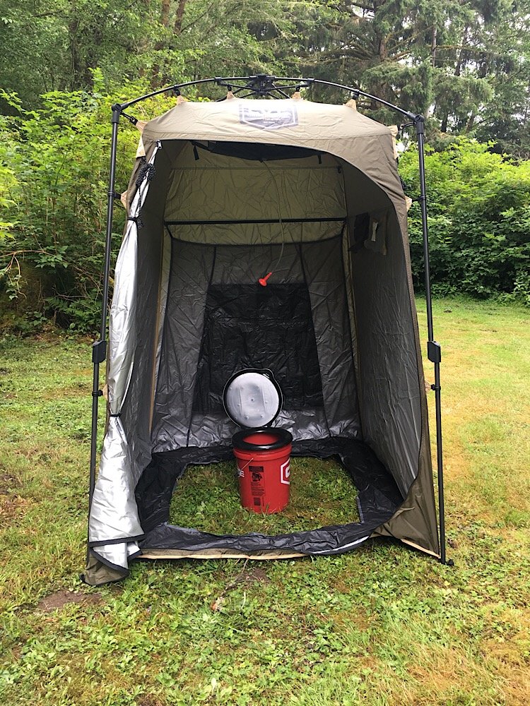

    We didn’t have to use the new Throne Room on this trip as there were facilities, but I wanted to set it up for the first time.

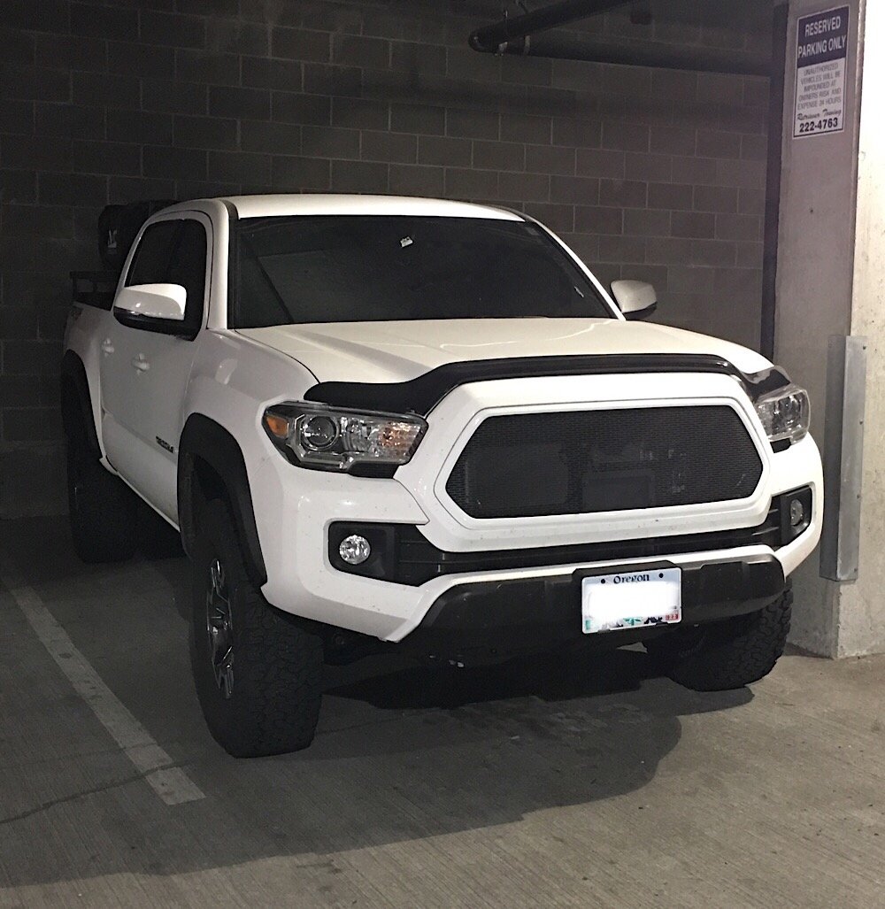

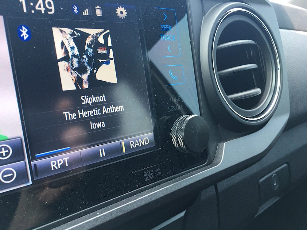

    I've added a couple of small items over the past couple of weeks.... Tacoweide Radio Knobs and I did the Subaru tweeter upgrade. I didn't take pictures, but will say that both of these small upgrades are worthwhile. I'm contemplating getting the kicker upgrades as well once I get a couple more things done.
    These knobs are a great touch for the Tacoma.
    Yesterday, however, was a big day for the Taco. I got the freshly released ECU update for the transmission related to TSB 00062-18. This is an upgrade that has made a big difference for me in liking my Toyota. Before the Taco felt like driving a passenger car with weak shift points and misc quirks. It now feels more like the engine has some power as a truck should. The engine feels stronger. Before IMO, the idea of OVTune was a must. It may still have great benefit, but honestly, this upgrade puts that lower on my list of needs.

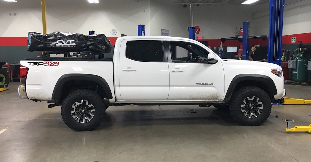

    After leaving the dealership, I went to 4wheelparts to get my Firestone Riderite air bags installed, plus some new rubber that was on sale - KO2's in 265/75/r16. The purpose of the airbags for me isn't lift, but to adjust for the sag due to the weight that I added to the back. I still need to address the suspension issue, but this will work for my upcoming road trip.
    I'm a bit high in the back in this pic and I've since made adjustments, but I am thrilled to no longer be sagging and to now have some travel in the rear suspension for daily driving.
    I got home to find that my bug shield had been delivered. I'm not sure that this is a full time accessory, but will be very necessary for my road trip later this month. I admit, I do like the way it looks.
    I've mentioned elsewhere in these forums that I've done some rethinking on the goals of this build (the word "some" there is a huge understatement). I've concluded that the direction that I want to work toward will culminate in the installation of a Swift by Four Wheel Campers. With this in mind, my suspension will ultimately get a pretty significant upgrade at some point in the future.
    The logical side of my brain tells me not to add too much to this truck that will just be removed later; this is much of what led me to adding the air bags instead of an AAL. However, seeing the pic above, I have really taken a liking to the way that higher stance in the back looks. It looks right. I may end up with another change to my suspension here shortly - despite what my logical brain says.

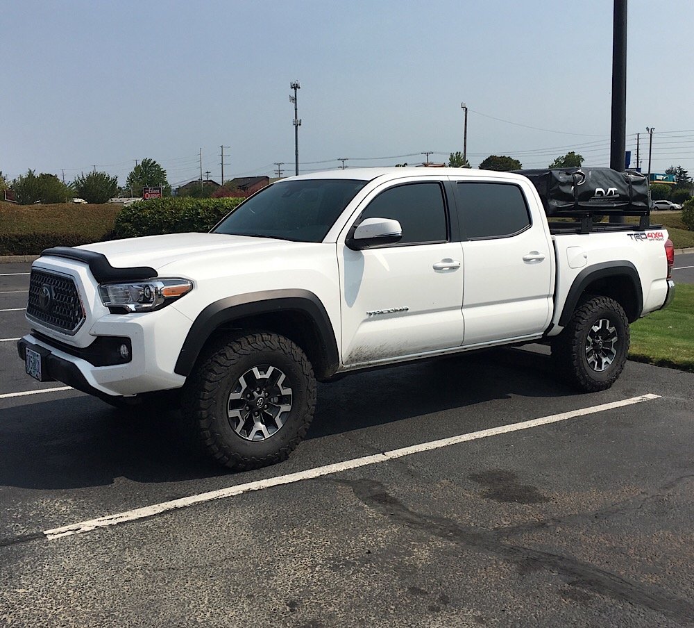

    This past week, I got my glass tinted with XCel nano ceramic film. I went with 20% in the front and 50% in the back and it matches almost perfectly. The nano ceramic cuts down a lot on the heat and, just as important, you cannot see any belongings in the back seats (like the fridge) from the outside even on a sunny day. The darker vision will take a little bit to get used to. I may have actually been a tiny bit happier with a smidge lighter, but I'm very pleased with this.
    A few more smaller items:

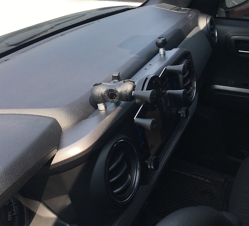

    I installed a Dashtop Multi Mount available from The Taco Garage for a rock solid RAM phone mount. I have a RAM mount for my wife's iPad Pro on its way so that my wife can watch movies while on the road if she wants.
    I finally picked up a Gentex rear view mirror with Homelink to control my apartment complex's gate opener. It works perfectly. This opens up my left hand cubby for my brake controller.

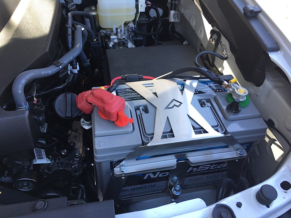

    I also solved my battery upgrade conundrum. Instead of a dual battery system, I installed a Pelfreybilt battery mount and Northstar group 31 battery for more power for my fridge. I can't say enough about the customer service at Pelfreybilt. They are great folks who stand behind their product. :thumbsup:
    Old battery:
    New Battery:
    **Interesting story about this battery install...I picked up my battery on a 95F degree day. In order to turn in my core, I made the swap right away. I pulled into a spot of shade to do the work in an empty parking lot of an office building complex. I get my old battery and the battery mount out in under 5 minutes and I hear someone banging on the window inside the office. I can't see through the glass so I keep working. A few minutes later, some old guy walks up and says hi, I say hi and introduce myself. He turns around and while walking away says "I'm going to tell Sam that you are parked in my parking spaces." I shrugged and finished my swap in another 10 minutes. I have to admit, I've never had someone threaten to tell their imaginary thug on me before. The parking lot was literally empty. Anyhoo...

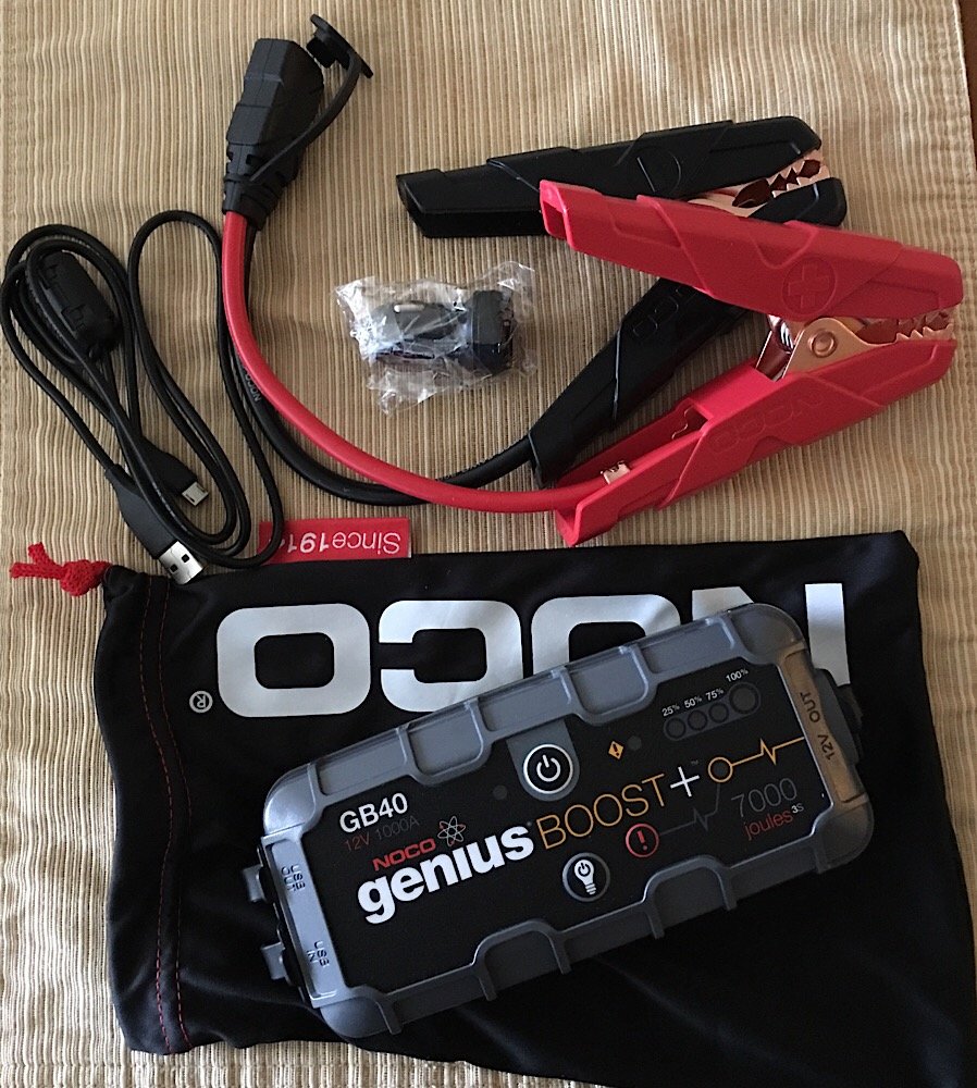

    Instead of installing a second battery, I picked up a NOCO Genius Boost Plus Lithium Jump Starter for those rare times that I've let my battery consumption get out of hand. This lithium jump starter is good for up to 20 jump starts and is small enough to stow away behind the back seat. Being lithium, it should keep its charge for a very long time. I do like that peace of mind.
    I also upgraded our shower system to a 3.8 gallon Waterport water tank. This tank can be pressurized either by garden hose during filling or with a bicycle pump. For travel, I really like that it can be securely mounted to the rear hitch.

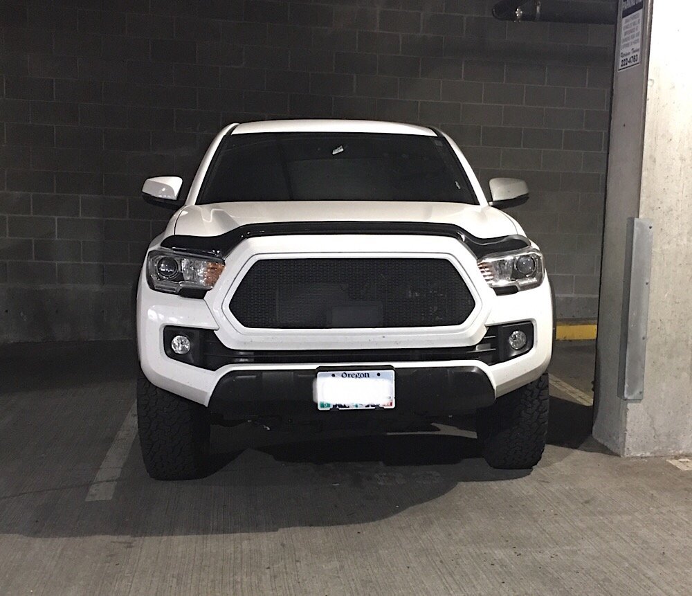

    A new smile... :D
