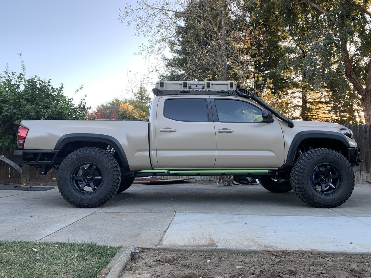

    MESO
    MESO [OP] Major Modder Vendor
    Feb 16, 2015
    #148809
    16,292
    State of Jefferson
    2016 DCLB TRD HELLCAT SWAP

    18’s to clear your new brakes?
  12. Oct 29, 2019 at 10:40 AM
    #232
    MESO
    Feb 16, 2015
    #148809
    16,292
    State of Jefferson
    Yes. And that’s the only size the Volks are available in

    what is the actual diameter of your 37s?
    just curious because your 35s were 33.5.
    my 33s are 32.8
  17. Oct 30, 2019 at 12:30 PM
    #237
    MESO
    Feb 16, 2015
    #148809
    16,292
    State of Jefferson
    My 37's are 35.5" actual. This is the reason I went with BFG because I knew they run small. If they were actual 37" I'd be cutting A LOT more.
