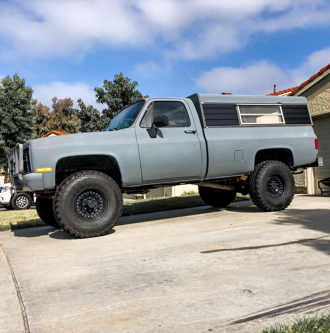

    @MESO, in your first post you mentioned the KM3s are about 35.5" tall. Do you happen to know of a few other measurements for other tires that are a little taller than that? I have 315/75r16 KM3s now and you're right; they seem to run small. I love the tire but when moving to 37s, idk if I want to feel like I'm hardly on 37s.
    My other truck has BFG Baja military HMMWV tires on it. 37x12.5r16.5 -- they have that tall, skinny appearance. I need to measure their actual height on the truck (will update you when I do), but I'd prefer to get closer to these tires, assuming they aren't also 35.5". I'm willing and prepared to hack my truck as much as needed. And I'm prepared to break stuff as a result of being an idiot and choosing to run tires this heavy, lol.
