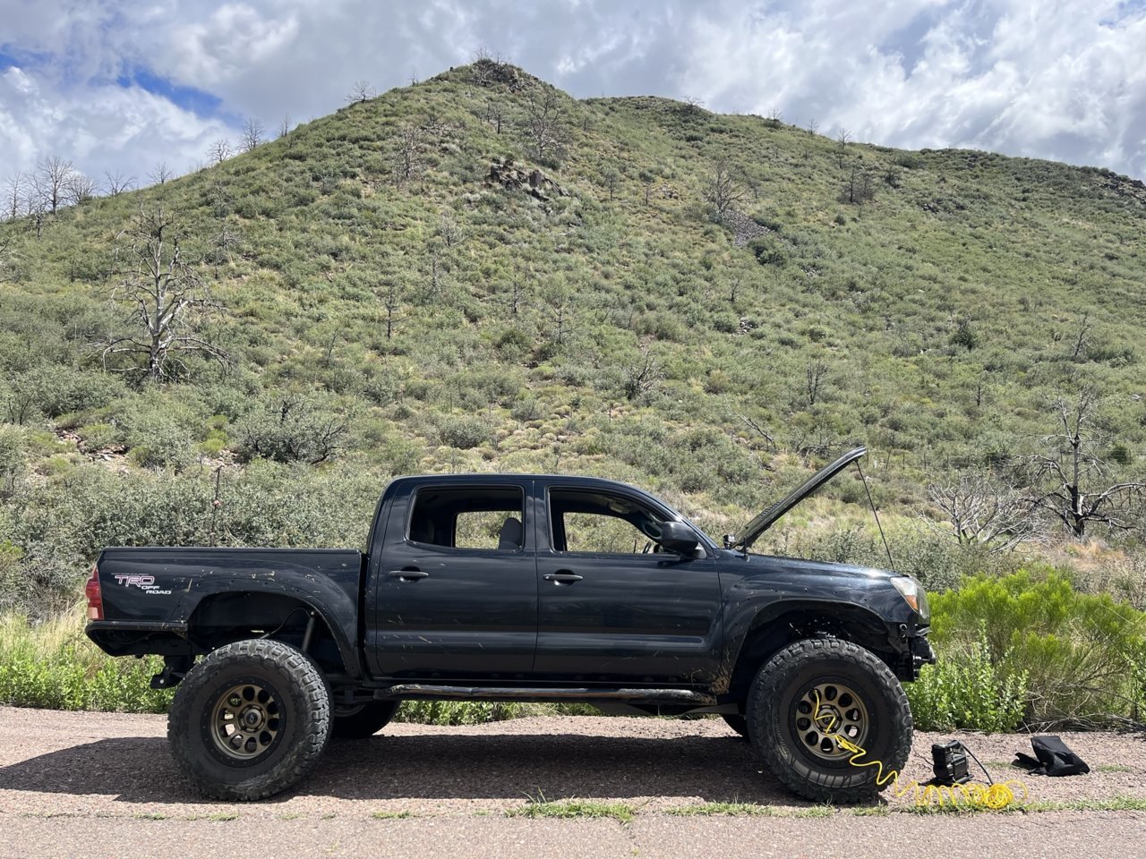

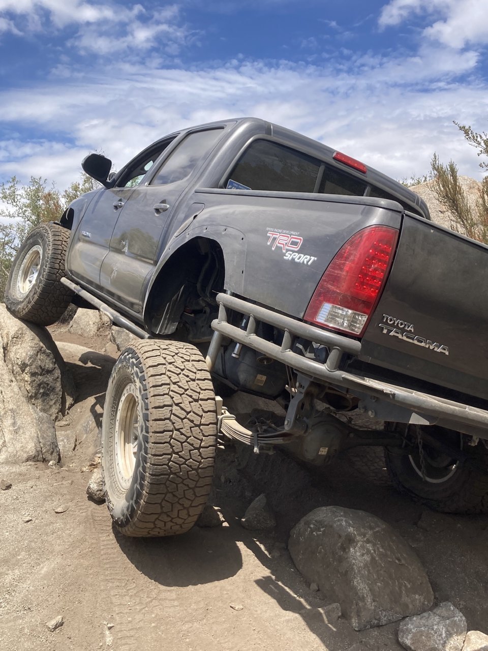

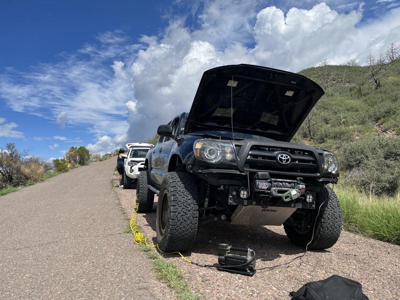

    Since I just had a 3rd child and have a hard time justifying keeping this set of 5 matching 37’s on 5 beadlocks -
    I’d like to trade for someone with 35’s.
    Let me know what y’all got out there. I’m in Phoenix AZ. Unfortunately this has been too much of a Dad-mobile lately for me to justify keeping the setup as is.

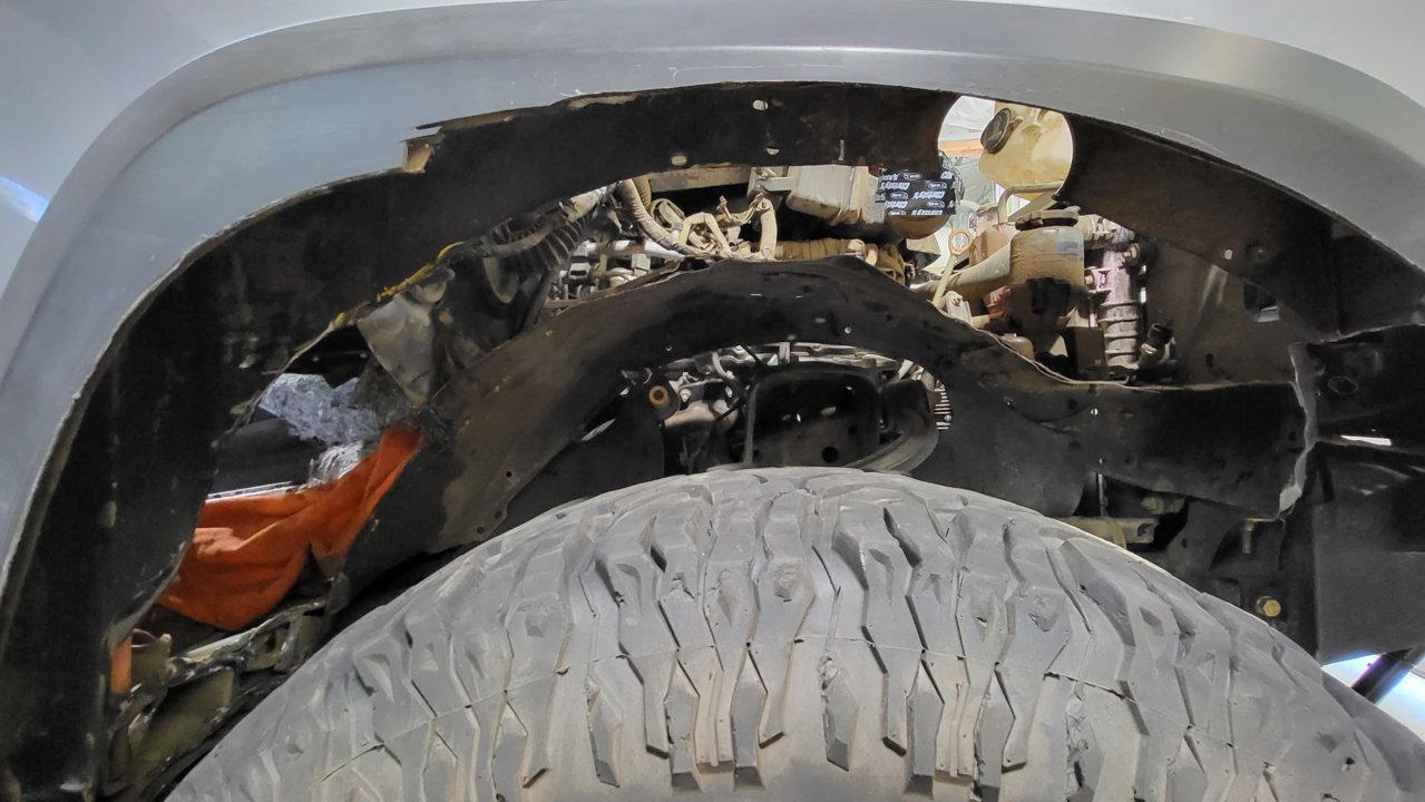

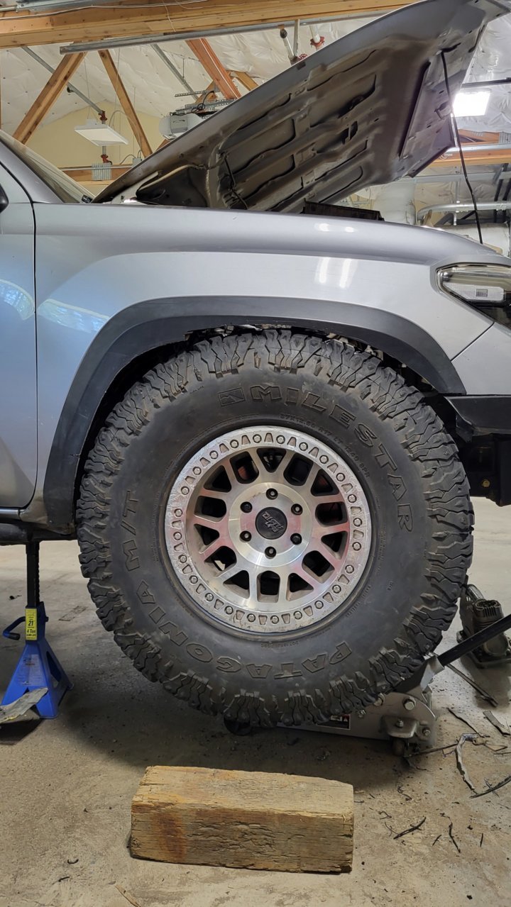

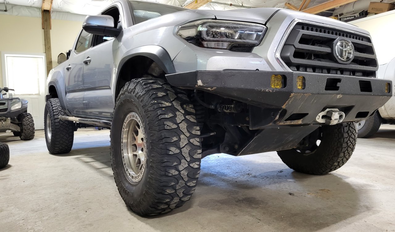

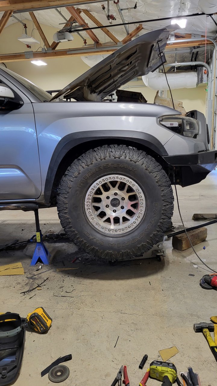

    1st photo, mechanical bind bump
    2nd, full bump (as much as the superbumps would compress without the whole weight of the truck jumping on them). Left some good room everywhere to account for frame flex/body mount travel.
    Mid tub, need to shift the body mount back like an inch sometime.
    Ride height.
    Still need to do the drivers side, and order up some new 37s and duals

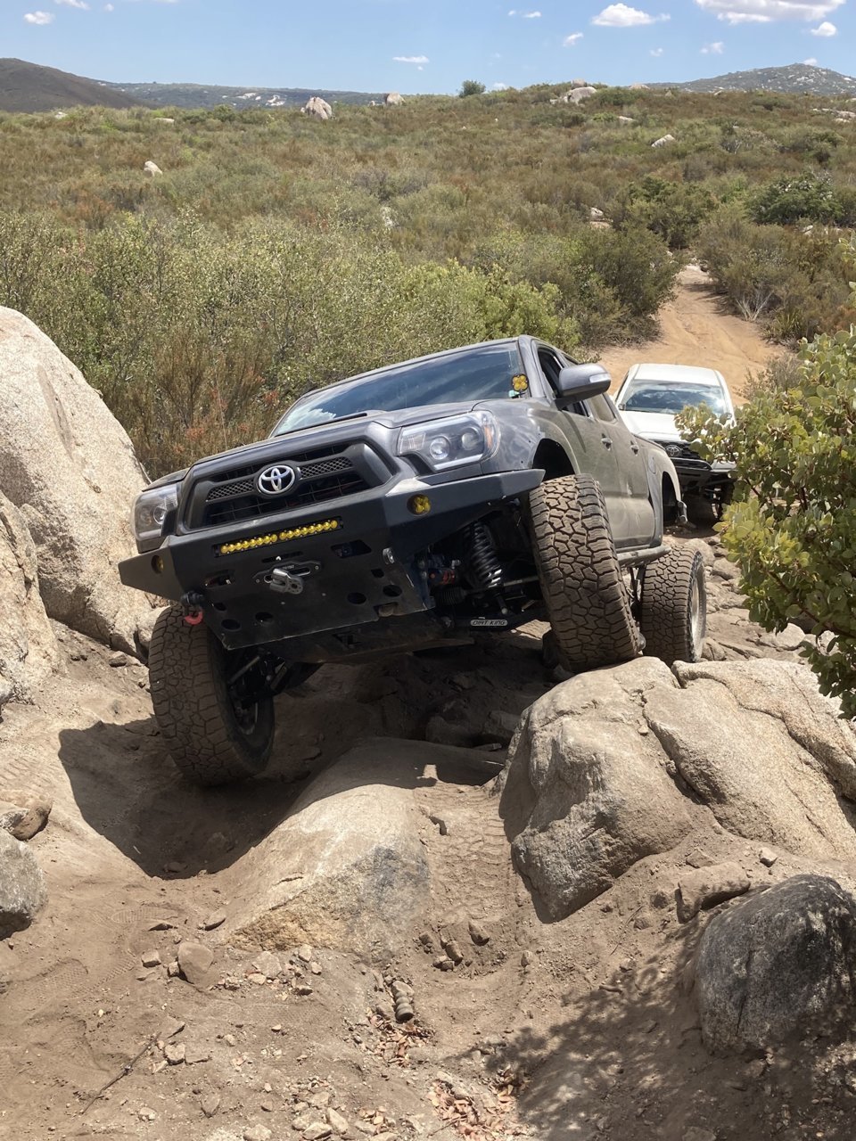

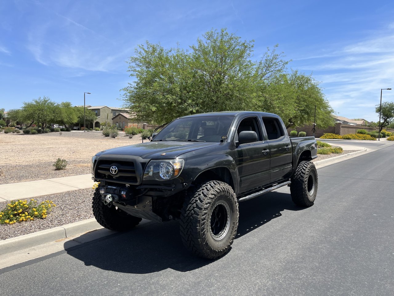

    Well I’ve read through all 28 pages off this post and still can’t find what I need. So I will slowly add to this my journey I am about to embark.
    It looks like myself and @singletrack_ftw will be swapping wheels and tires.
    Currently I’m on a Dirtking LT kit on dirtylife Beadlocks with 315’s. I’m on a -12 offset, and have no rubbing unless full bump when i jump the truck.
    due to the rear suspension set up I know I’ll clear and with the 37’s only being 12.5’s i don’t think I’ll rub the rear anymore than I do now.
    I’m trying to figure out how much I’m going to have to do up front.
    I’m already having terrible steering issues in the rocks, so I’m going to have to address that problem.
    the rack has never been my issue, mine has been the pump. I’m getting a PSC Chevy pump which should fix that issue.
    axleshafts im not worried about because those are already upgraded, and I’ve never broke or bent tie rods.
    Pick decent lines i guess ‍♂️
    I’m curious though, going from a -12 to a -38 what issues I’m gonna run into besides being wide as hell
    this is where I’m at now

    Hey there Matt. The obvious answer to your question is the project of tubbing the inner fenders/firewall. This project I personally intended to undertake but life happens & I just don’t see myself getting it done. Removing your coilovers and bumps and cycling the wheel/tire at full bump travel and cutting away all that touches and rebuilding is what you’ll need. A really nice addition to your psc pump would be the jd fab slide rack. Seems like a no brainer with how you use your truck and your LT.

    All of what you want to accomplish is totally doable & in another state of life I would love to do it myself. Don’t have 3 kids and try to build a rock crawler/DD :rofl:

    I would also look into the JD Fab Howe PS upgrade kit. You can get it with or w/o an external cooler. Super stoked with mine so far and very straight forward install

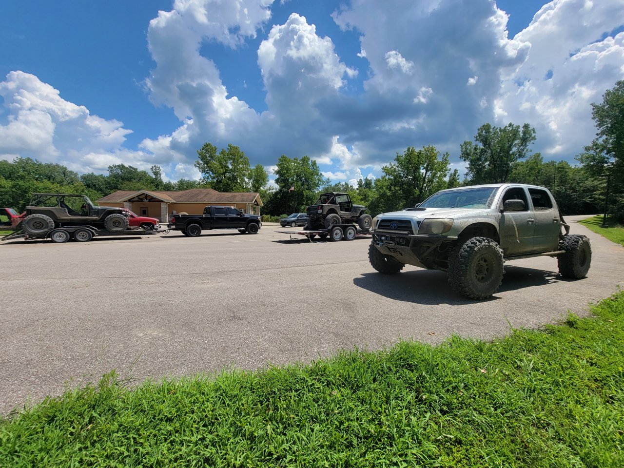

    Well 37s have finally killed my 3rd Detroit locker... thinking it's time for a spool.

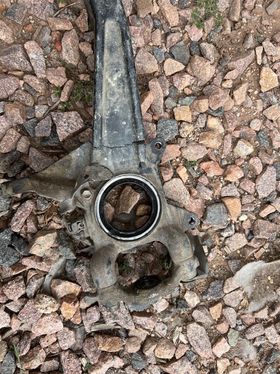

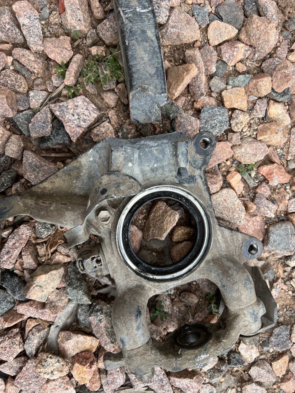

    X-Posted for more suggestions:
    So I think going to 37's contributed to my spindle breaking (full crack). Looking to upgrade a couple things to handle the trails I run. I plan to get my new spindles gusseted, and move onto the Tundra steering rack. Question for the group though. Are upgraded LCA a measurable increase over stock? I know UCA's are but if I can save $1000 by sticking with OEM, and being in the clear I'd prefer to do that.

    Are they breaking when something else goes? Sounds excessive.

    No. All three have failed due to the Allen bolts in the locker either shearing or backing out which caused the carrier to crack down thr middle. It was a surprise on the first one so on the second I used lock tight and it lasted a little longer. The third one I even tore apart at 15k miles to check all the bolts.

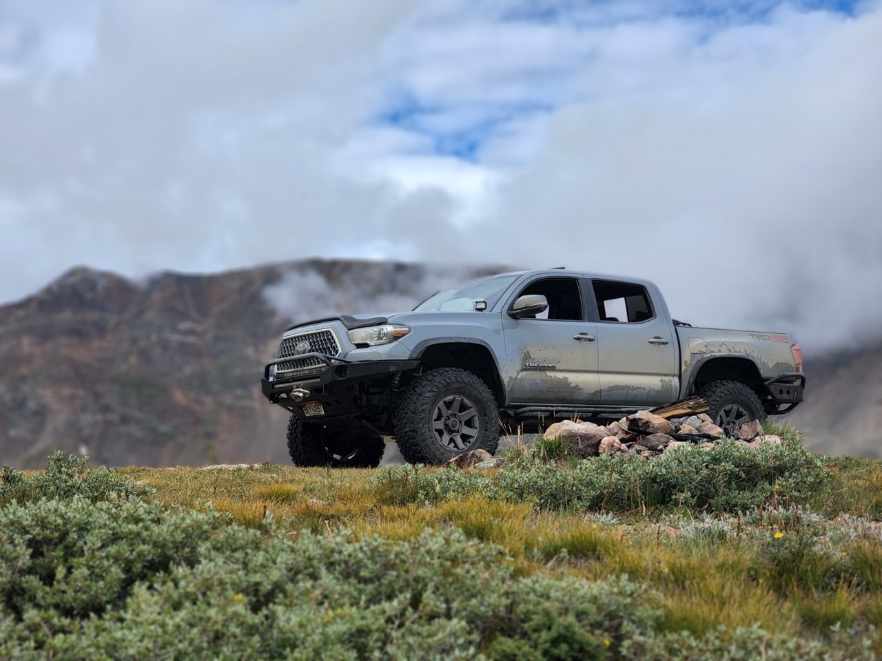

    37s make life grand

    They kind of make the front end of the 3rd gen palatable. Kind of :)

    Can I ask how you got that much caster?
