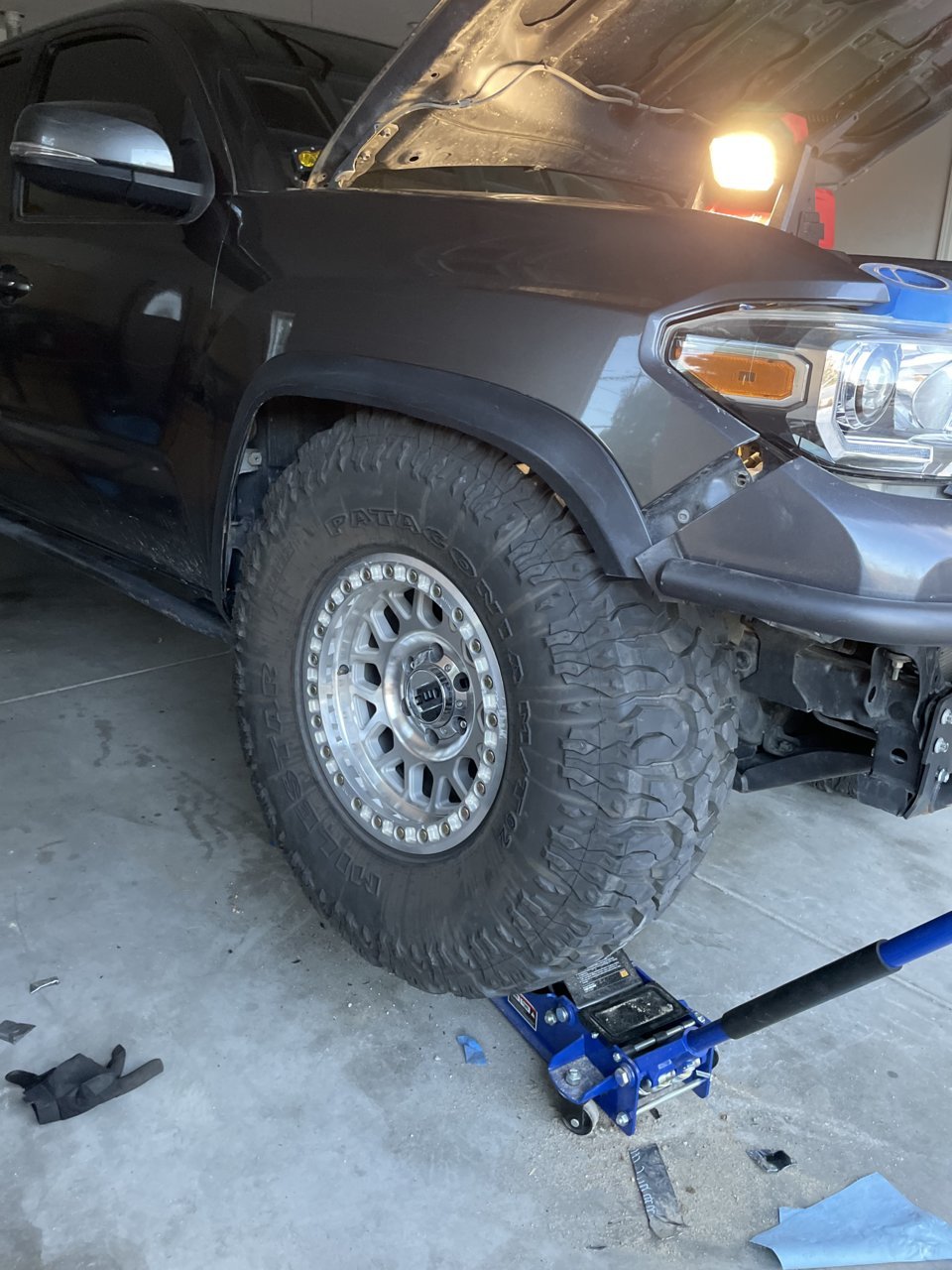

    7. Enjoy being able to steer
  2. Apr 1, 2023 at 3:44 PM
    #562
    erok81
    erok81 Well-Known Member
    Aug 15, 2016
    #194699
    5,708

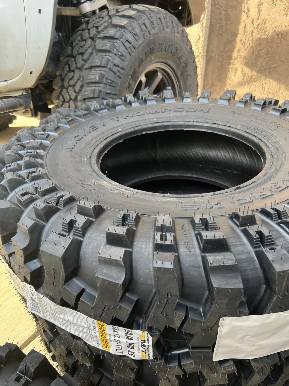

    Do I get to stay in the group once I get these mounted?!?
    Also waiting on new leaf springs from Alcan. But need to sell my DIY deck storage, so I can get a proper vehicle weight.

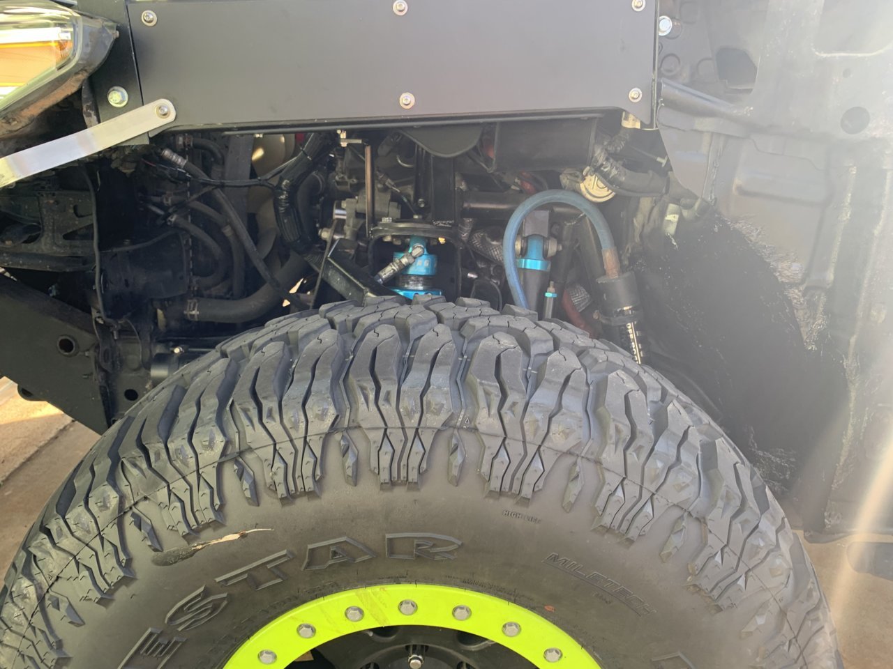

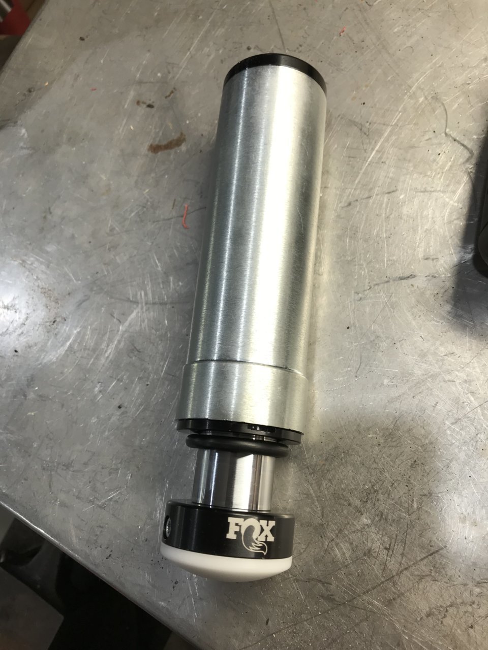

    Yes, it’s not hard as they are emulsion and you can remove air/oil via the schrader to get them apart. Assembly can be a little more challenging but it’s doable. I purge the air out multiple times as air gets trapped during assembly and can make it a PITA.
    You also have to adjust your oil volume to make sure you don’t hydro lock the bump. Best to fully compress once assembled (without a charge obviously) and make sure you can fully stroke. You’ll get a harsh bottom out before full compression if you’ve got too much oil.

    Yours are this fancy IFP ones though yeah? Not sure if that matters. I did cycle them though since I had zero idea how much oil to put back in.
    On mine if I press down the seal body enough to to get to the snap ring I’ve got less than 1/2” to work with between the body and the bump head (or whatever it’s called). I could try taking that off which would make it easier but I couldn’t get it off. Hopefully they don’t ever leak.

    The ones I posted were stranded bumps for the prerunner I’m building.

    I’ve never pulled apart foxes but do they come apart like a shock where you screw off the cap on the bump pad side, press in the seal body, then expose the snap ring? That’s how my kings are. Leaving the bump pad on I could barely get the snap ring in because there is zero room between the body and bump pad. But if that can come off it’ll be easy. Mine wouldn’t budge so I had to do it with it on.
