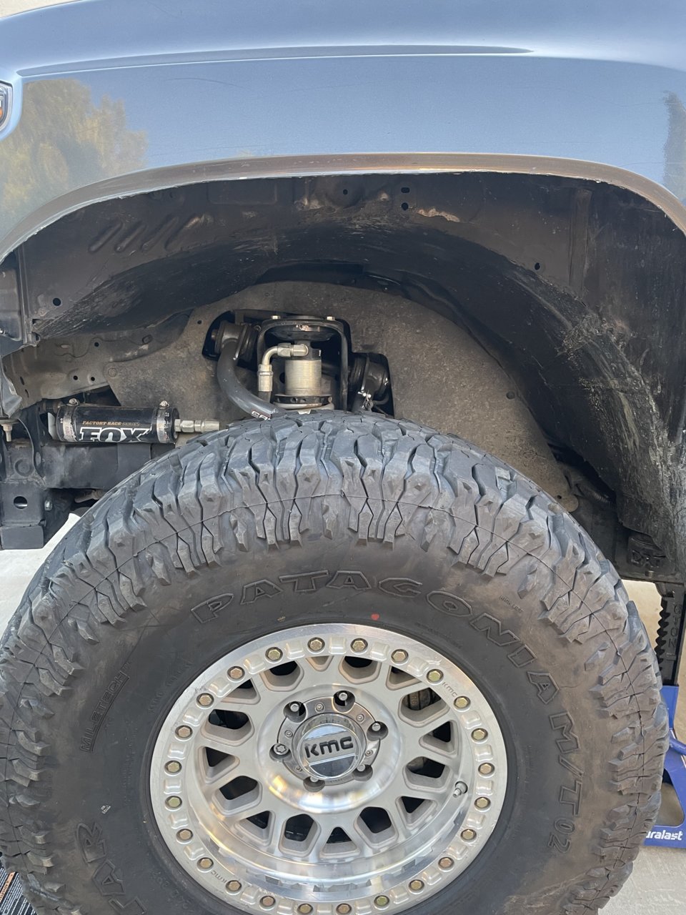

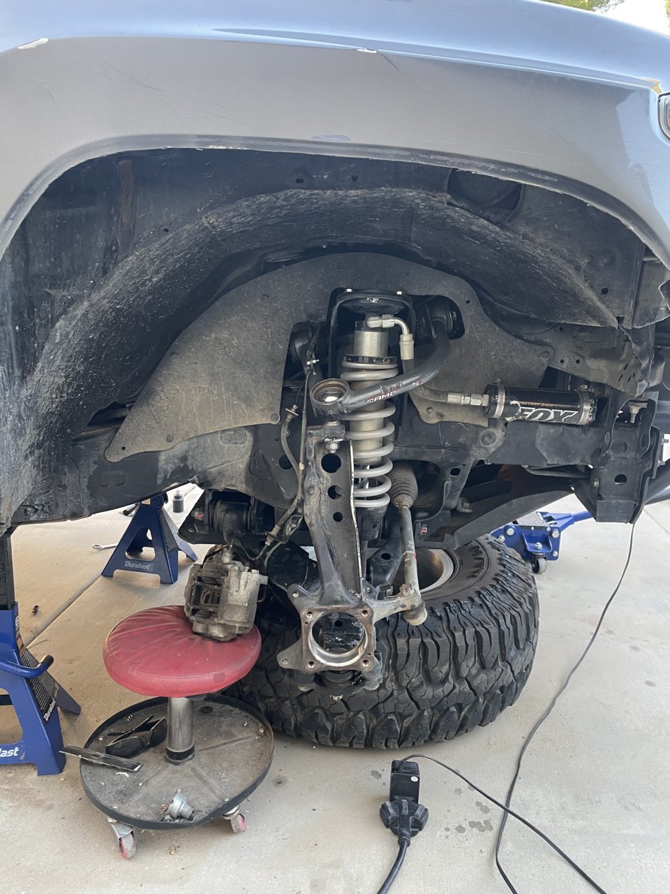

    some pics to show the finished tub. i also really like these milestar MT 2s

    what material and where did you get it from? best home made inner fenders i've seen

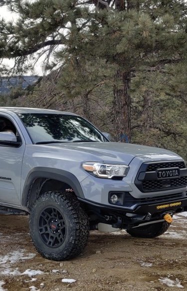

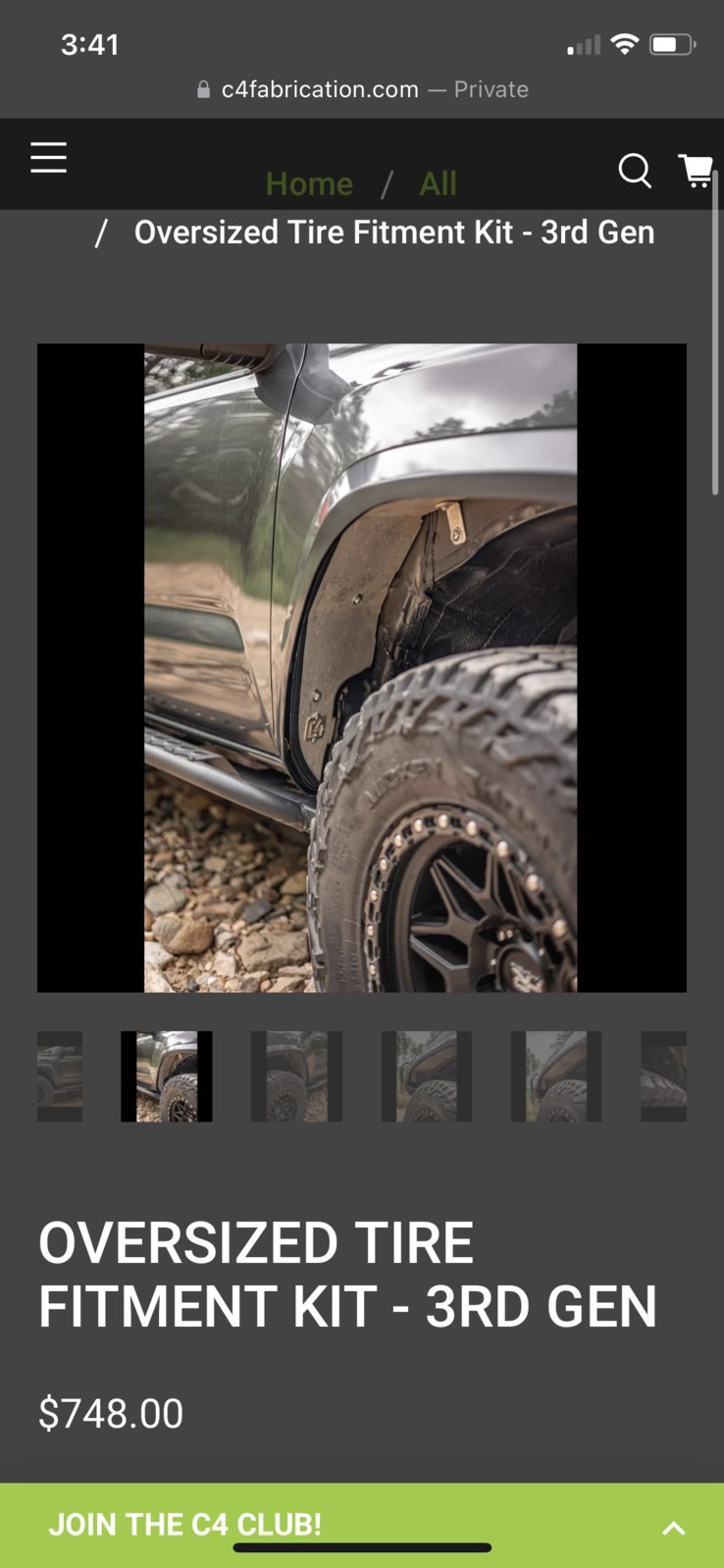

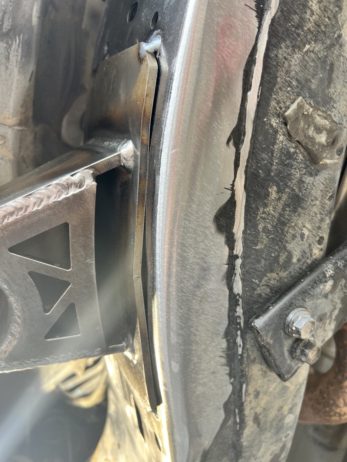

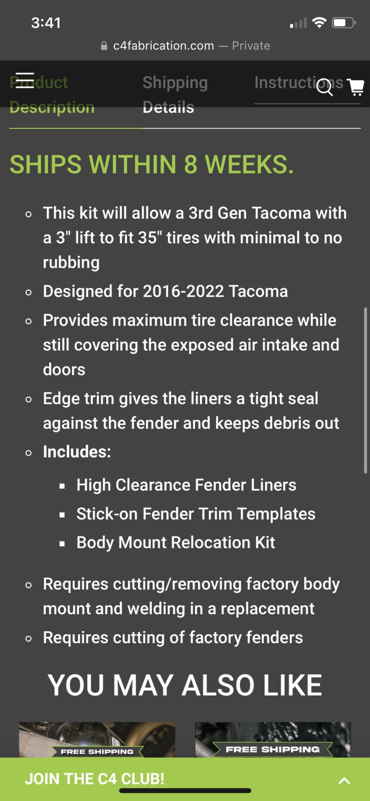

    these are some nice looking trucks, this is the party i wanna join. info is a little mixed. so i’m on 34s right now with a cmc with a couple inches of lift, but would like to run 37s (or at least true 35s). i would like to not touch the firewall. Considering I don’t do extreme rock crawling like i see in some of these pics, but just your average trail off-roading & camping at the moment at least.
    I’m soon going to have an after market SSO bumper installed (as seen in pic), & looking to get the C4 oversized tire kit installed at a fab shop that’ll do it, which requires cutting a few inches of fender & relocating the body mount (as seen in pic). so i’m searching for knowledge/advice. is the few inches of fender cutting & body mount relocation, along with the trimming of the front plastics from the bumper install, as well as getting some uca to push the tire forward going to be enough to clear 36.5s or a true 35?

    @Stricklytoyz so you’re thinking i can only safely get away with a 315/70r17 or 35x12.5 with these mods while still having full functionality?

    I've heard some not so good things about the c4 fenders. One, being that the fitment is bad. Two, is that it doesn't fit perfect, so there's small gaps and it traps debre.
    That is what I heard, I don't own a pair ^^
    I run no liners, engine bay isn't the cleanest but i have no issues

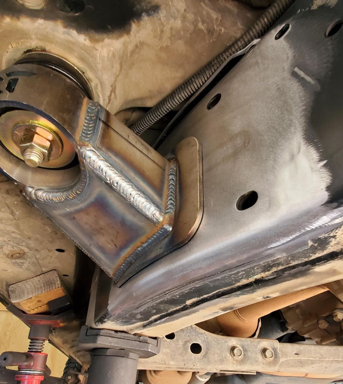

    came across that but only in regard to the c4 cmr and it’s fitment, (could be biased as it was from a dirt king rep.) but i haven’t seen enough of them mounted. i saw a video of the fender liners & it did look like a snug fit, but i’ll just have to trust the shop to just make those happen. heres a c4 relocation compared to a dirt king relocation. but by all means c4 does sell the liners alone instead of the whole bundle i showed, and the dirt king cmr can be purchased alone too to make my own combo instead of the $748 c4 bundle.
