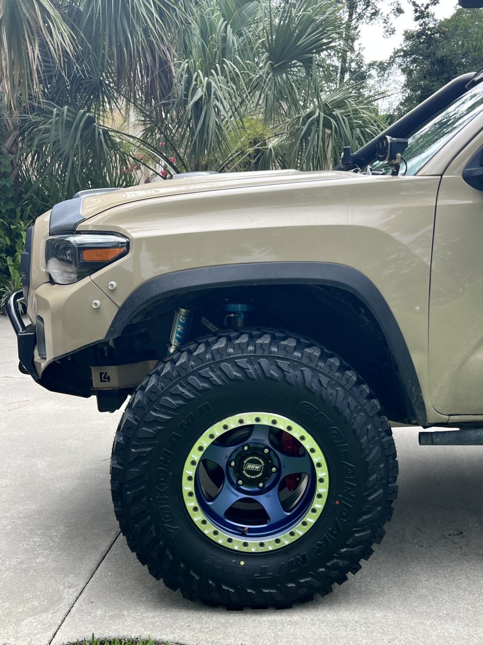

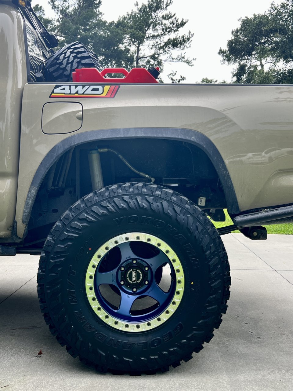

    Same, as soon as I threw the 37s on.

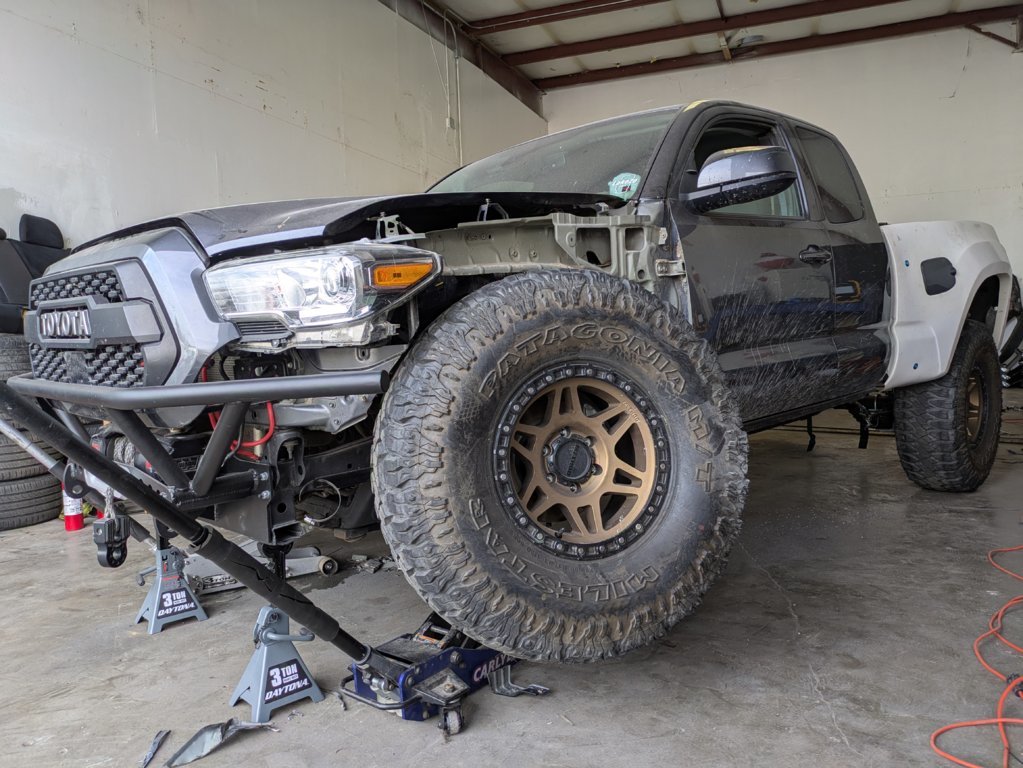

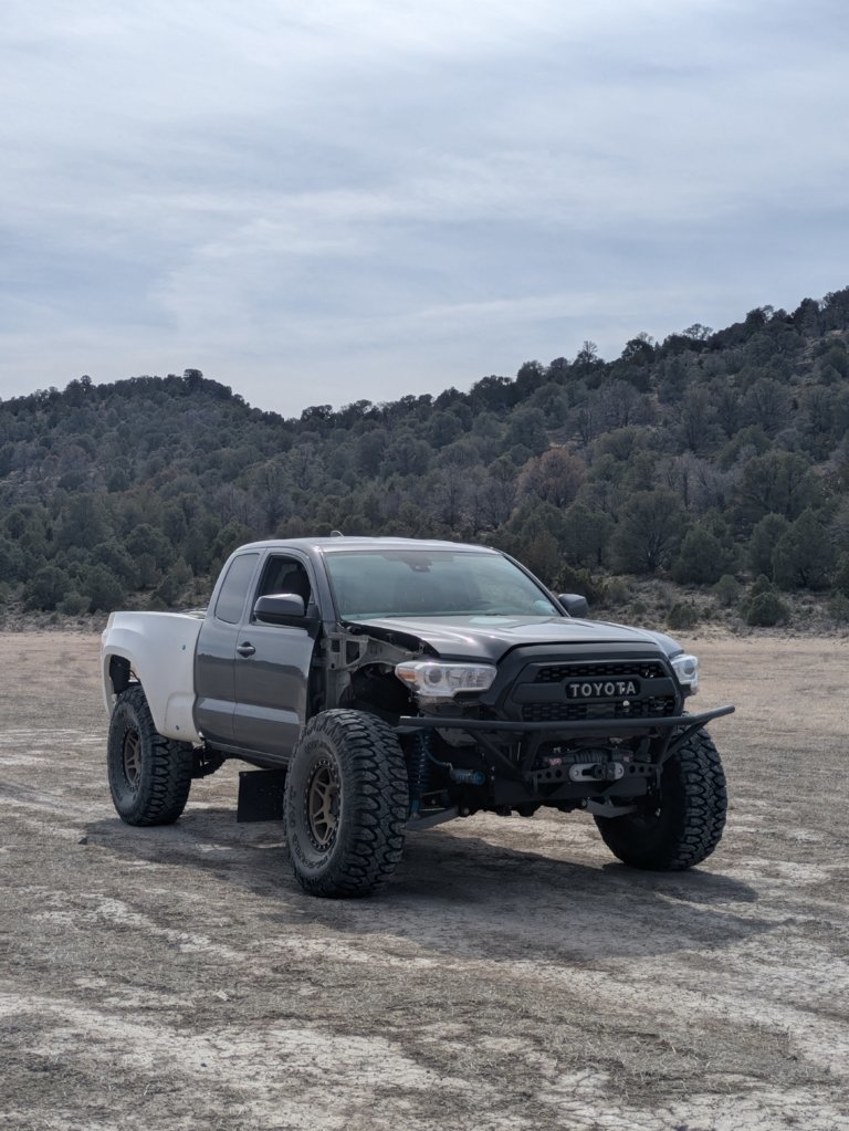

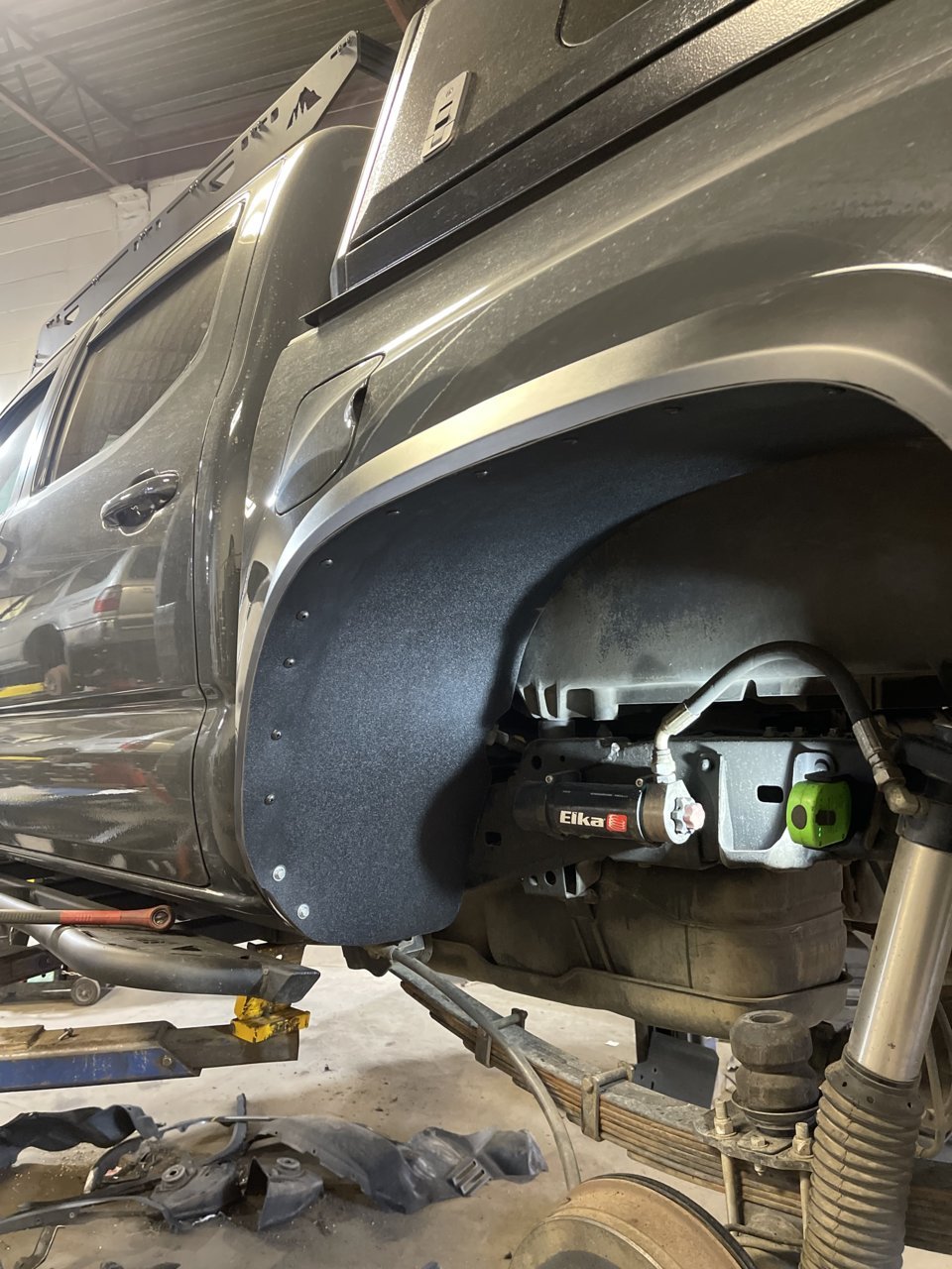

    Make those or buy them? Those look sharp! Thats the main reason I haven't cut my rear fenders yet.

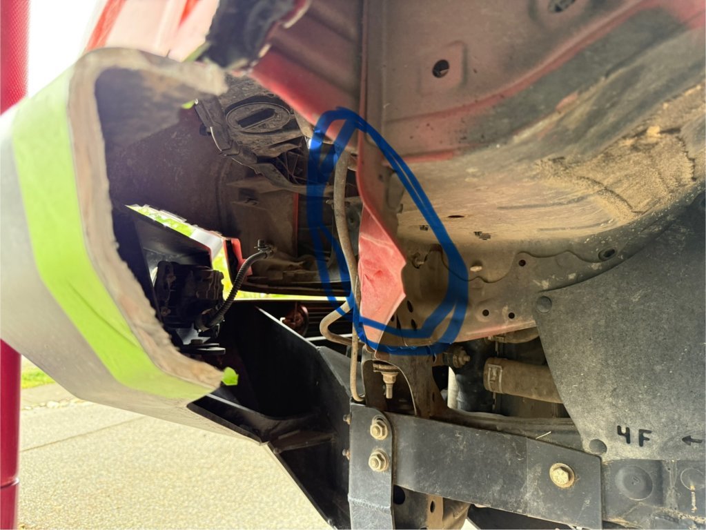

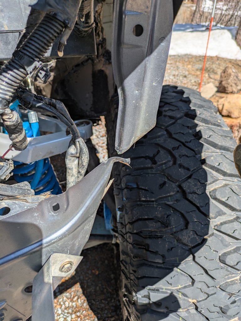

    Are you guys doing anything for the torn/broken radiator supports?

    Mine are both crumbled and torn. They are bent up into the fender.

    My inner fenders are slightly trimmed but cracked where it meets the core support.

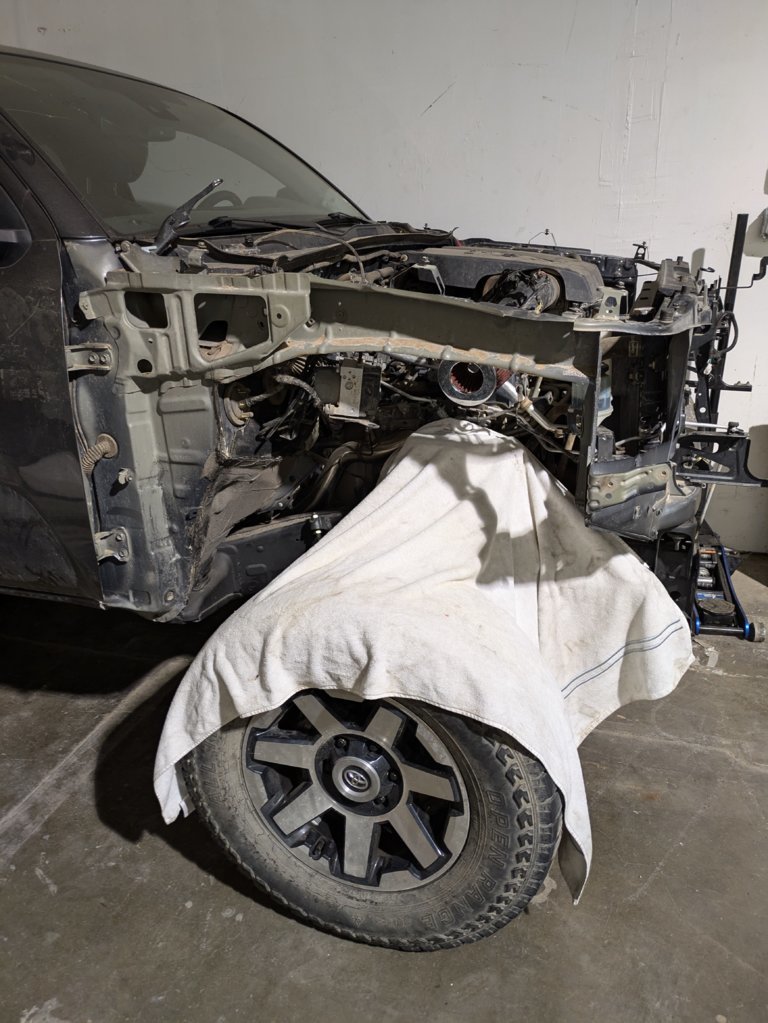

    How much of this piece did you guys all cut off while still keeping it structurally sound?

    I trimmed as much as I could and it cracked first off-road trip.
    Now my core support is fully cracked off from the rest of the truck

    Maybe about 1/2 way done cutting on one side. Looks I’ll need to undercut a lot of the battery tray. Anyone relocate their battery to the other side of the engine bay or to the bed?
