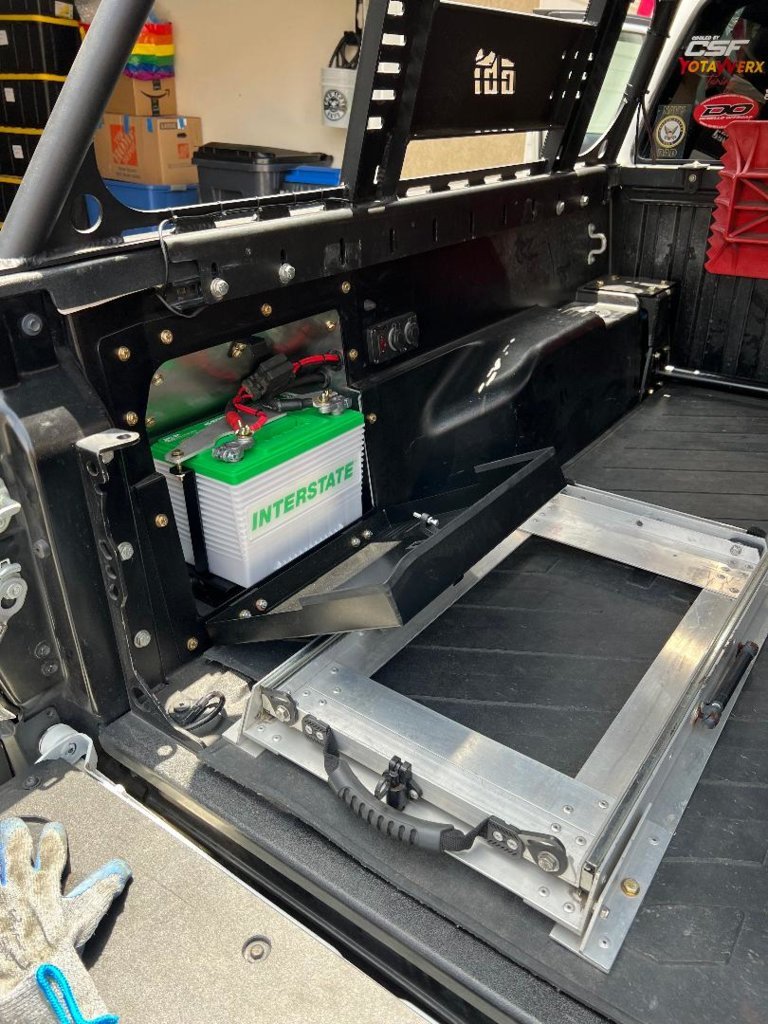

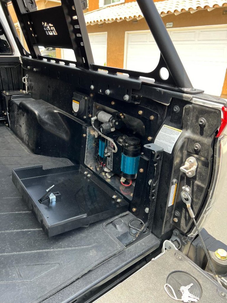

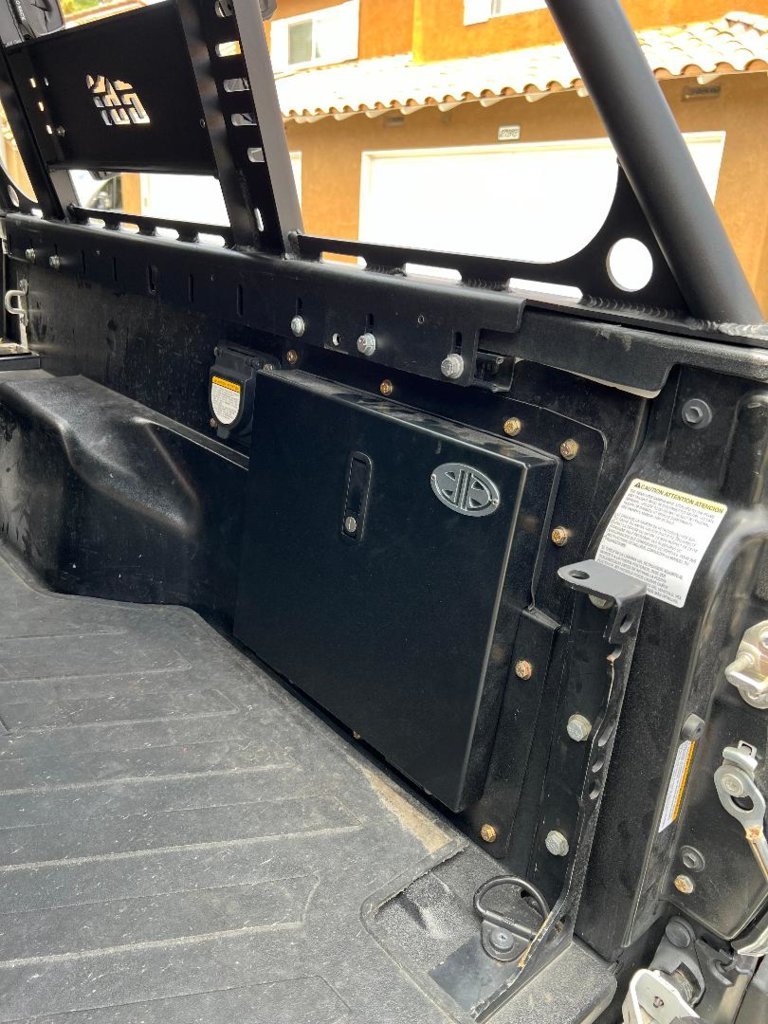

    JD fab makes some great bed boxes for battery relocate and compressor. I have one for each.

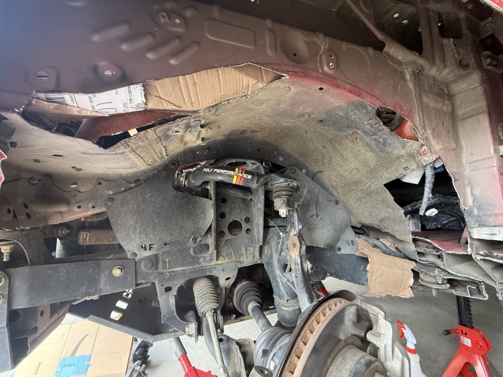

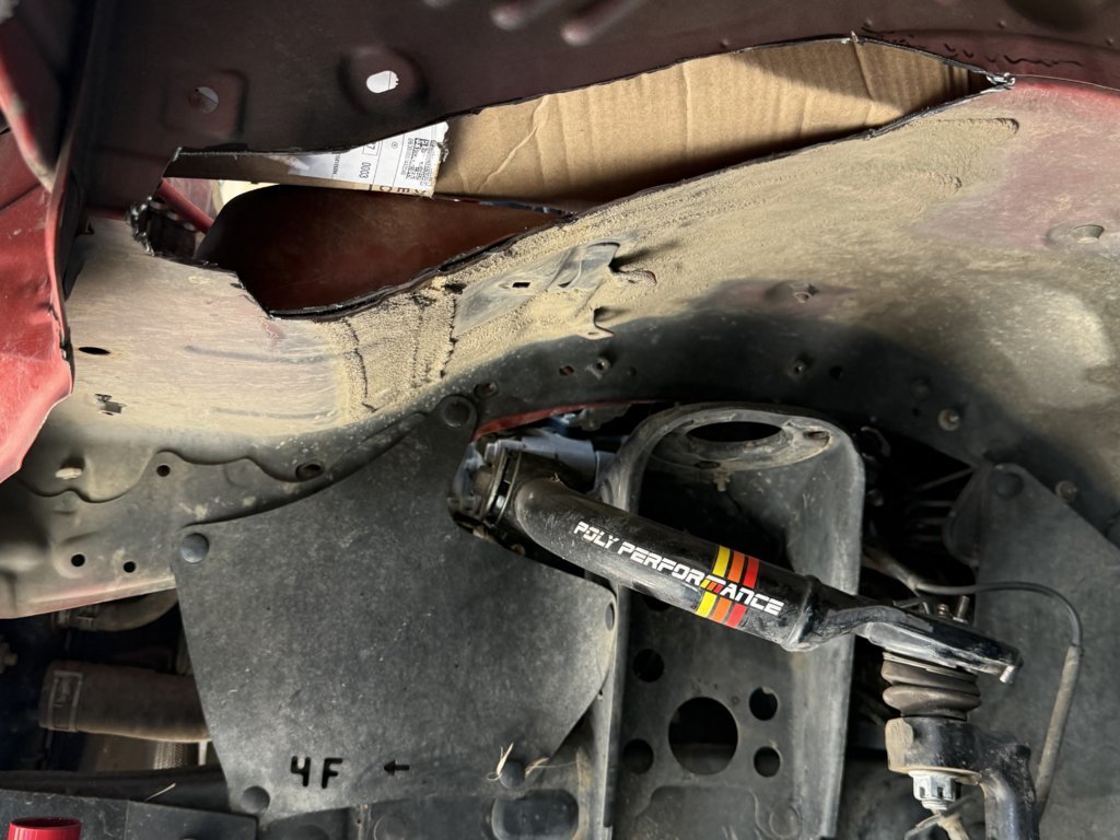

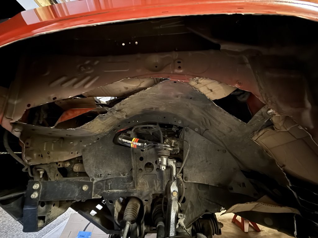

    Cut, test fit, cut, test fit…I should have never joined this site :D

    Im surprised you wouldn't have to cut more honestly. Looks good though

    Oh definitely not done yet. I’m hoping going down to 17x8.5 -10 from the 17x9 -12 will help a lot in reducing how much cutting I have to compared to others here.

    Still rubbing at full stuff lol:frusty:
    I am slightly rubbing on the UCA and the frame now too, but I have the tie rods off so I’m not sure if the truck can actual turn that far in or out. Will have to see when it’s all put back together.

    Hey did you use the same box for the battery and the compressor? I only see the battery one listed on their website.

    I added a JD box on both sides of the bed. The battery box (Driverside) you wouldn't want to add anything with the battery. The (passenger) side box holds the twin ARB and room to add a few small items if needed.

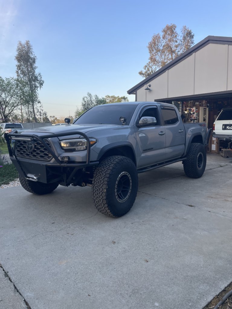

    Here my rig , on 37s . So I bought 40s already just trying find out that ppl are doing to move stuff from the engine bay , I’m not to worried about tubbing . My main concern is the fuse box ( electrical) stuff , I’ve seen the washer tank hacks seems like I can figure that out anything else i should be concerned about, I wana tub the crap out of it so maybe I can fit 42s for the winter but have a feeling that’s going to hit the headlights , any other retards like me out there ? https://youtu.be/OTmY8-90CeE

    Do you have any tubbing done on your current setup?
    I just got bfg “37s”. Getting cab mount relocate soon but not sure if I should cut and weld or just hammer

    no ,no tubbing just hammer some of the pinch welds and cut a little off the cab mount ,but i did all that for 33" when i didnt have the rclt , with the rclt kit i think you just go to hammer town and your good but im running a 17x9'' rimand 3.5 or 4'' back space

    also the bfg km2 or whatever it is (the new one ) is not a true 37 its more like a 36

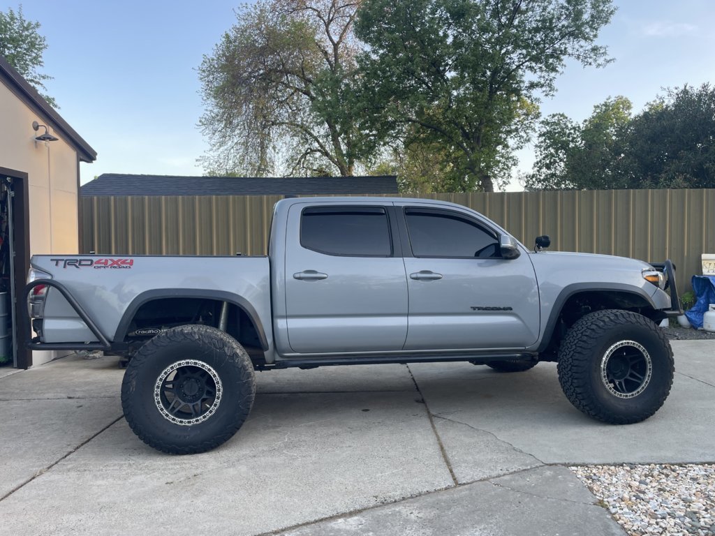

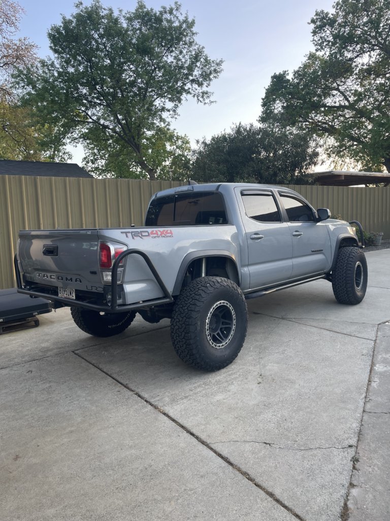

    Yeah, I was going to say. Your fenders are trimmed less than mine were for 35s so I assume you haven’t cycled full travel on them?

    Oh it’s cycles all the way my finders are touching the tires at full flex it’s not cut enough , the black plastic finder pieces are coming off later it just looks good for now , my shocks are at the lowest I can still go up a bit , so your saying you have the rclt kit and you chopped more up on 35”s then I did on 37s ?
