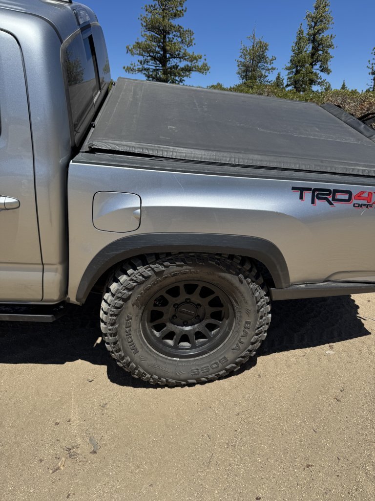

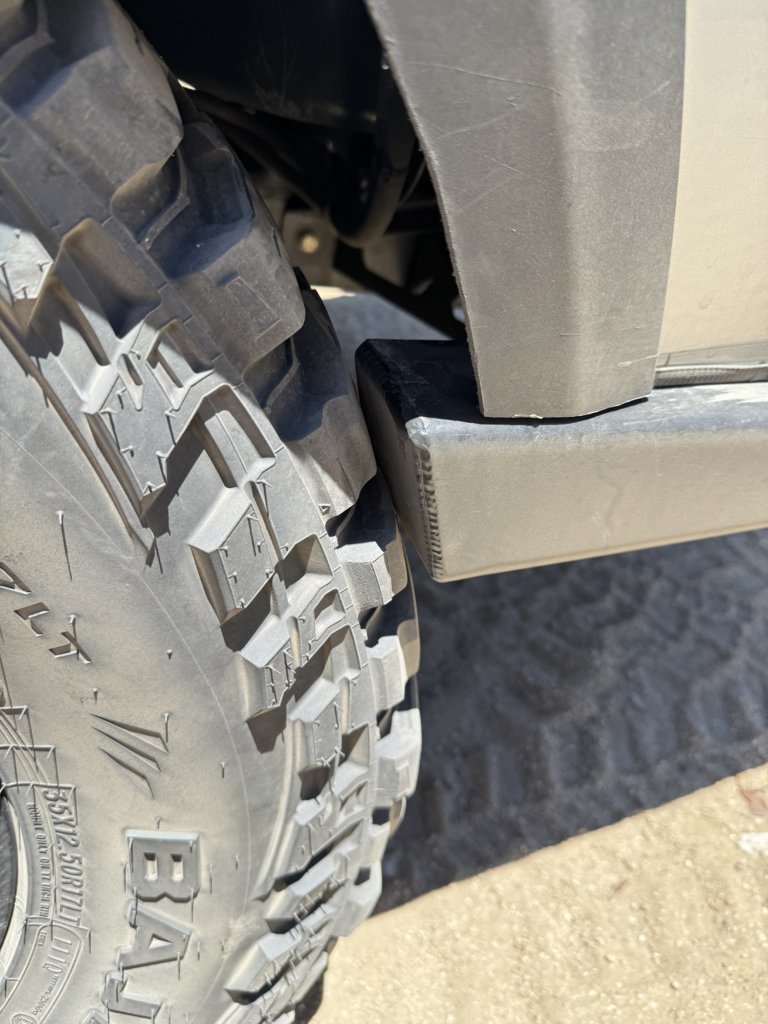

    The rear. It’s hard to judge from pictures so maybe I didn’t. I’m trimmed right up against the fender flare retaining clips and I just barely clear.
    My high clearance rear actually doesn’t clear and I needed to trim it and weld on a plate.

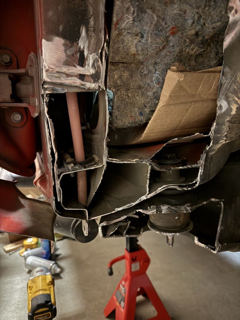

    Calling it here, otherwise I will need to relocate my fuse box as well as my battery.
    Gonna run a short bump stop spacer for now and later do a 1” body lift and get rid of the bumpstop spacer.

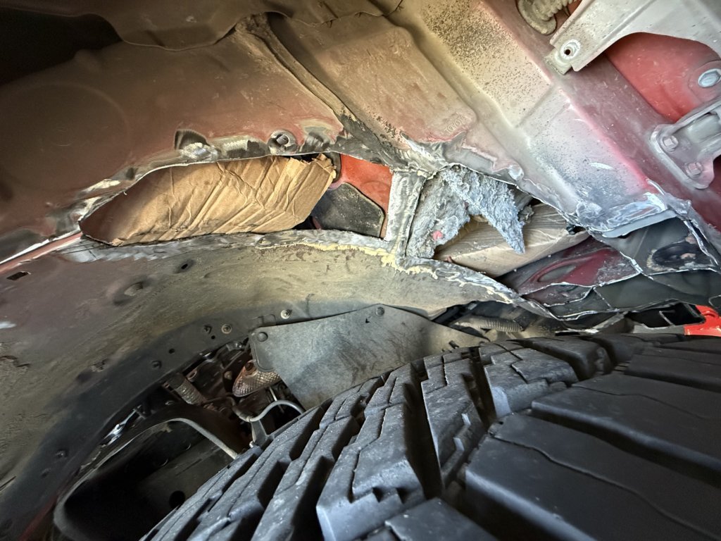

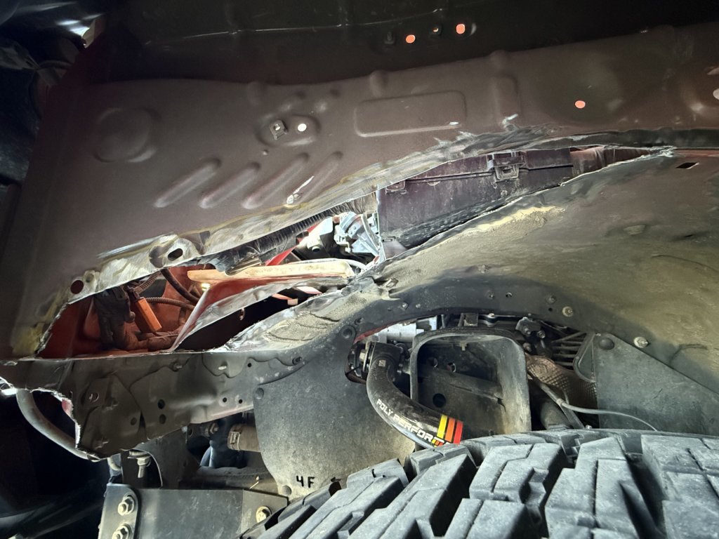

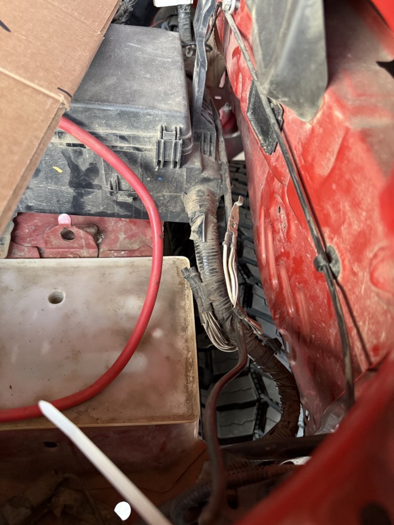

    Any photos from the top? I'm smacking that area with 35s (even with a 3/8" spacer for my Superbumps) and am trying to decide if I should hammer it out or cut.
  11. Jun 4, 2025 at 2:07 PM
    #711
    UMC
    UMC I will not comply
    May 2, 2019
    #292062
    519
    Thomas
    South Fork of the American river.
    13 TRD Sport DCLB 4x4
    37's & rear locker
    Are you referring to the upper front portion of the fender well under the battery and washer fluid tank?

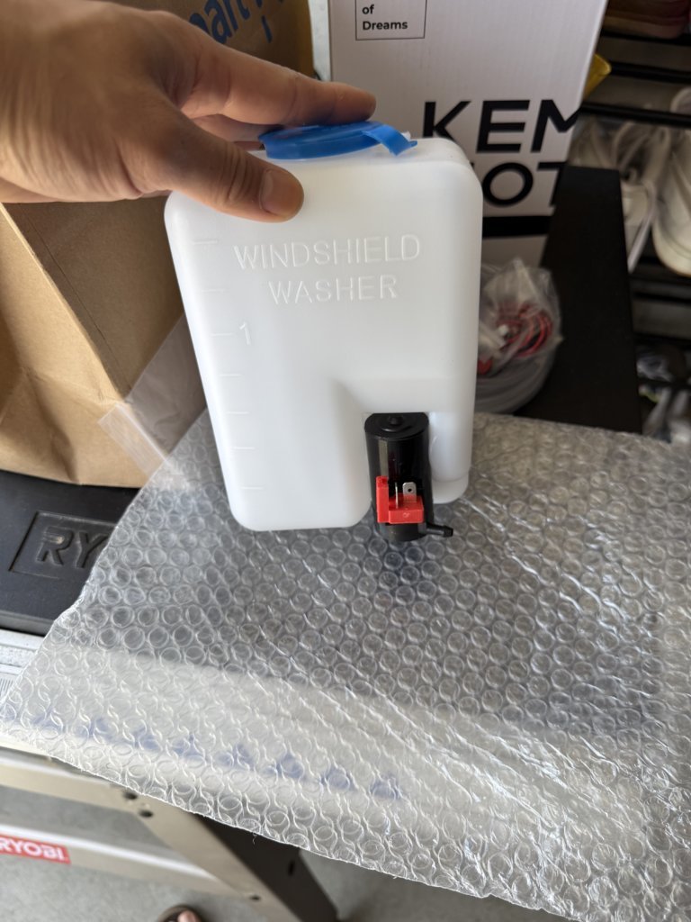

    I'm on 35's too. I don't have a spacer on my bumps but I was hitting that area as well on both sides. I hit the hell out of it with a sledgehammer and no longer rub at full stuff/lock. I first removed the battery and the windshield washer tank then hammered it.. My battery now sits at an angle but it's okay. The washer tank I had to modify. I cut 3 and 1/2 in out of it and then glued it back together.

    Yep, exactly. Mostly was worried about damaging the battery mount, but also because my OBA is mounted right next to my wiper reservoir. Guess I'm take care of it the next time I use up all the fluid.

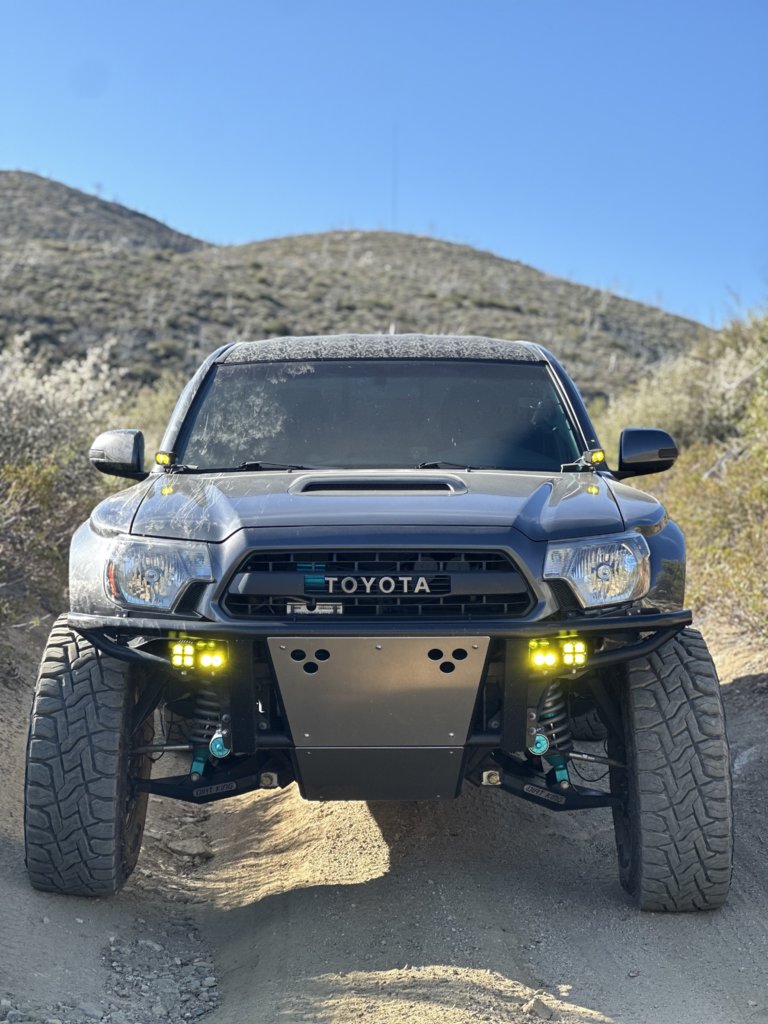

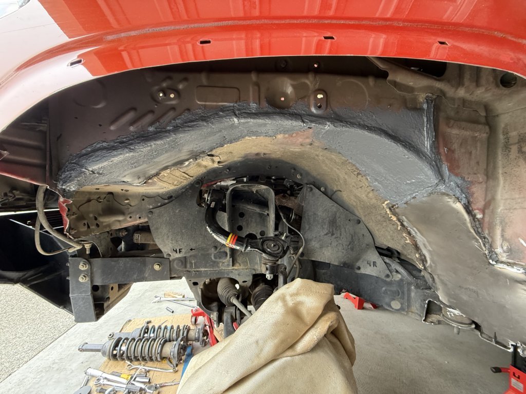

    Getting close to the finish line but what did you guys do about this drip line? Not sure if there’s an existing drain hole in that rail or not.
    Upper plating welded in and seam sealed up. Need to finish up the bottom plate and seam seal it inside and out too.
