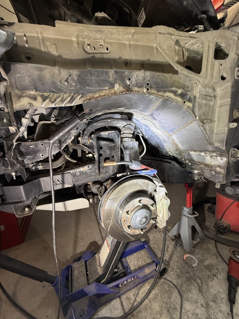

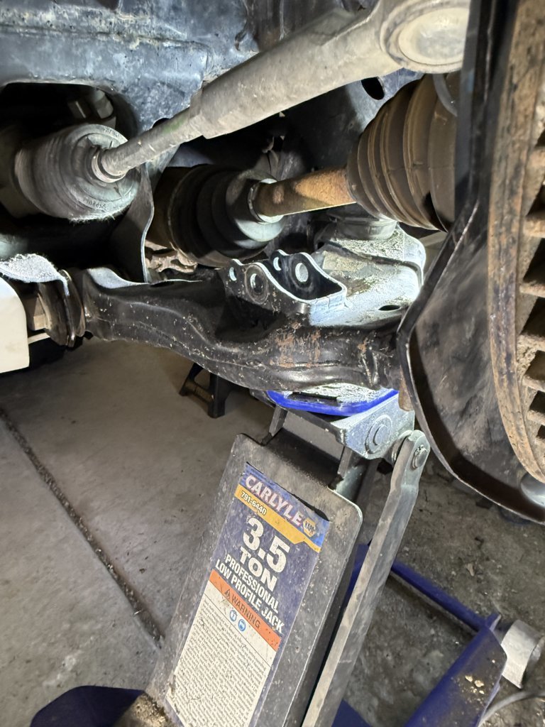

    Finally off jackstands. Need to wire up the new windshield washer fluid reservoir, put the air box back and reassemble the interior and she’s done!

    Only thing left to do is the washer fluid reservoir, tidy up the fender trim and clearance the rear. Got it aligned today and can’t really tell much of a difference in drivability aside from a little more body roll.

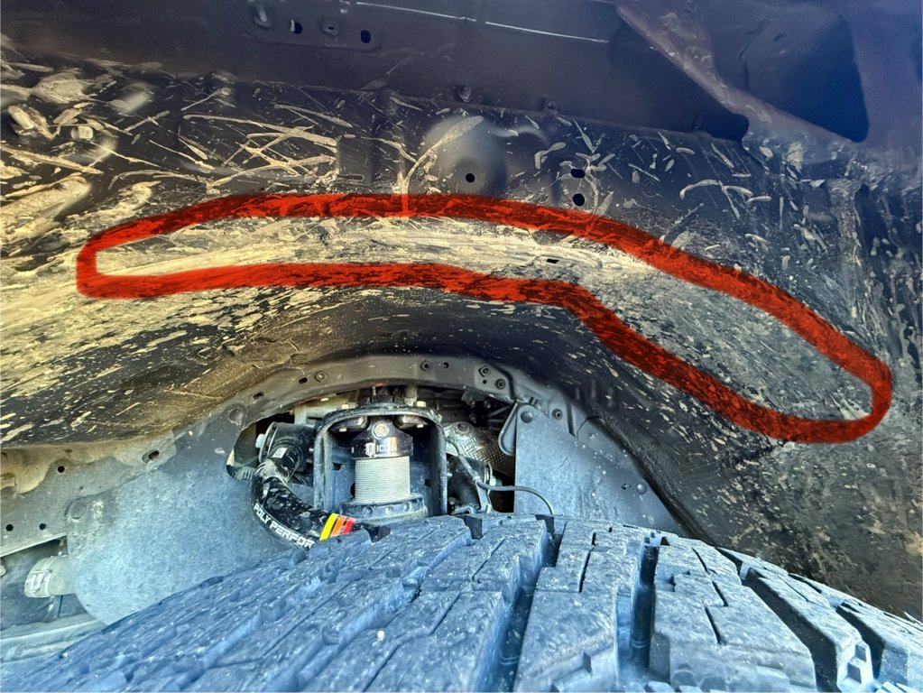

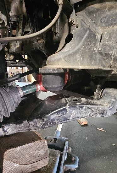

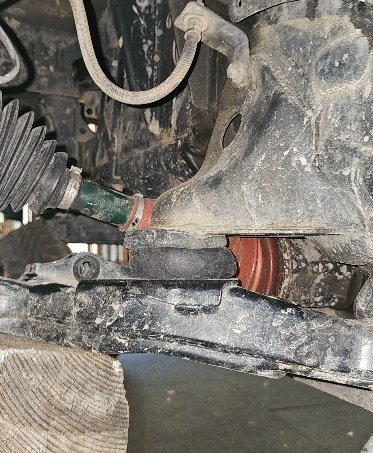

    I'm doing a test fit with a 37 x12.50 x17 Yoko Geo mt.
    I got the shock removed. How compressed can this bump stop actually get in real use? Have I compressed it enough or too much? Anyone that's done this before have advice? Here's a couple pictures of it compressed and not compressed.

    Probably fairly compressed especially during a harsh impact.
    I’m on the factory bumps in the front but when I tubed mine I kept jacking up the lower control arm until it started lifting the truck so I could get as much deflection out of the bump stop.
    To also account for both control arm and cab mount bushing deflection which are nearly impossible to account for by just using a jack, I cut a few inches past full bump on everything.
    In your case I think its worthwhile to compress the bump as much as possible and still cut back a little more. I came across a guy who had his truck tubed by a shop and they didn't quite take enough material out and he still slightly rubs on the upper fender.
    Even after all this I'm also still slightly rubbing on the actual cab mount and I have a cab mount relocation and my lower cams maxed out. To fix that I either need to long travel the truck or get high caster LCA's.

    For rubber or foam bumps I always assume they squish to zero, so till the arm hits the bolt head inside. and then account for deflection of everything so you need to cut past that point for sure

    I jacked it up until it started to lift the truck but the bump did not flatten to zero.

    If there’s any question about how much the bumps should compress you could always take them out and cycle and cut so you know for sure

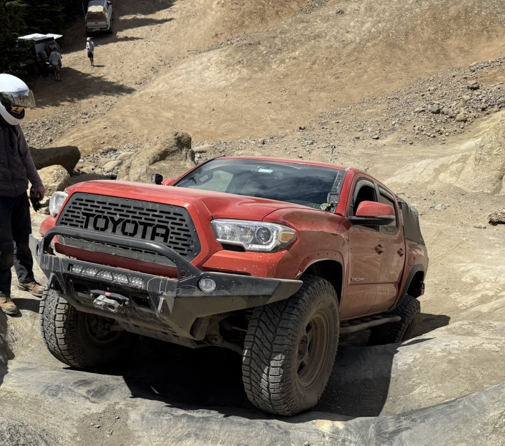

    Got the new Yokohama 37s on and took them to the Rubicon this past weekend. Pretty sweet!

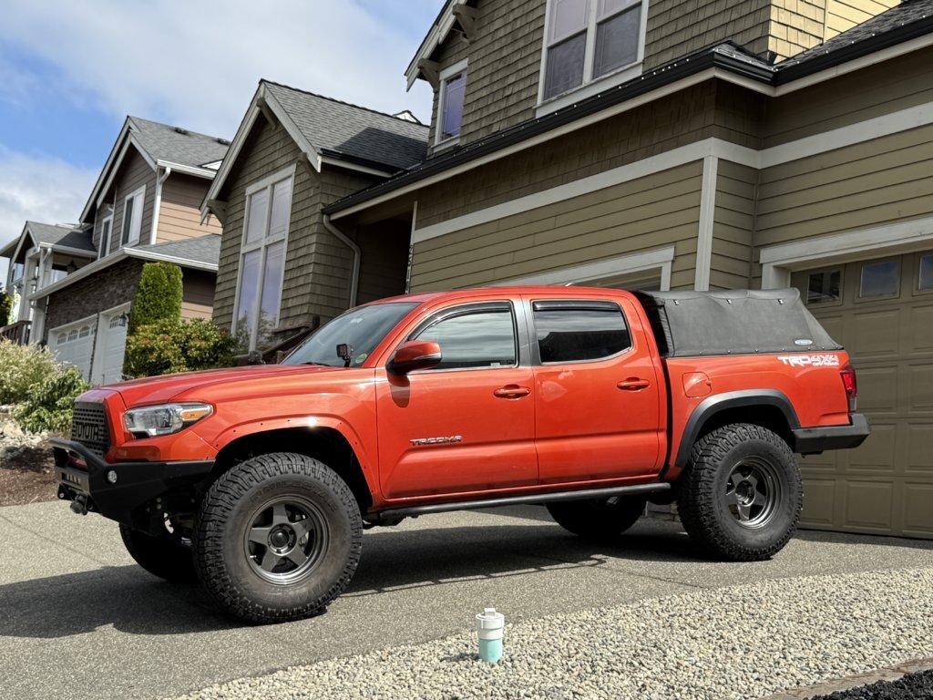

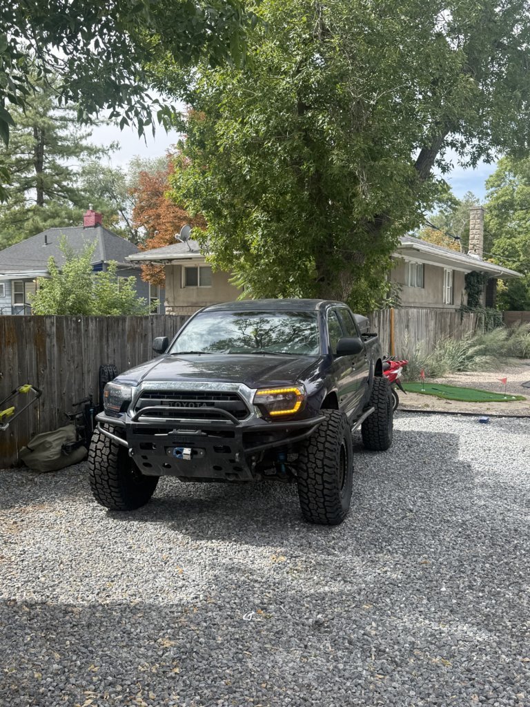

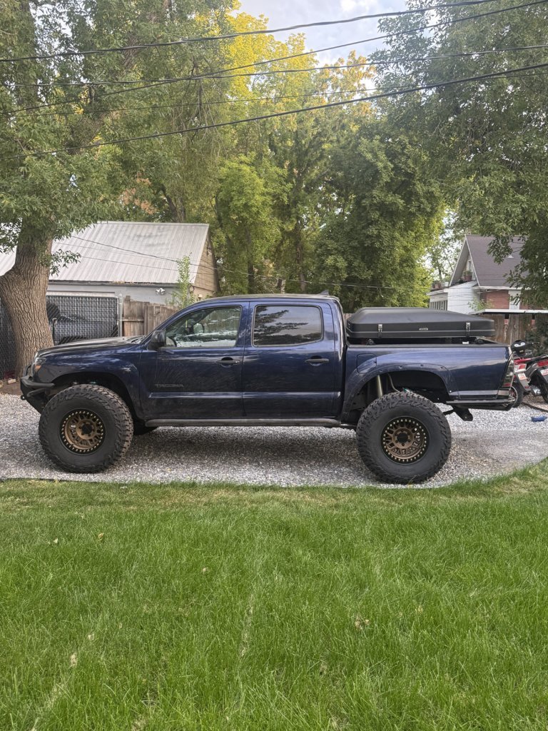

    my yokohama m/t 35s went bald so mickey a/t 37s and beadlocks it was. now to see how long a stock rack lasts lol
