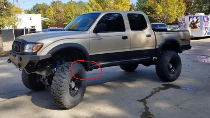

    Hey there everyone. I have a question about fitment on some tires .I just got a 2001 Tacoma double cab . As of right now It is equipped with the 6" fabtech lift with king coilovers and a 3" body lift running 35x12.50-15 bfg mt

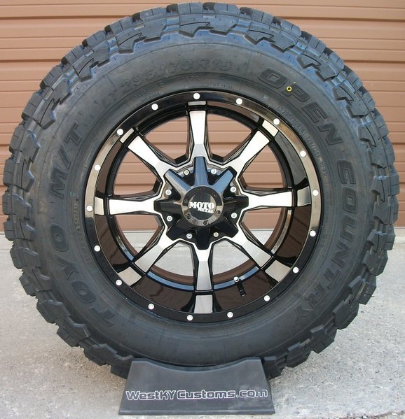

    I just ordered a set of Moto metal 970 in a 18x10 with 37" toyo mt . Couple of questions.
    The wheels are -24 offset and 4.56 backspacing. Do you think the wheels and tires will clear the control arms fine? Also I know 37 are a lot of tire for IFS on the truck and a 1st gen in general but the truck has 5:29 gears front and rear already and are a little too much gear for the 35 on the truck which is why I wanted to go with 37. I know I have seen a few guys running 37 on similar setups but most have a spacer on top of the fabtech struts to give it a little more lift more like 10-11" of lift. How bad will they rub with just the total of 9" of lift? Since I have the king coilover do I just crank them up a little more to do the same concept as the spacer does on the own fabtech struts? IMG_2468.jpg

    I have a Gen 2 with 9" front & 11" rear. I think your biggest clearance issue will be the inner fender when your wheels are turned and the wheel travels upward. Gen 1.jpg

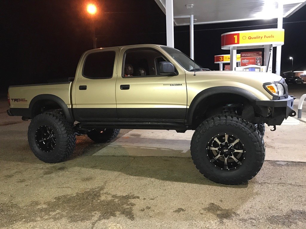

    got them put on a couple of weeks ago . for the most part the fit pretty decent. they rub a little if you flex while turning but for the most do pretty good. I'm happy with them
