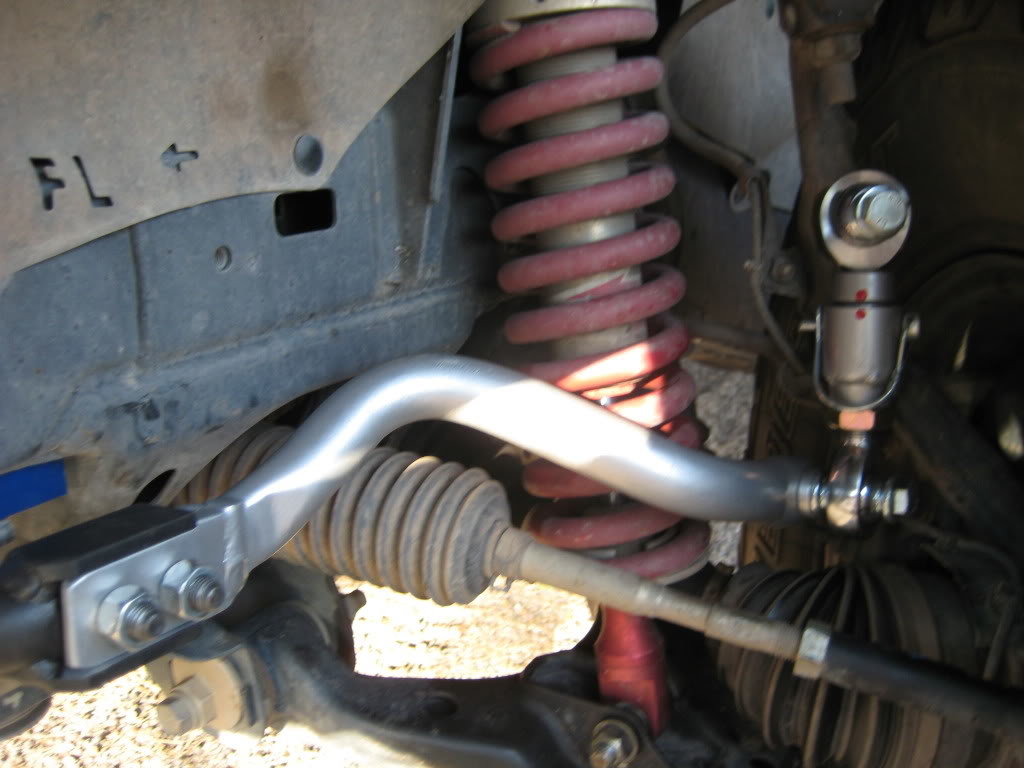

    The portion of the sway bar aft of the tie rod will dig into the CV boot at full suspension flex. This has been demonstrated before (i.e. a TW member progressively flexing the suspension and photographing the area). The proper way to do a sway bar disconnect is to cut the sway bar just forward of the steering tie rod and weld a tongue-and-groove joint to it, like this:
    The silver portion is removed from the vehicle when you disconnect the sway bar. Pretty inexpensive to do if you have the welding skills. Most fabricators would not be willing to take on the liability (i.e. if the weld fails while you are cornering, it could cause the truck to roll over). Unlike other parts such as bumpers and skid plates, a sway bar cannot be reasonably declared as "for off-road use only".

    It's essentially the same setup as what JKS does with their disconnects so I don't see the safety issues. However, on these trucks the sway bar doesn't seem to make much difference. Been running without mine for about 15K miles and didn't notice a difference
