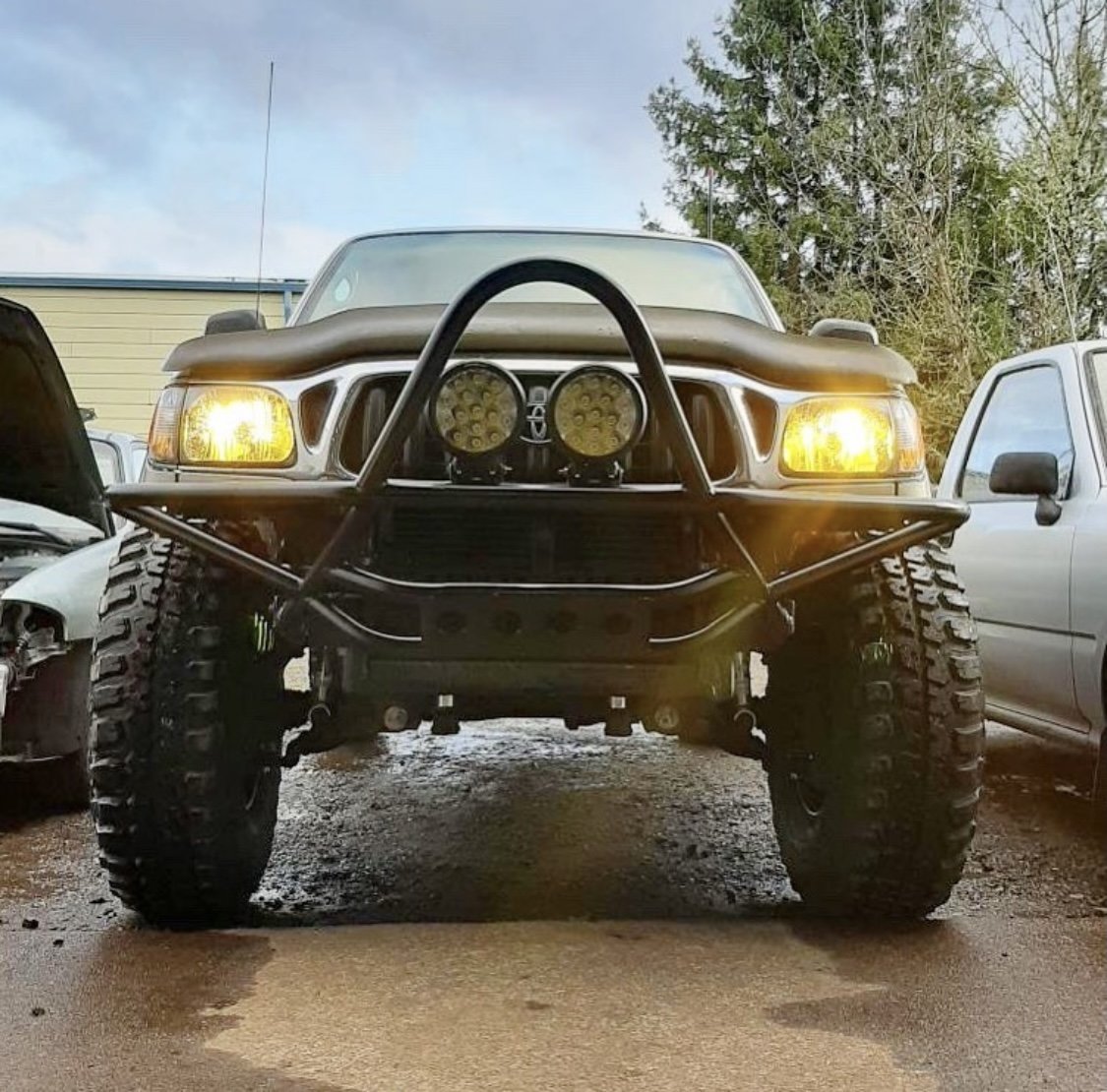

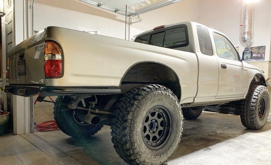

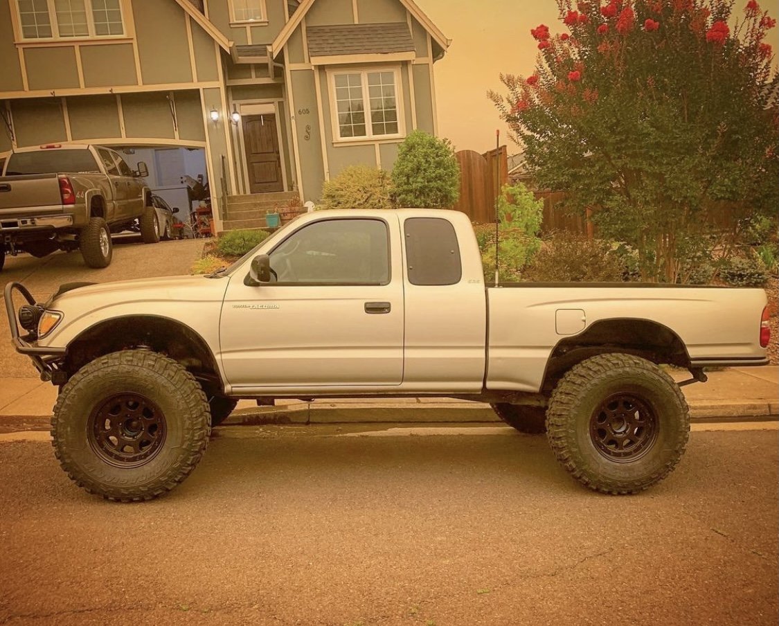

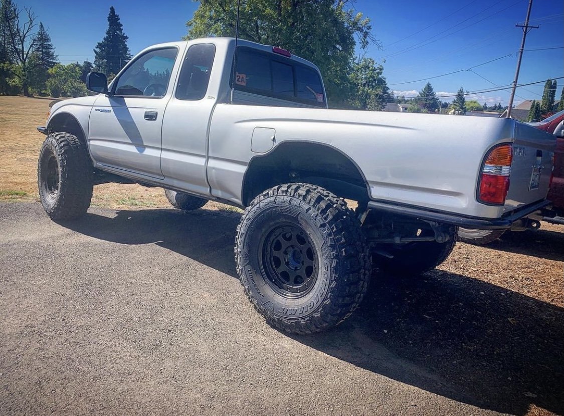

    I fell in love with this guys build awhile ago. I just finally got into contact with him and got all the specs he did lower and upper control arms and the tie rods all that. I asked if he thinks it’s safe and worth it to take this route as I would love to have my Tacoma evolve into this. He says cvs are cheap and easy to replace so it’s no big deal. And the other thing is the most wheeling I’m able to do if maybe once a week with my work schedule. Let me get some opinions on this

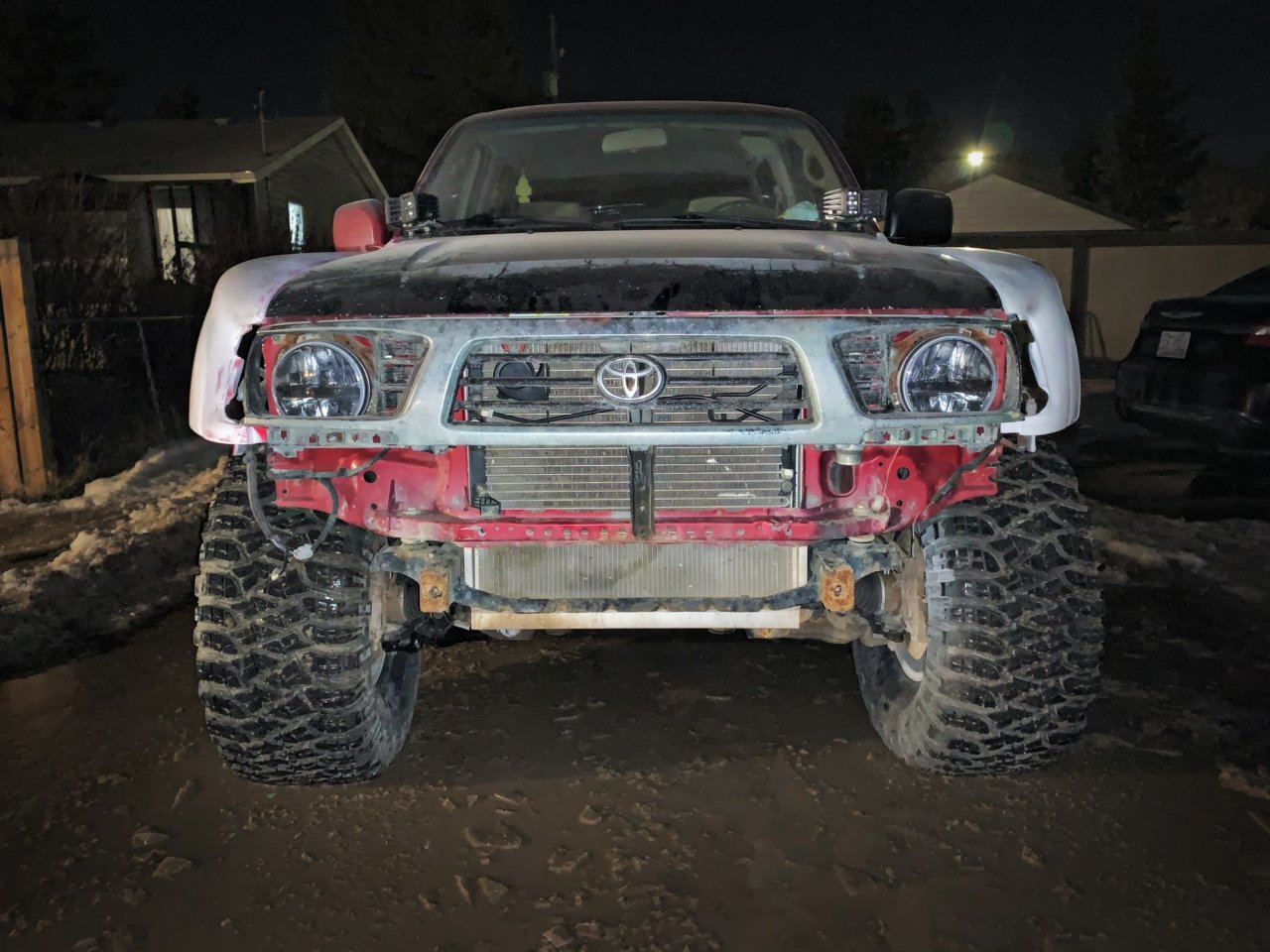

    I think @POSTacoMike just put 36s or 37s on his IFS 1st gen, he would be a good person to talk to since he's also done it

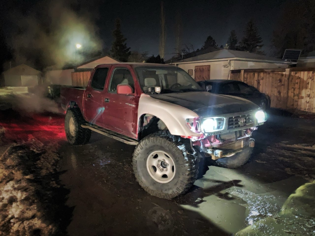

    I’ve been following a few guys that have been going to 37”. I ran 35” all last year. I wanted a big fuck off snow shoe tire for winter wheeling in the Rockies. I figured I could make both the 36x15.5, and a 37x12.5 fit, and work.
    Things to consider. 1) I swapped out my ADD tube to a non ADD tube. 2) ADD cv’s are 6mm (1/4”) larger. Might not seem like much, but they are stronger. 3) Gears. Are you going to regear? @snotaco is running 4.30’s, I’m running 4.88’s. A buddy up here is running 4.10’s.
    As for SAS, personally, I have to drive 4-600km to a trail head, I prefer the IFS ride. Time will tell whether I’ve made the right choice. But with more of us doing this, it’ll push manufacturers to look at upgraded IFS.

    Custom grooved and siped Mickey Thompson MTZ’s. 375/65/16. 36x15.5-16”.

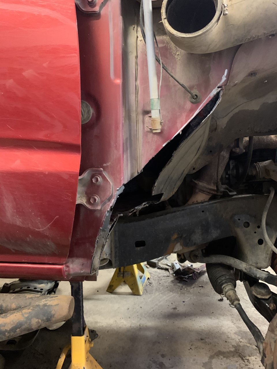

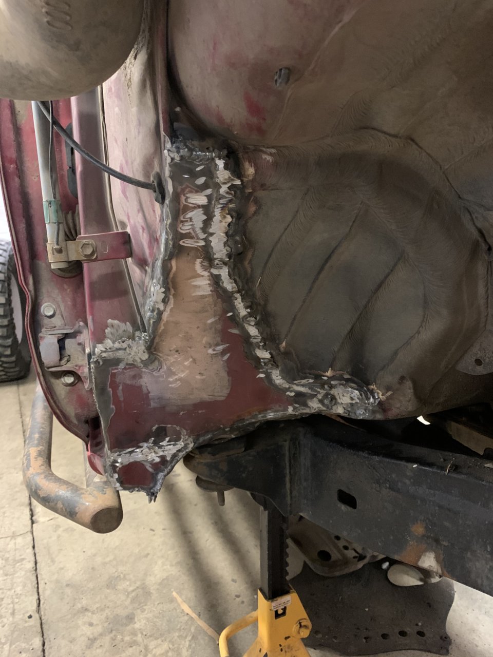

    I did a frame swap last spring. While I was there, I cut about 1-1/4” out of my cab mounts. Then we cut the firewall to match. I’m trying to not go to a body lift.

    Passenger side cut.
