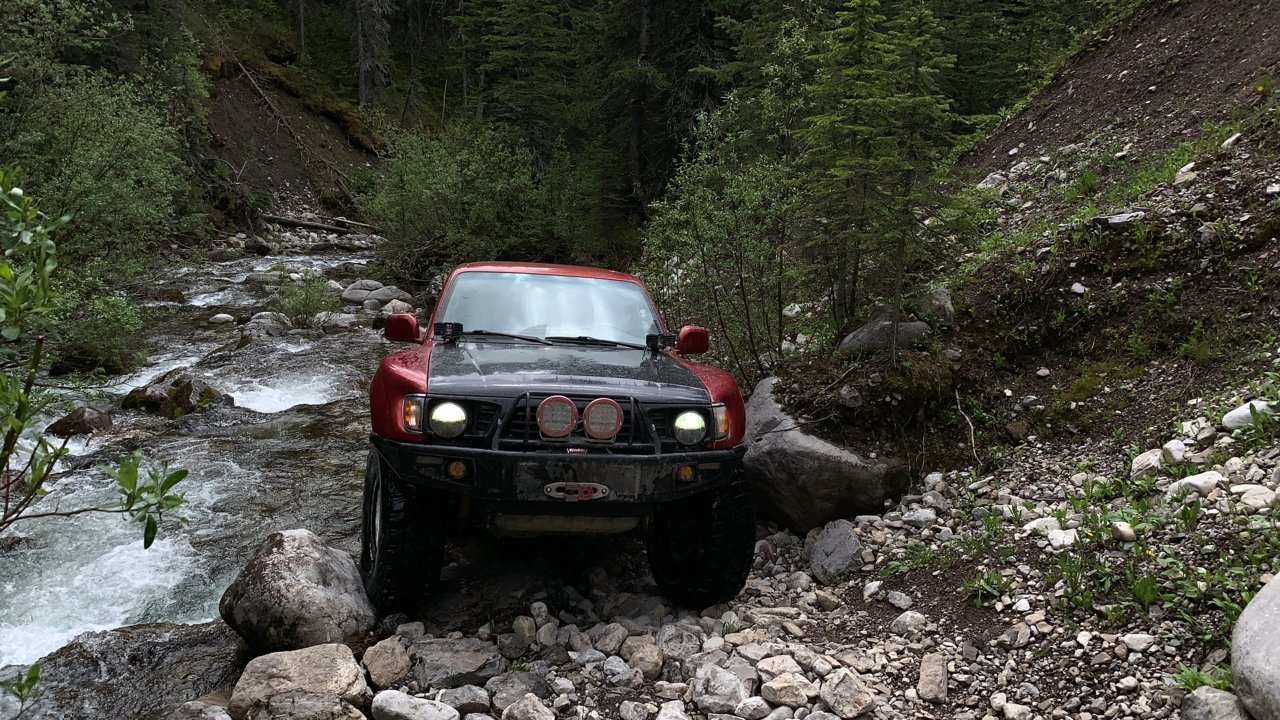

    Got it out to play Saturday. Now to throw the duals in her.

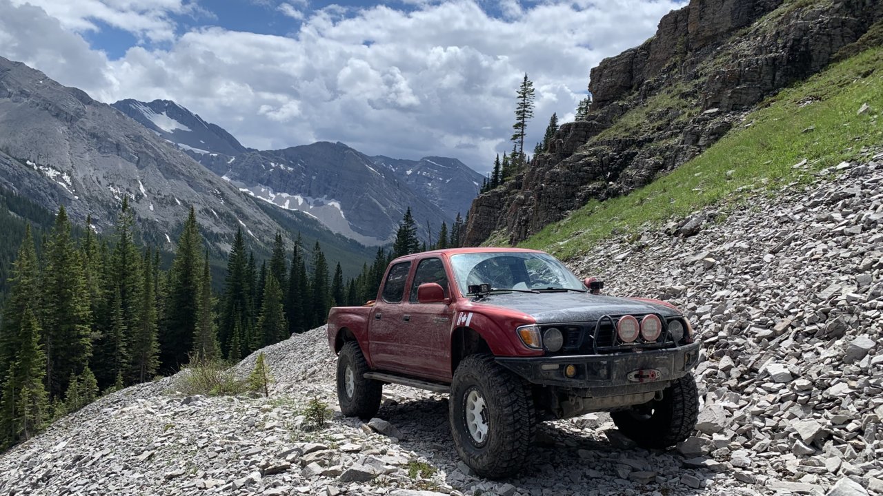

    Dual cases are in. Finally got it all together and got out again. Now to see how it all holds up with the 37”. I did lean the box sides into a tree pretty hard, and watched it deflect! No damage. I’m pretty stoked.
