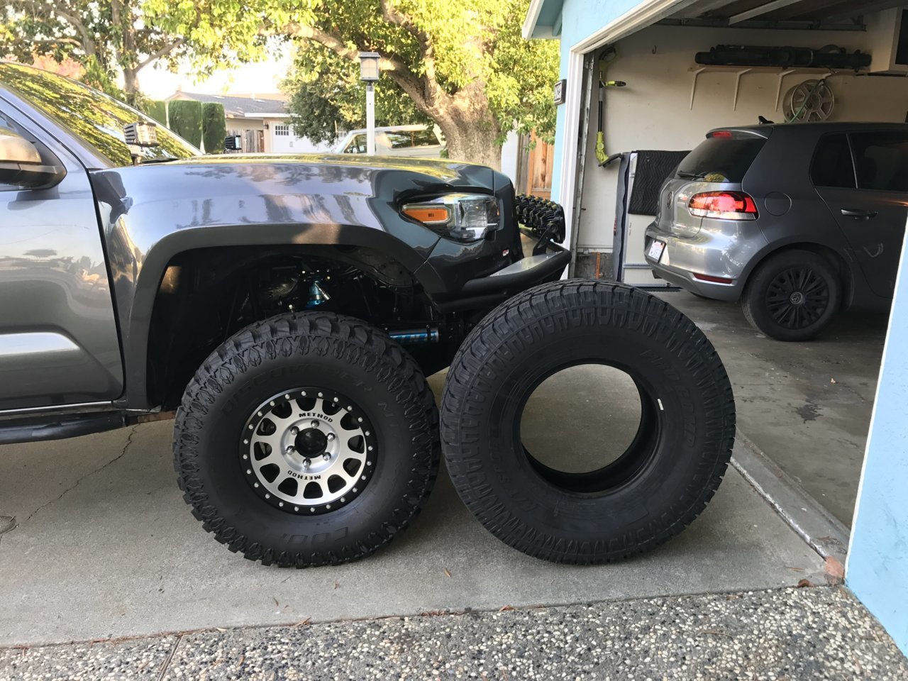

    I have 37’s as @Jibbs mentioned. I’m running them with a 3.5” long travel and 6” fiberglass fenders/besides. Also only have 4.88’s (with OV tune) and it’s an auto.
    The gearing is fine. I feel like it’s the same as 285’s and stock. I really need to update the tune as I’m still on the first one. I think the newest one will make a big improvement. If not gear lock will.
    The fit is a different story. My can mount is pretty much cut to the bushing both on the front and side. Both sides rub at full lock when turning. Only solution is either tub the firewall or get friendly with a big sledgehammer. I haven’t done either yet because I haven’t cared enough. I don’t think my truck is lifted much higher than an inch or so.
    I will say they look good though! Here’s a couple of random pics.
    Nothing has broken or worn out yet. I have about 7-8k on them by now?

    Next to 35’s. After this pic I was a little nervous to continue. :rofl:
