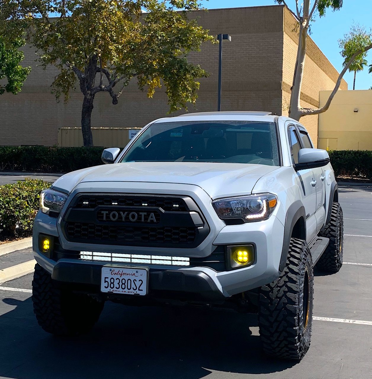

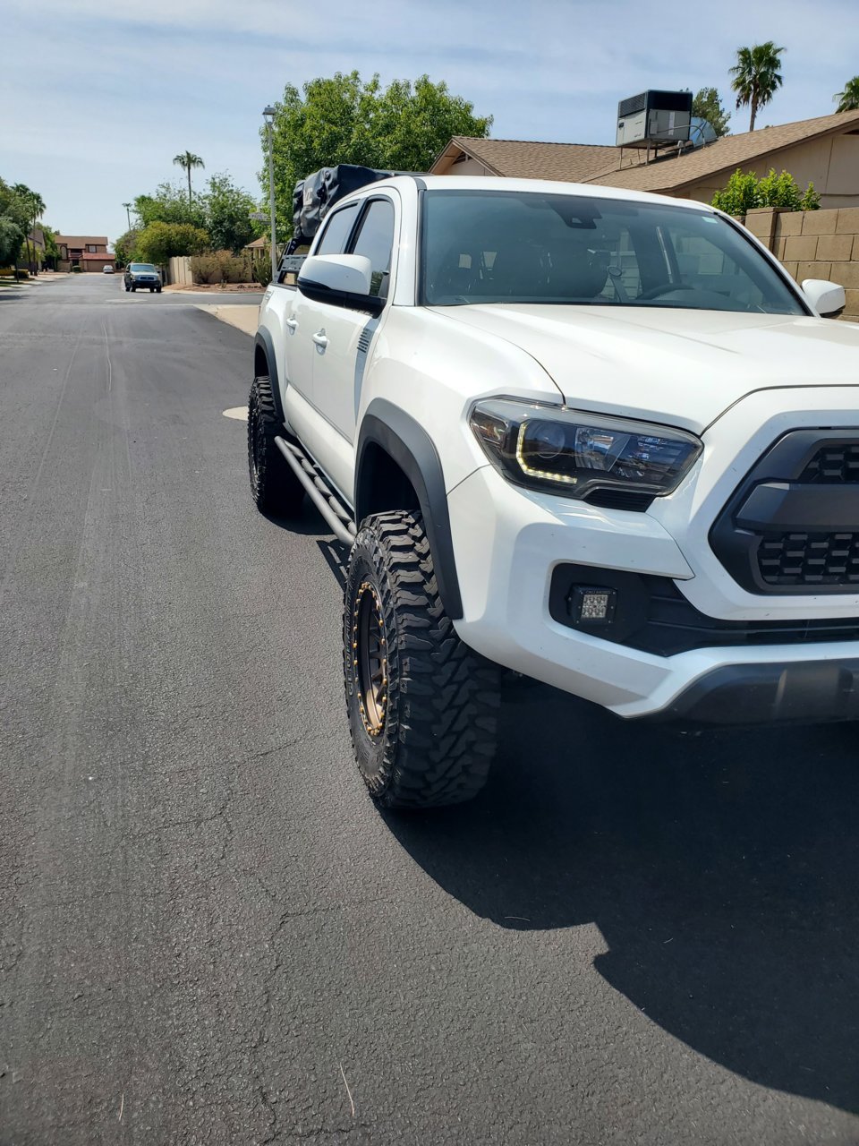

    2/1 lift, 17X9 -38, 295/70R17. CMC and wheel well plastic liner was trimmed/cut.IMG_0167.jpg

    That looks clean! Where'd you get it done?

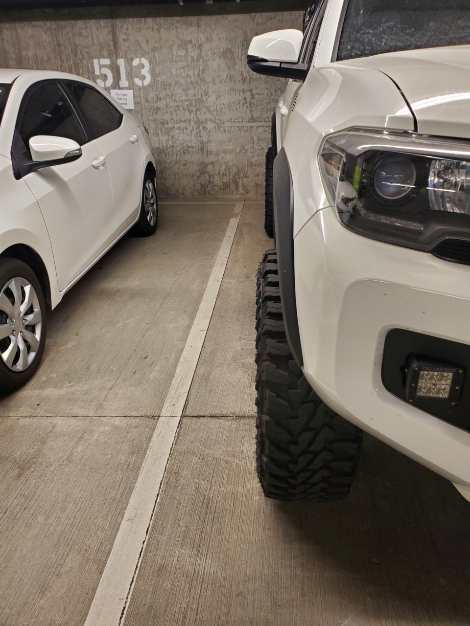

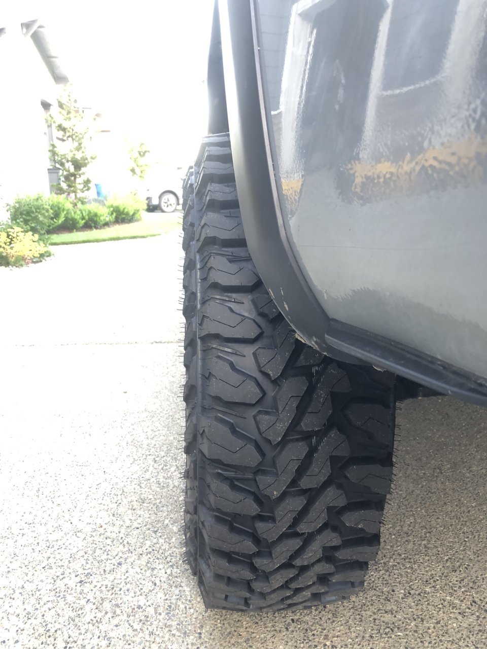

    here’s an idea how much poke might look, these are -38 offset

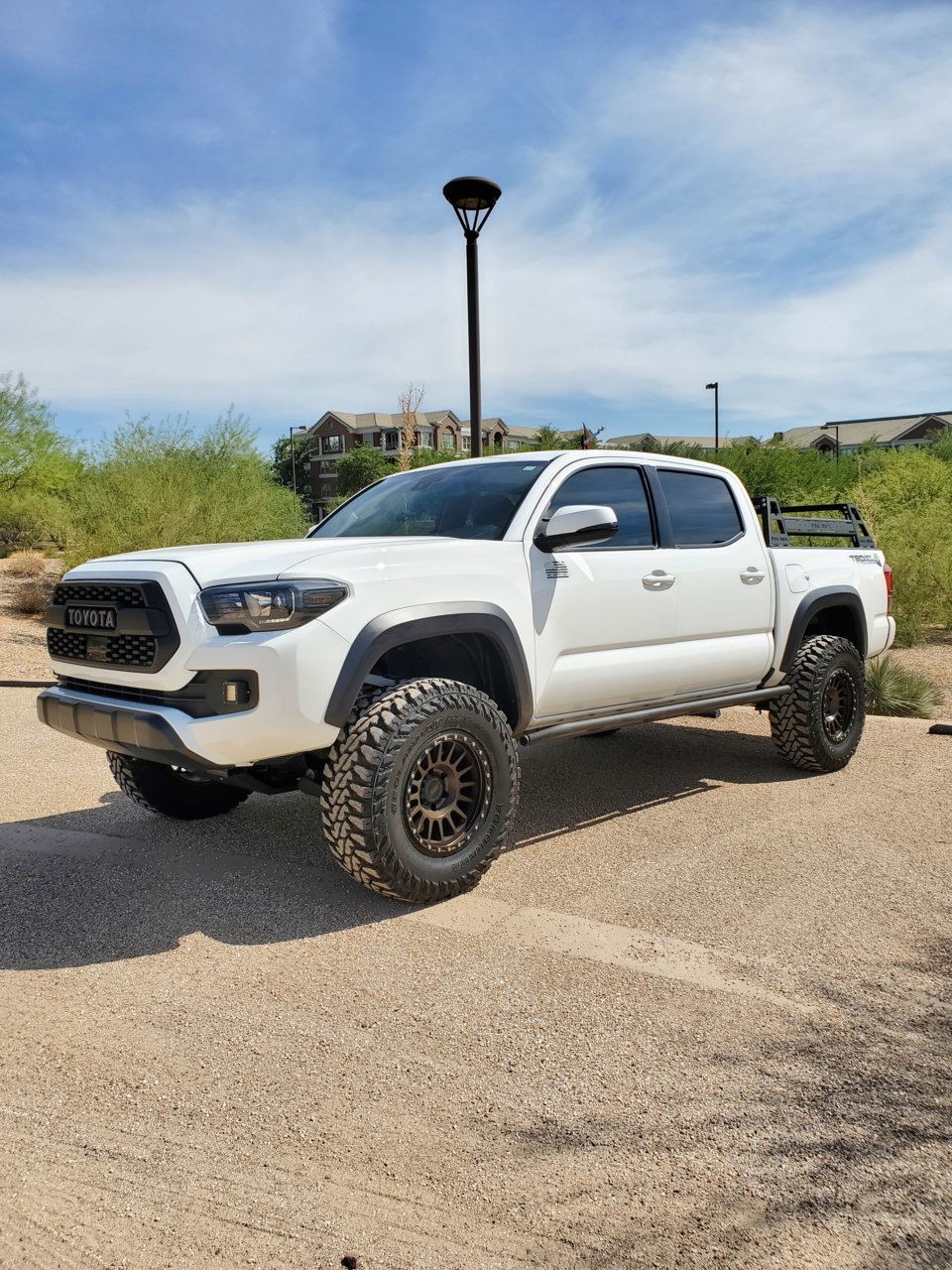

    I like my -25 offset, just enough poke to make me happy. I had -10 ray 10s and wasn't satisfied, Rubs in reverse turning but nothing crazy
