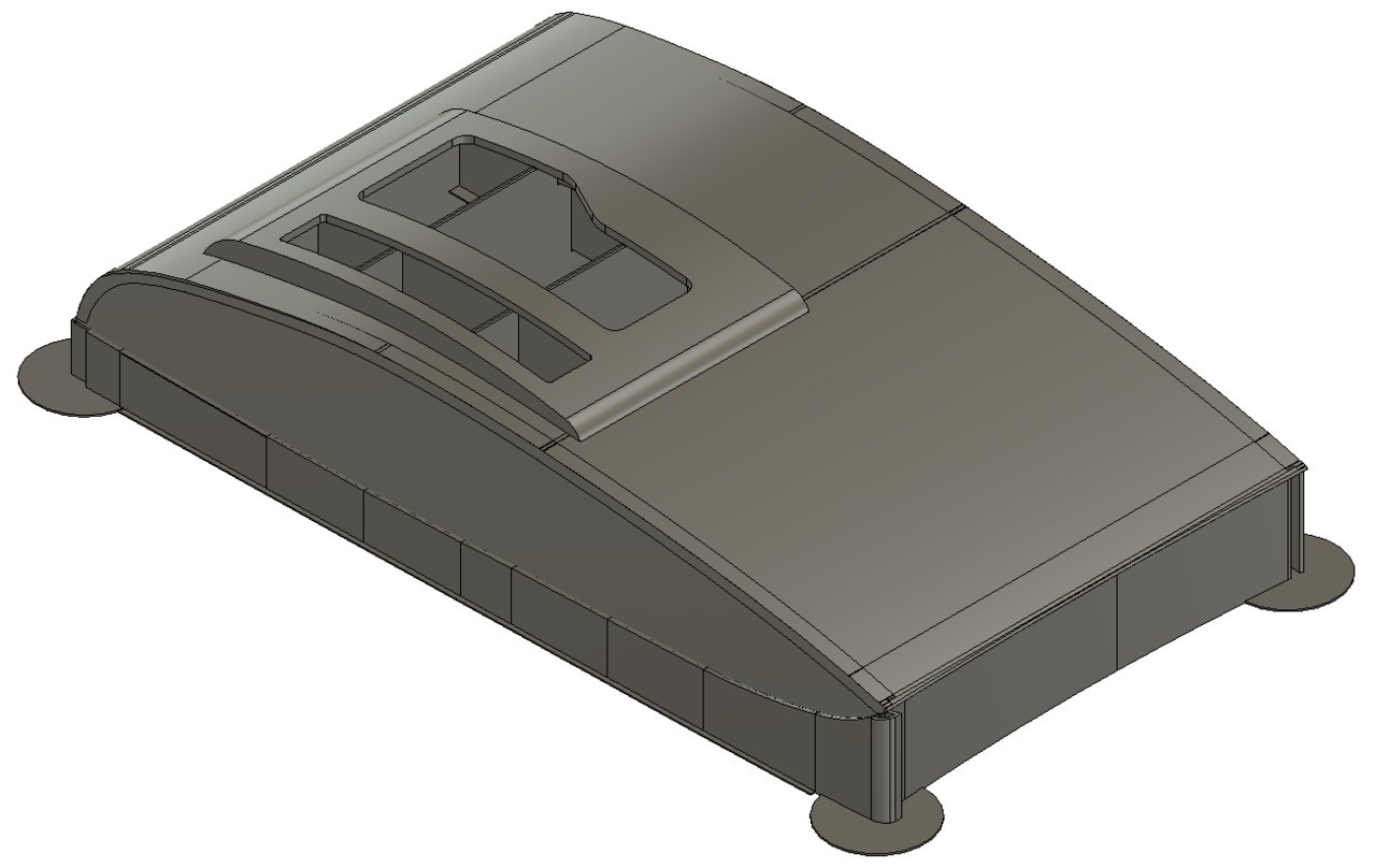

    The one in gray filament looks really clean, did you do much post processing on that? If not your printer and slicing software settings are on point. That print job looks like it might require a ton of supports, is it a pain to clean up afterwards?

    A ton of supports. Slicing software only goes so far though. Large contoured overhangs in abs and asa have a tendency to detach no matter how good your slicer or printer are. I modeled a scaffold system to hold all the edges down that get cut off after printing. It's not too much of a pain, but still requires a bit of work to remove, but it has made it a much more reliable part to print.

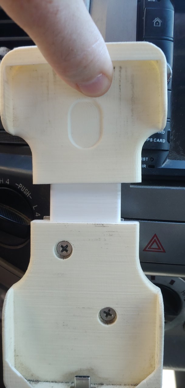

    Nope, using ASA. Some brands of PETG will still get soft enough to warp in a car, and I've seen some fade in under a month. ABS handles the heat, but even it fades under the unyielding assault from the Sun. I've had a test piece I printed in ASA sitting out in my driveway since June that has shown no signs of fading. My phone dock has been in my truck for years, but it has yellowed and when you see a part that has been shaded you can see the difference clearly.
