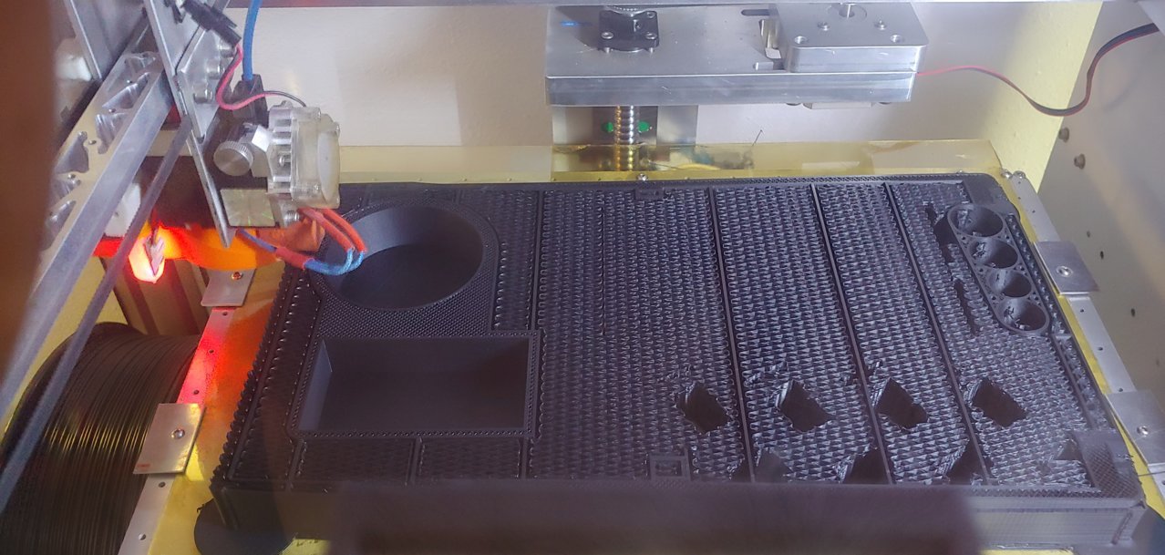

    I got a picture to give an idea on the supports. Cupholder/pocket on left, coin holder on right. Everything else is support material...
    bobsuruncle likes this.

    That printer looks industrial lol... those supports don't look like fun to clean up.
    2008taco[OP] likes this.

    That was the intention. Build a production grade printer. I've worked on/repaired production machines for almost 2 decades. It's not too bad to cleanup.
