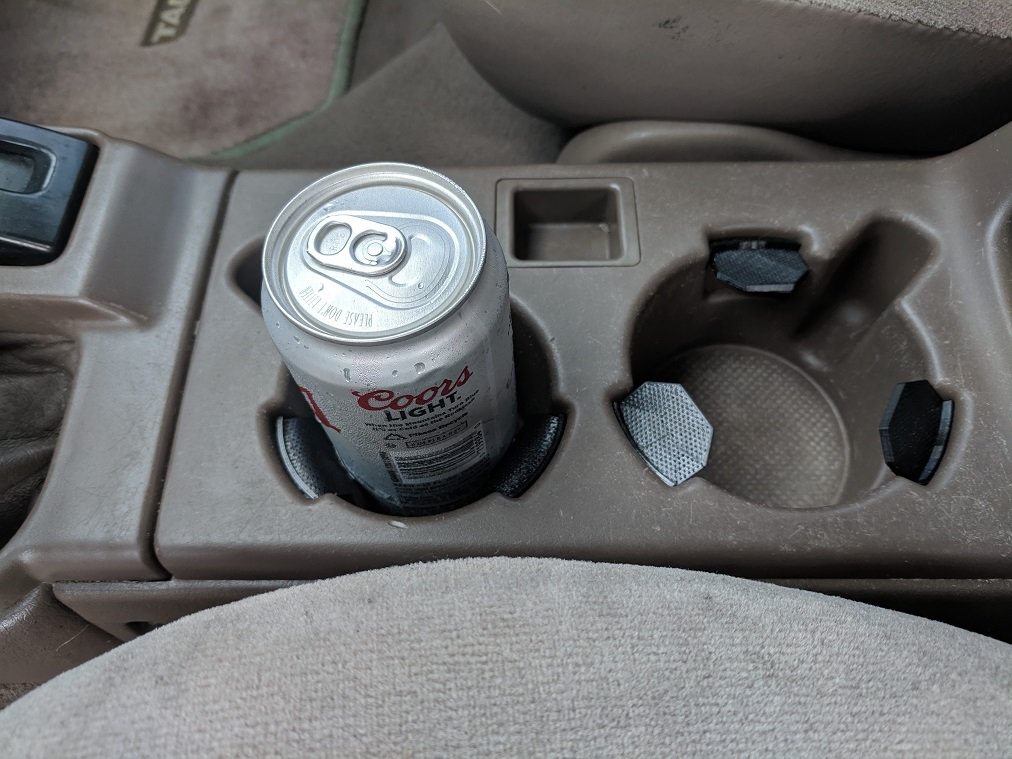

    They look nice. Do they pivot where they enter the plastic or is the material flexible?
    For those that don't have a 3D printer, you can buy new ones that are improved over the original.
    QTY four of 66995-AD011 (the short tabs) $1.58 each
    QTY one of 66995-AD021 (the longer tab that is shared between the two cup holders) $1.58 each
    Here are the old (left) compared to the new (right). New are less "foamy" and much more durable.

    It is a flexible material, you can adjust the stiffness by either printing it thinner or thicker but this seems perfect to hold a bottle or can firmly but allowing ease of use. I have no idea how well the oem tabs worked since both my Tacos had crumbling tabs.

    Be sure to check back in with us in a few weeks after the Florida sun has deteriorated them and they have broken into pieces :D

    Thank you! I was about to design my own and share them here. Are you printing them with TPU?

    Yes, if you follow the link to Thingaverse I have the brand TPU I used. Also, there were two that didn't print perfect so I pinned them on the fence in the sun/weather. So far the TPU is still perfect. The center console also does not get direct sun constantly so they should last a long time.
