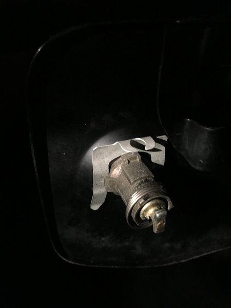

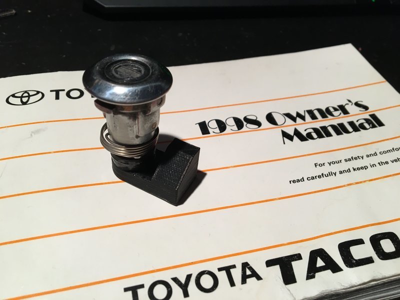

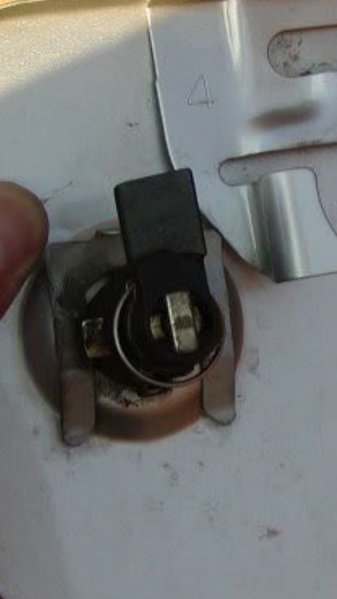

    The plastic arm that keeps the gas door flush to the body used in conjunction with the cam lock broke off my taco. The plastic is super brittle and it broke over time.
    I didn't want to pay the insane $75 dollars the stealership and eBay was charging for a whole cylinder assembly, or add yet another key to my lanyard. I also wanted to use my original key.

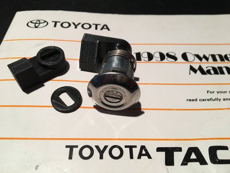

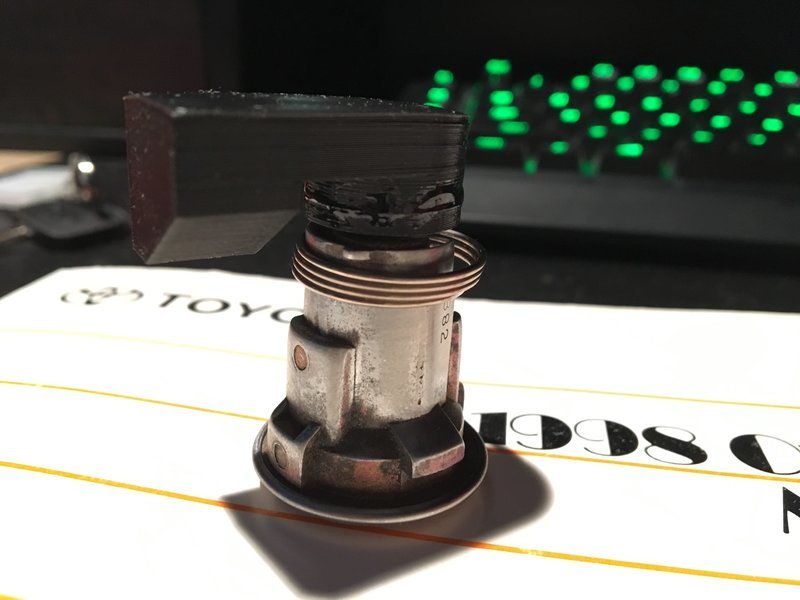

    I followed this write-up and printed these 3D STL files off Thingverse and went to work.
    I printed it with an almost 100% infill (almost pure solid ABS plastic) (Acrylonitrile Butadiene Styrene, not Anti-Skid Braking System, lol.) so that it's solid and sturdy and won't break again.
    Installation was simple, I did the following:
    1. Remove cam lock assembly by pulling on retaining clip
    2. Spray whole assembly and cylinder with brake cleaner to de-grease
    3. Remove old locking arm debris
    4. Sand entire assembly with 400 grit sandpaper (for aesthetics, not necessary)
    5. Roughen 3D printed washer and locking arm with sandpaper or file
    6. Add washer to 'T' post, add epoxy, and attach locking arm
    7. Let dry for 24 hours
    8. Insert assembly into gas door, and add retaining clip
    9. Lubricate pins, key-way, and retention spring with Silicone lubricant spray.

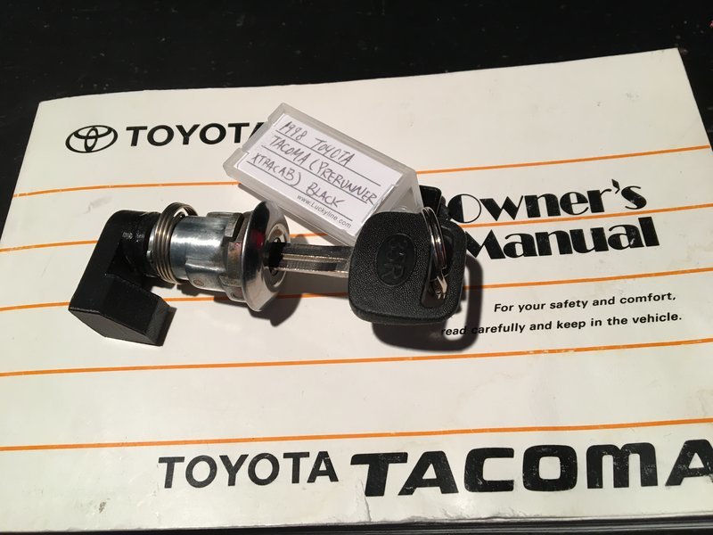

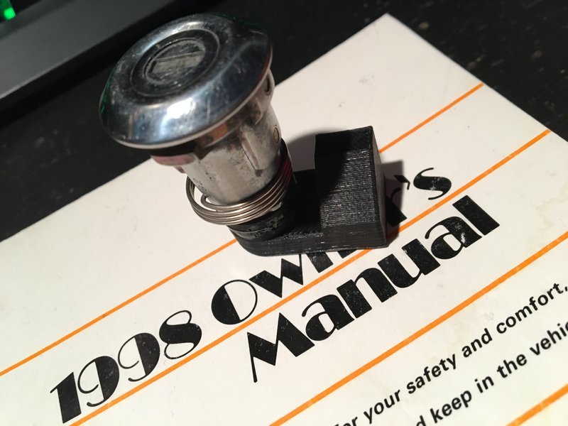

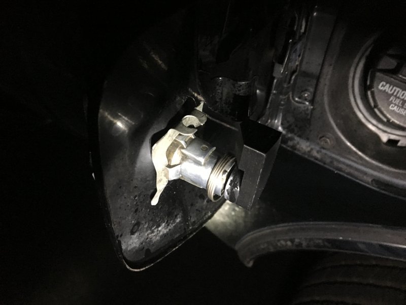

    And you're done. Assembly took less than 5 minutes and it went back on my truck the next day. It works like a dream.
    I printed an extra locking arm, so if anyone needs to fix their broken locking arm PM me.
    Here's some pictures:
    Before:
    After:

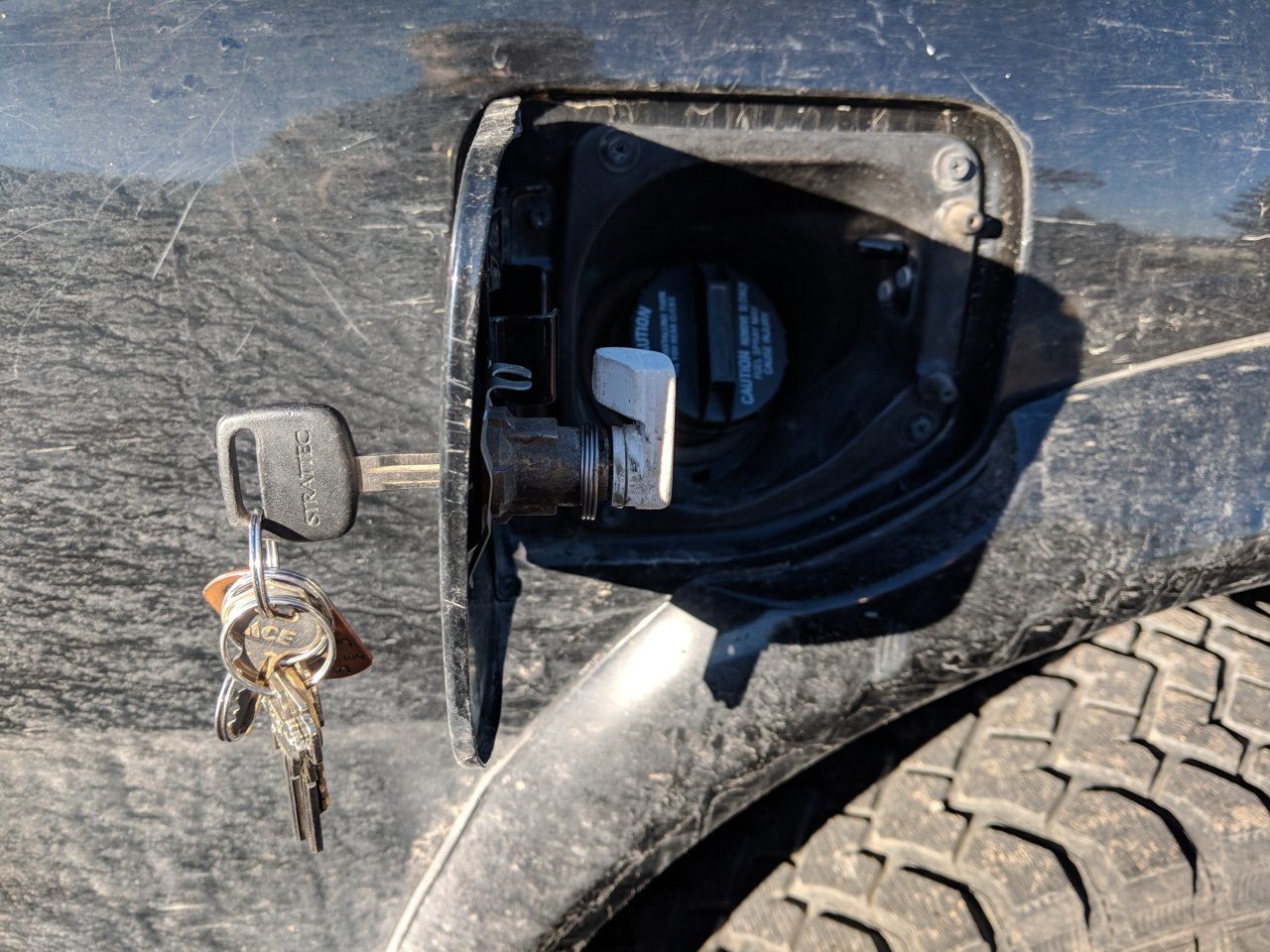

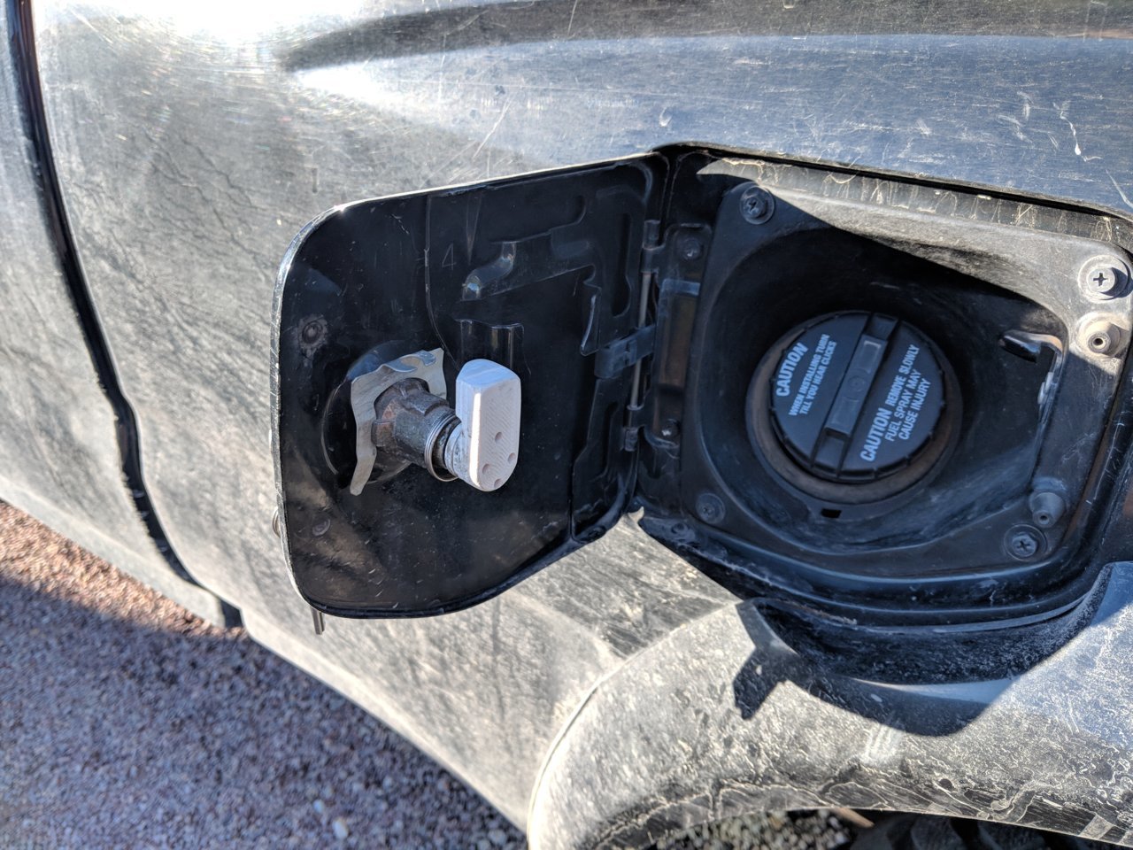

    (I should note that I had the early style of the locking arm which was a lot skinnier than the one pictured. The one pictured is the style of locking arm used in later 1st gens. They're all intercompatible)
    Here is the style of locking arm that was originally on my gas door:
