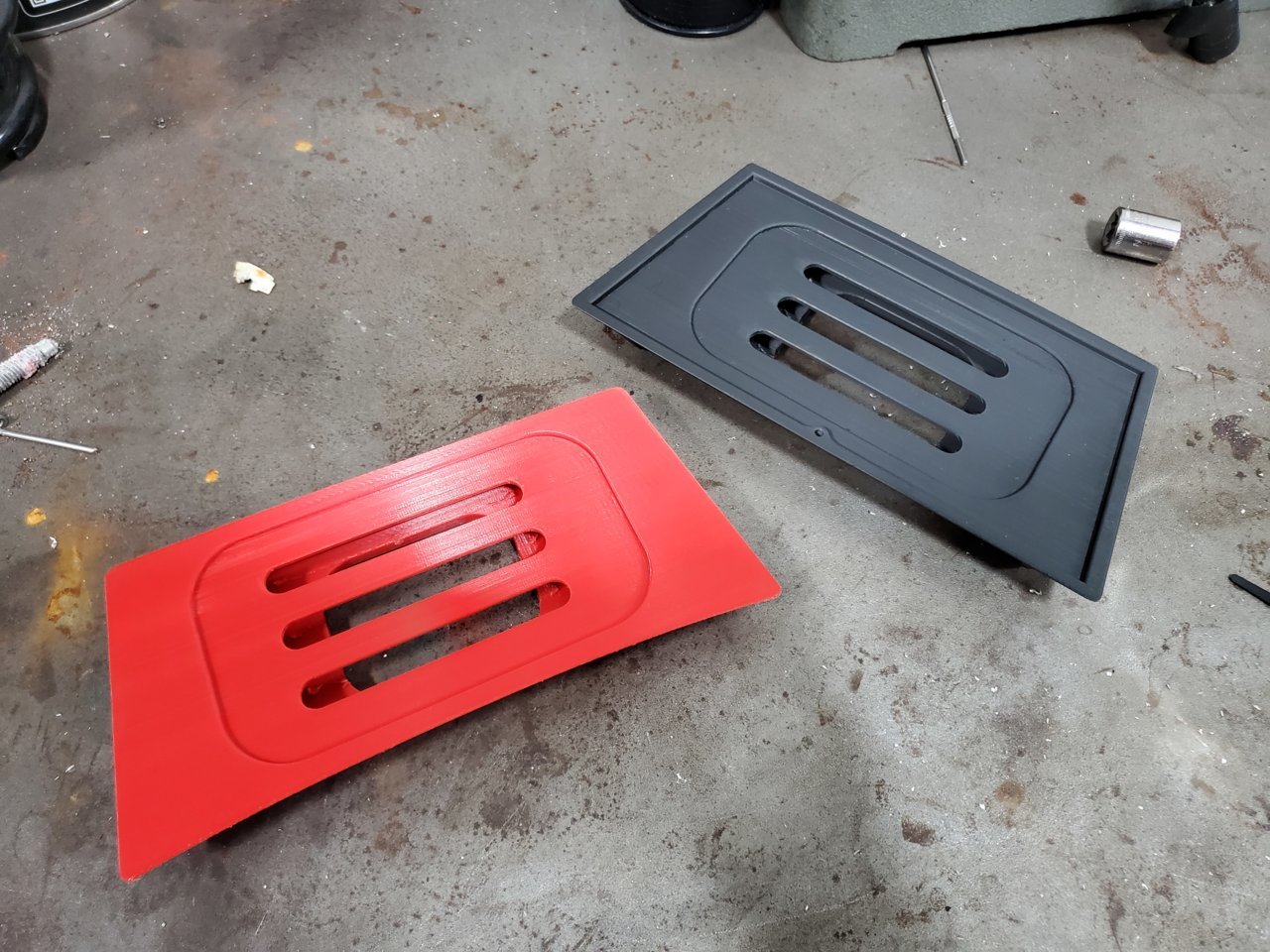

    Just wanted to share this quick comparison shot of the MT and AT. The Sriracha special on the left is the manual and Black one on the right is the auto version.

    Haha the red does look pretty cool but unfortunately it's just a test a print, it's not the right filament.

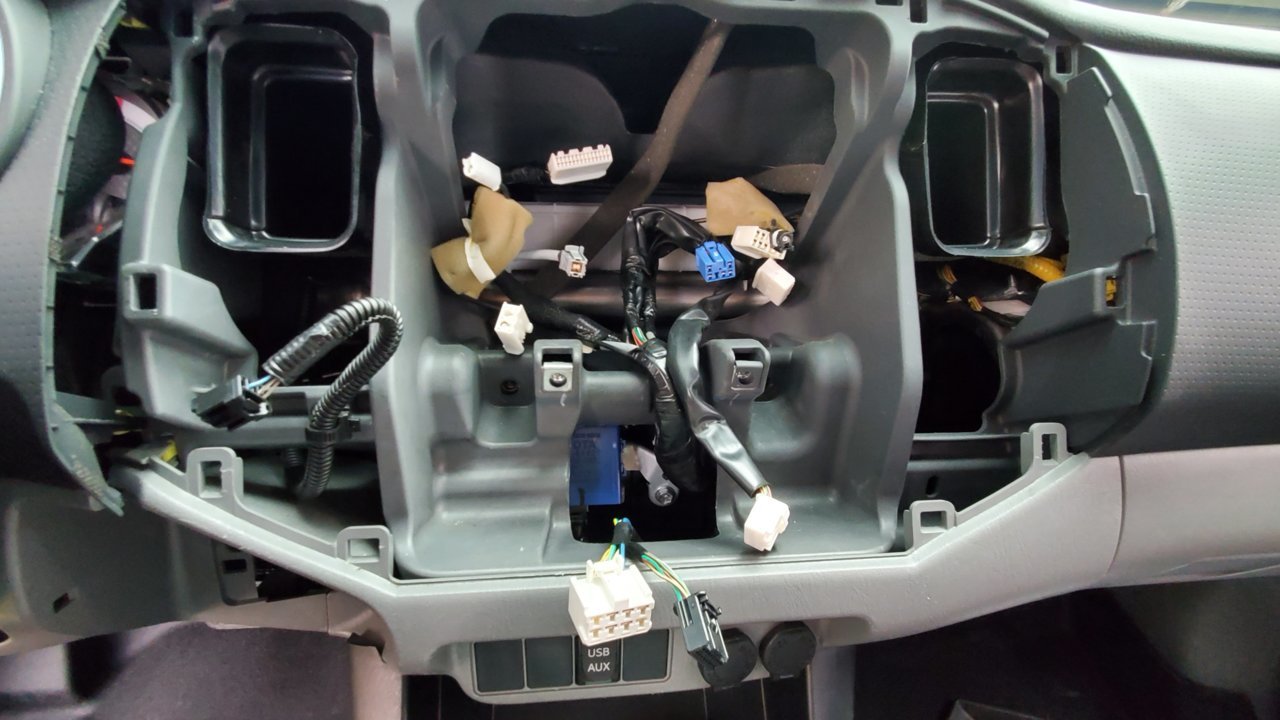

    Here's the install for the bezel, while stopping to take photos and what not the entire install took me less than an hour. There's other ways to get to those wires, this is just the way I did it. Please note at the time I took these photos I was using a previous version of the bezel. So this install doesn’t show the led on the bezel except for in the final steps. Disclaimer: Install at your own discretion, I'm not responsible if you break anything or if your truck implodes into another dimension.
    What you need:
    • 10mm Socket + Wrench
    • Pliers
    • Unibit + Drill
    • Trim Removal Tool
    • Small Flat Head

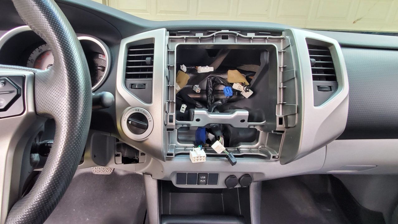

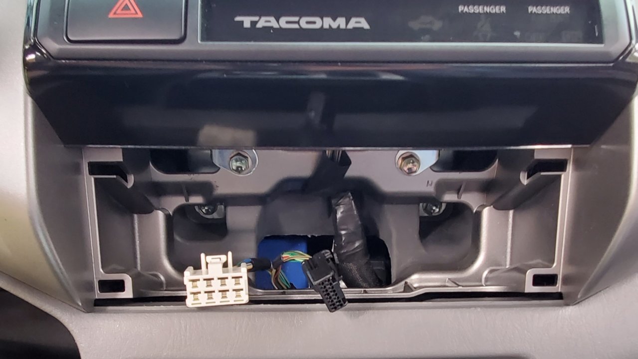

    1. Remove and unplug A/C Controls which reveals the Two 10mm bolts holding in the radio.
    2. Remove the Radio and the surrounding black bezel as well as the coin tray to the right of the steering wheel.

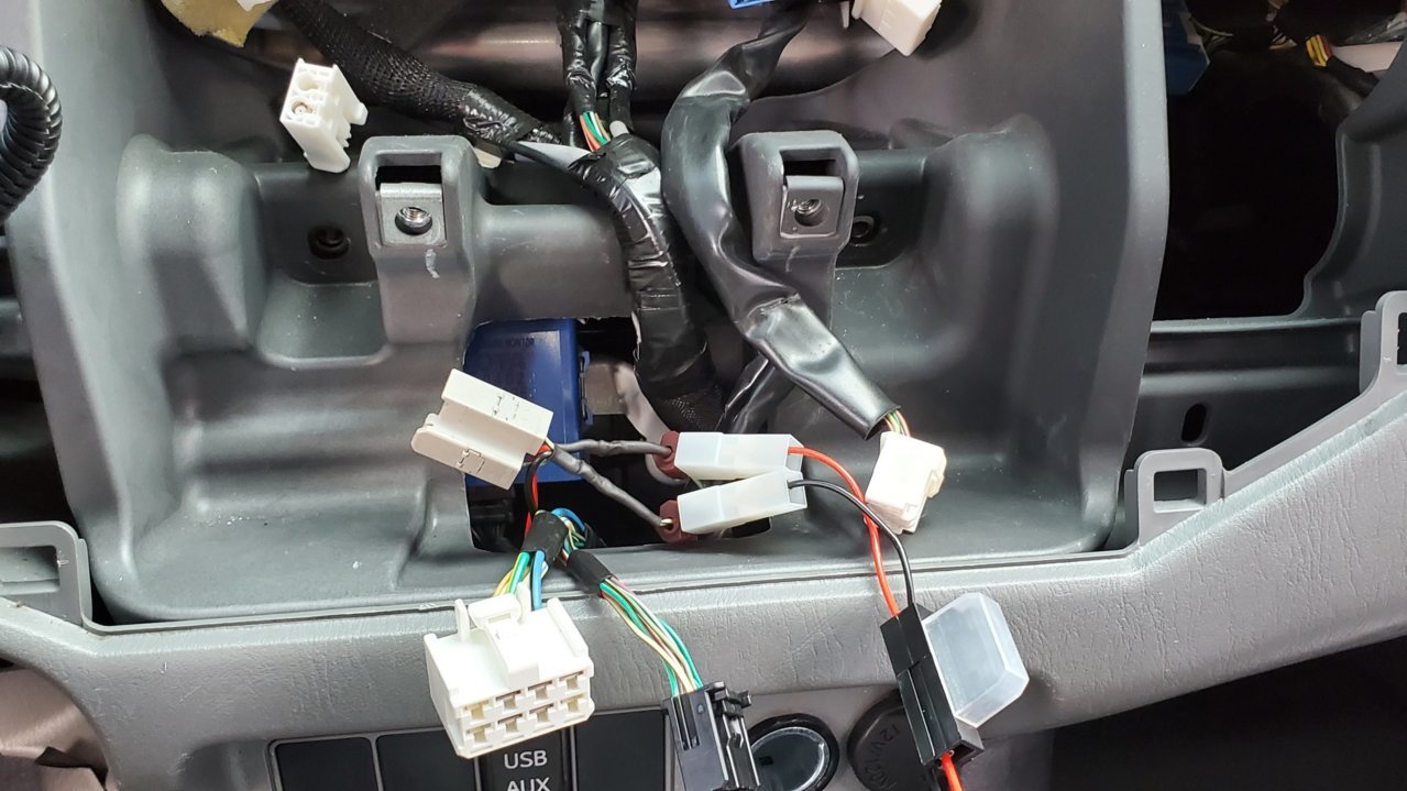

    4. Unplug the plug from the backside of the cigarette lighter, I used the left side one. Using the supplied maroon T-Taps, tap into Switched Power (Green) and Ground (White with Black). Next using the supplied wiring harness plug the connectors into their coinciding T-Taps.

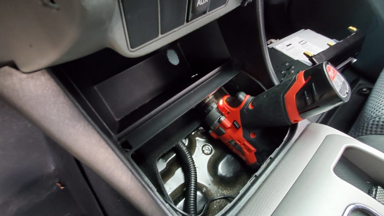

    5. Next you will be drilling a small hole for the cable to feed into the cubby. Start by removing the cup holder pocket by just pulling up and unclipping. In the photo I drill the hole on the right side of the cubby but it is best to drill on the left. You just want to make sure the hole is hidden below where the charger sits. Run the harness down the left side of the dash and into the cubby.

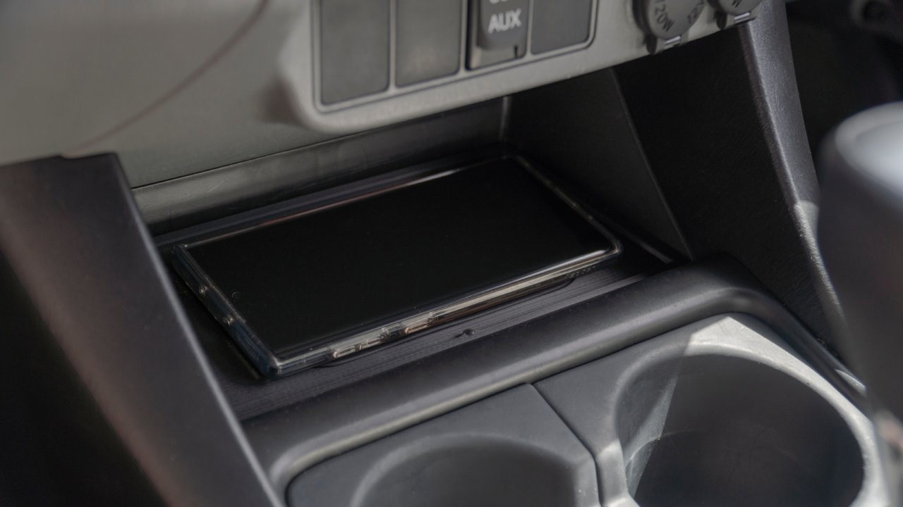

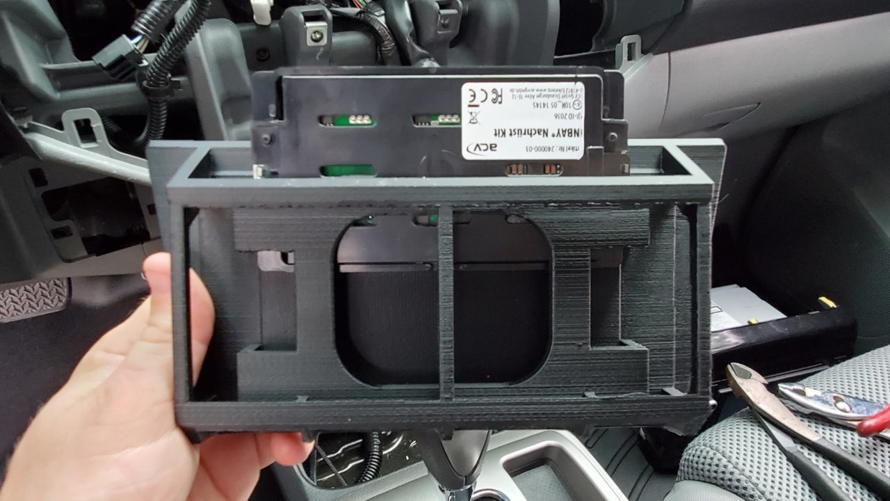

    6. Remove the tape that’s attached to the top of the charging unit and slide it into the bezel with the plug for the power cable facing the drivers side. This will place the led towards the front of the bezel. (I have it opposite in the picture)
    7. Plug everything in and put everything back together. Enjoy your new wireless charger!

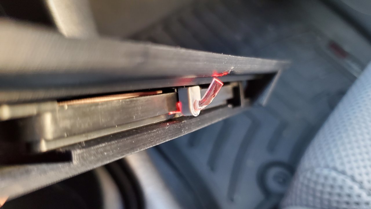

    *** Attaching the LED portion for AT Trucks Only ***

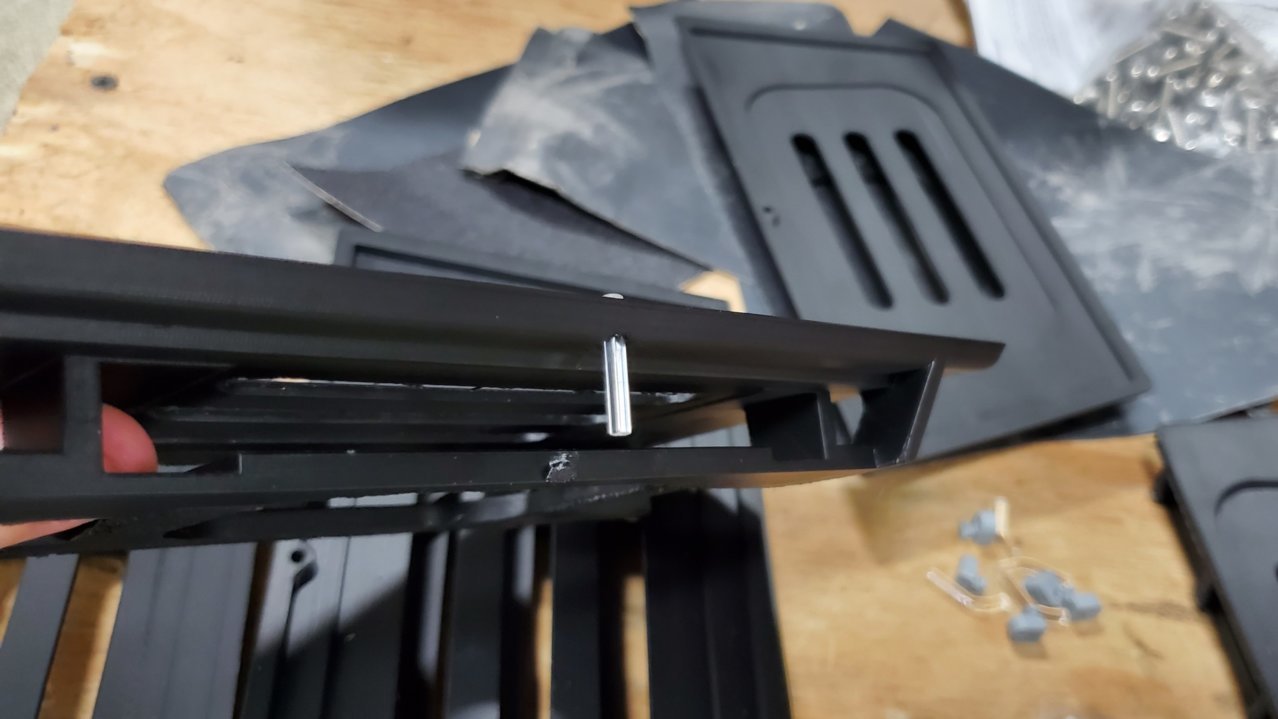

    Note: These come unfinished so if you’re planning on sanding down and painting the bezel you’re going to want to do that first before adhering the mat down and gluing the acrylic piece for the led in place.
    8. Slide the straight acrylic rod through the hole, it's going to be a tight fit (That's what she said) The top side will have a slight dome on it. Your going to want to trim the rod so it sits flush with the bottom side of the bezel.
    9. Before inserting the charger in the bezel attach the gray piece to the front led spot and slide the curved acrylic rod like pictured below. It doesn't have to be exact, it just needs to point towards the bottom side bezel hole. (If the rod needs to bent in anyway it can easily be heated up with a heat gun or lighter and reshaped)
