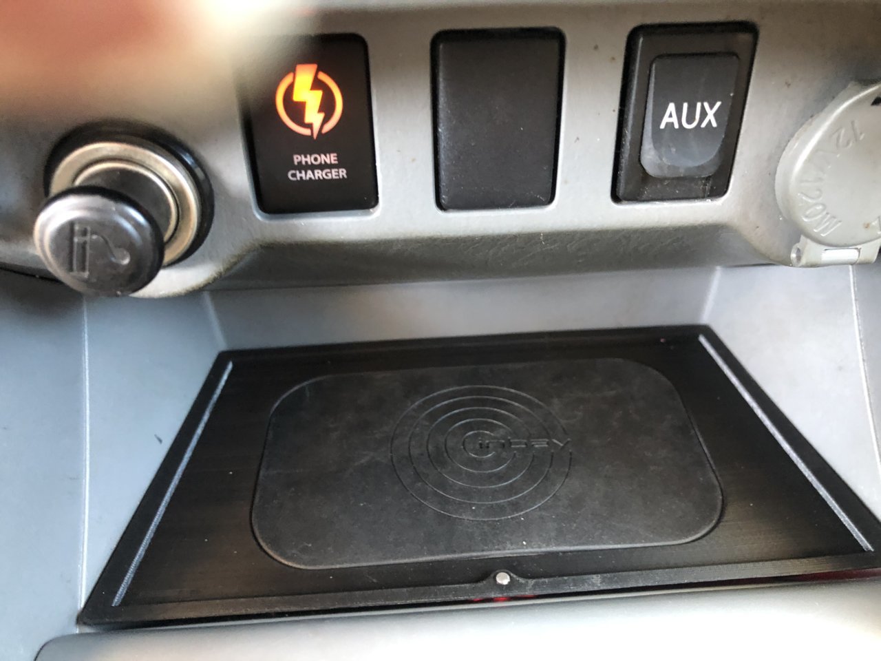

    finally installed! added the switch
    Forgot 1st pic lights on. 2nd pic just power on.

    GRNT4R, Camby, tomwil and 5 others like this.

    Nice job!!!

    Looks great! Really like the switch.
    Is it possible to get the link of where you purchased the switch?
