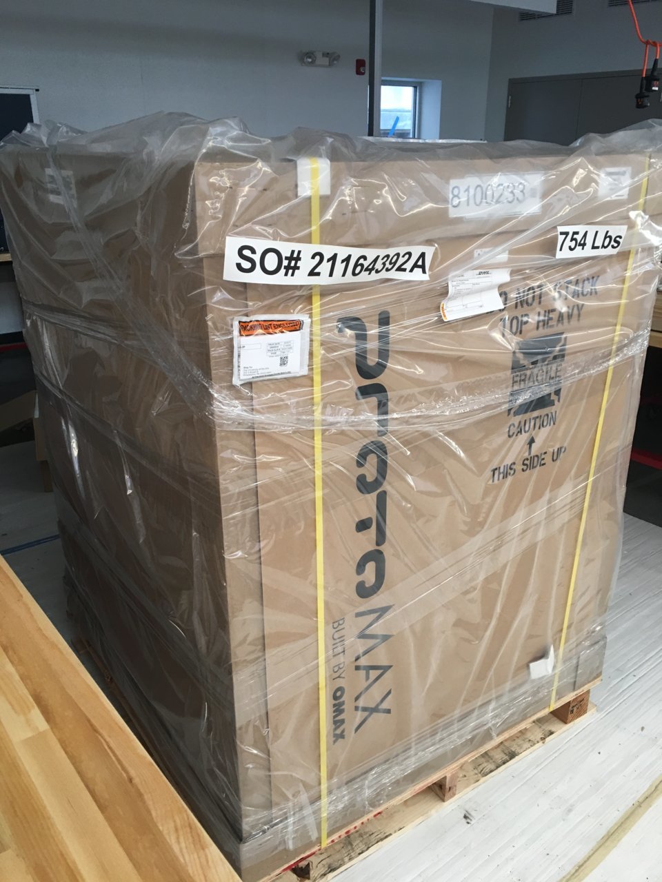

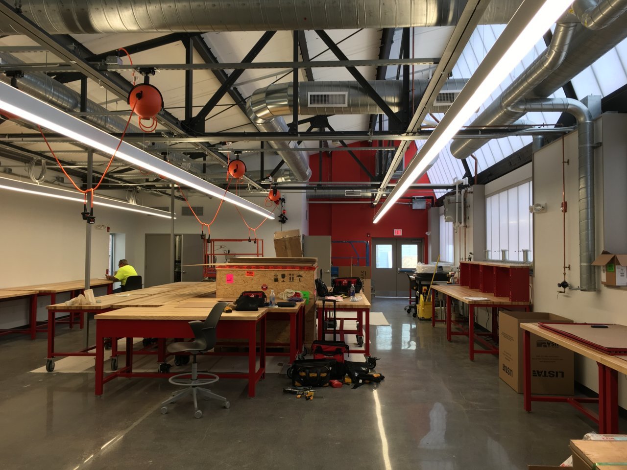

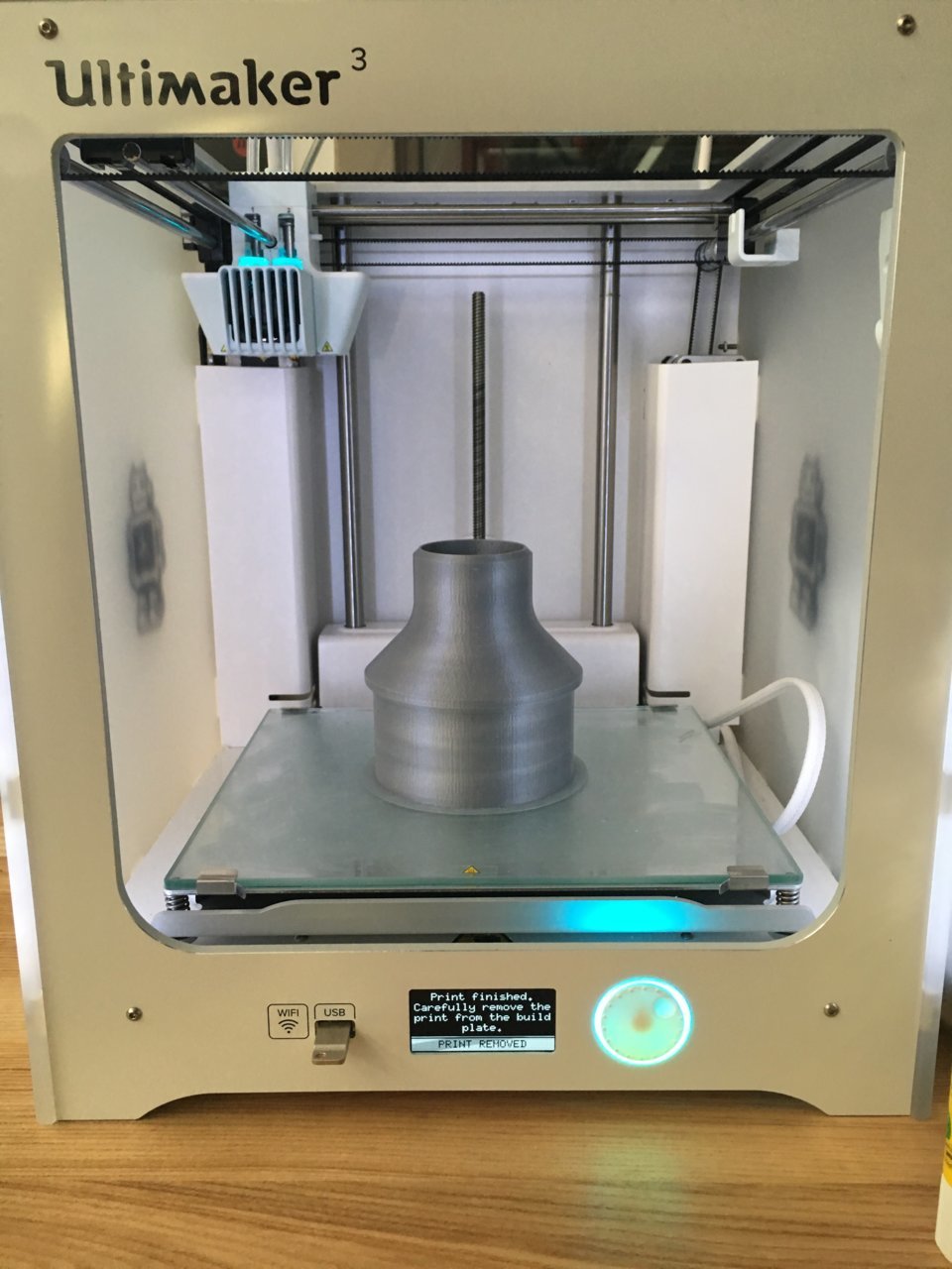

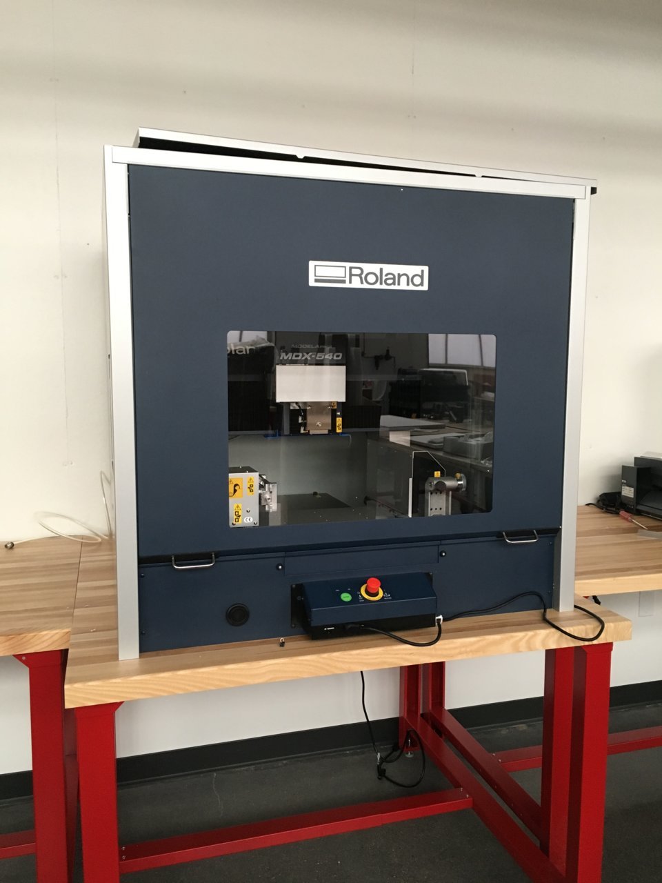

    I work with all of this stuff for a living. I moved to Philadelphia in November 2017 to build a "Makerspace" at the University of the Arts. I got to help pick out equipment and plan the space. I even designed most of the space using Rhino 3D.
    Even got one of these miniature waterjets

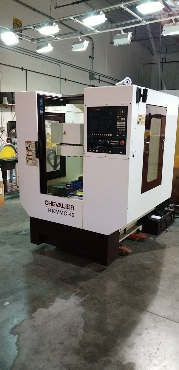

    I have a VMC and a rostock max 3d printer I play around with. Yes the VMC is a personal item. Program with fusion 360 for the cnc Simplify 3d for the rostock and model with fusion and solidworks.
    My work is also planning on adding a 5 axis waterjet to our inventory in the near future and they are handing the keys over to me :D
    Picture of the cnc. Apparently I have nothing of the 3d printer on my phone.
