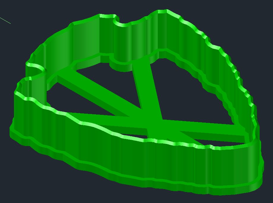

    Its a cookie cutter (obviously) but it appears to have a blunt cutting edge. Any way to taper the cutting edge? Doesnt have to be sharp, but more knife-like would be preferable. I think I could live with it if it cant be done.
    EDIT Of course, I dont know from the simple image just exactly how thick the cutting 'walls' are so maybe it doesnt even need that??

    For cookie cutting it probably doesn't need it, the more of an edge you try to put on it the more fragile the print will be also. I'll try printing one, if it comes out well you can have it if you cover shipping :)

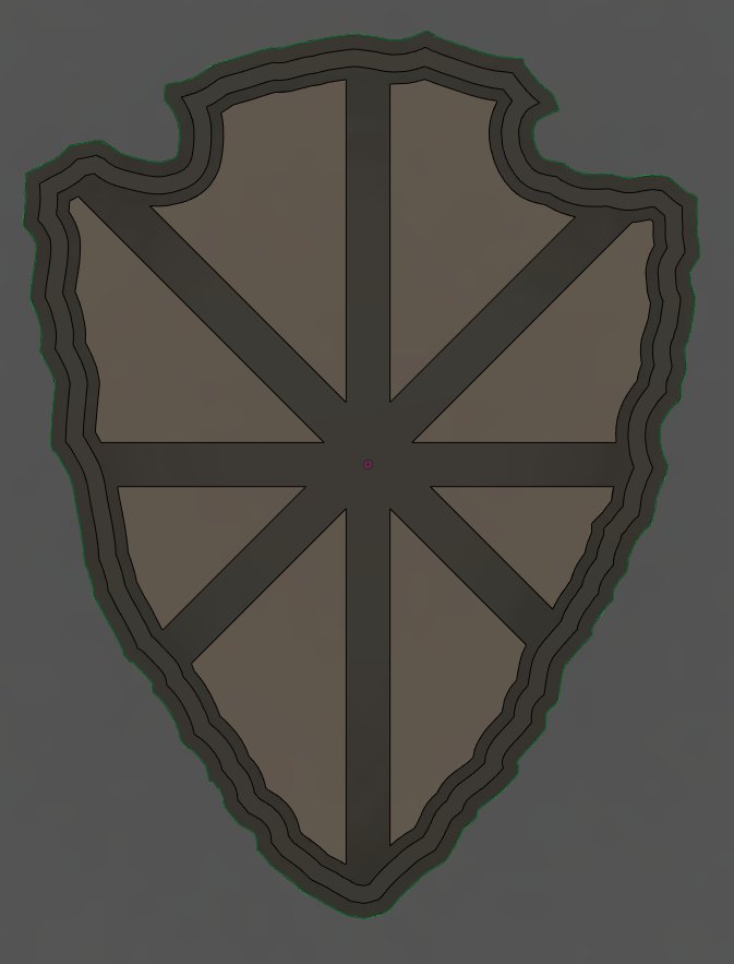

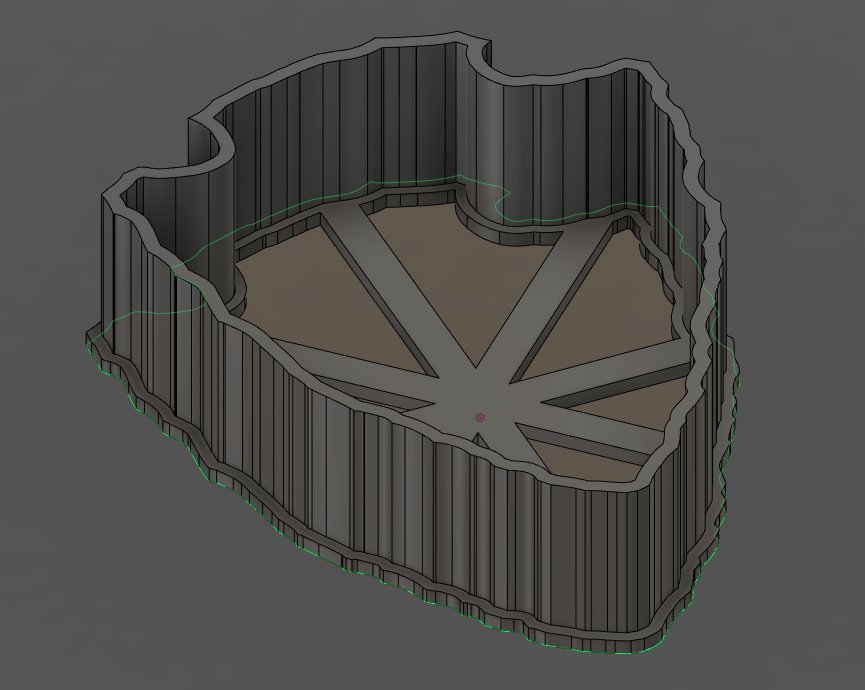

    So, I drew this up at 4" with a 1.9mm cut edge BUT the software is having some major trouble "sharpening" (chamfering) that edge because it's so complicated. I'll admit I'm not skilled/knowledgeable enough to work around it yet, but I'll keep digging just for my own curiosity. If anybody wants to tinker with it, just holler and I'll send it to ya.

    What program did you use to draw this in?
    You could do a sketch with the edge scaled inwards/or outwards, which ever way you want to go, then do another scaled outline about 1.5 times f
    Out side of the edge. The do an extrude/cut with a taper.

    Maybe soften some of the corners and sharper edges and it might let you put a chamfer on it. It is a cookie cutter after all...

    I imported a vector into fusion 360 for it. I suppose I could try to edit the vector first to smooth some of it out, but I've run into the issue before with them being too complicated to chamfer or loft and still haven't found a way around it :(... still just above my pay grade it seems, LOL
    Edit: maybe I should just go old-school and print this bad boy out as is, then sand it down! The inside edge is all that matters for the cookie shape, right!?
