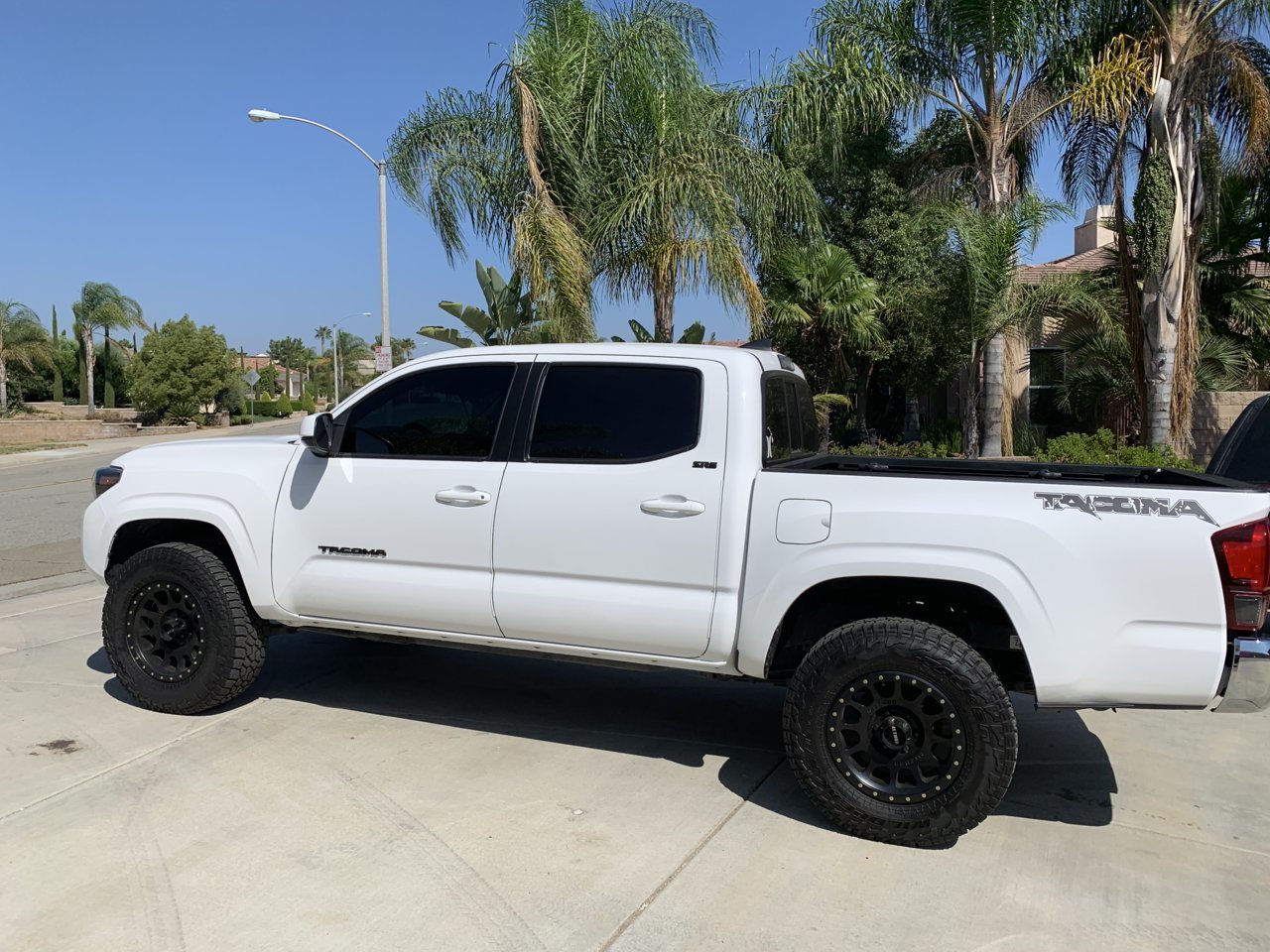

    I was on the same boat! I’m rolling with 265/70/17 Falken Wildpeak AT3 with Method NV’s on stick suspension and there is no rubbing at 41FD116A-6C10-42C4-91E6-09A7FE14D501.jpg all!

    Very nice, i'm running the same exact tires and will be getting new wheels soon. What offset are the wheels?

    I like this look a lot, pretty much what im going for. Any offset? If so can you post a pic from the front

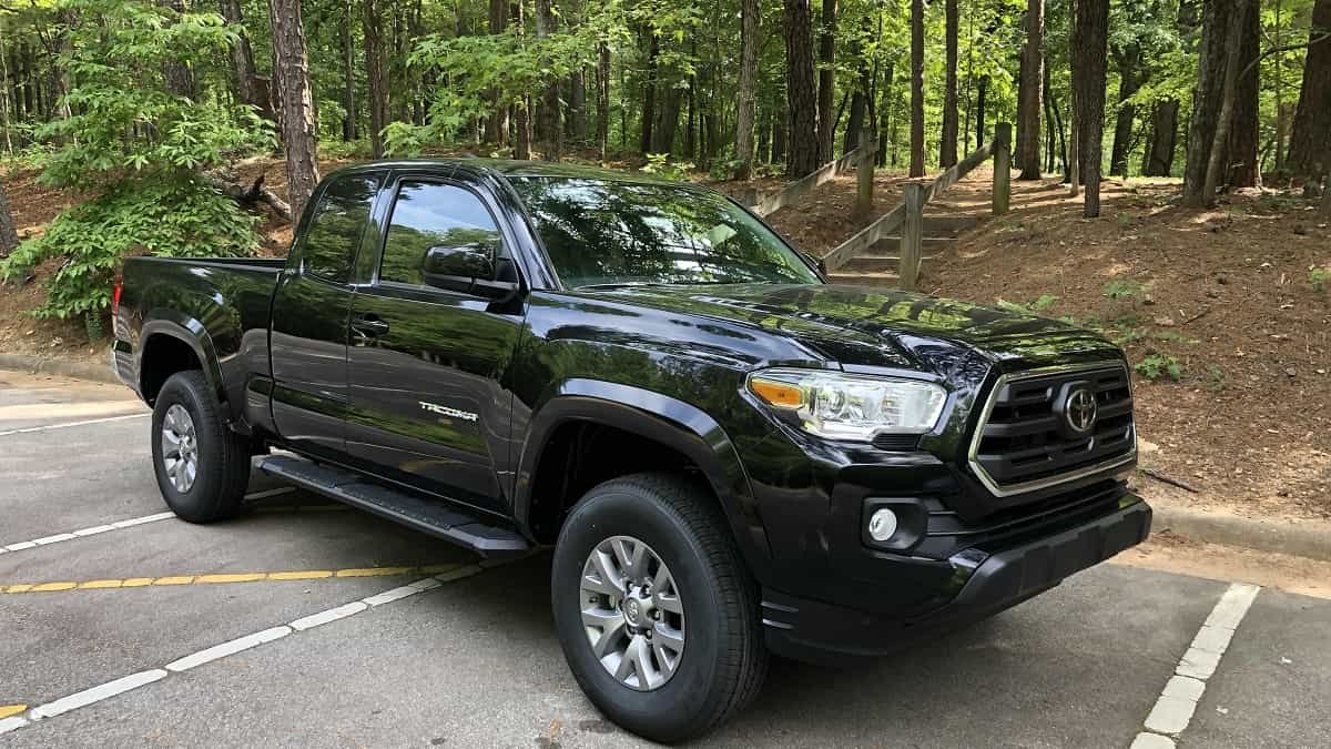

    Here is a 2019 SR5 for reference. Subtle differences from the SR.

    Heck yea it will looks great! And the Offset is 0, I like how they look.

    There is no offset so it’s a super clean look in my opinion. If you want a shot from the front let me know!

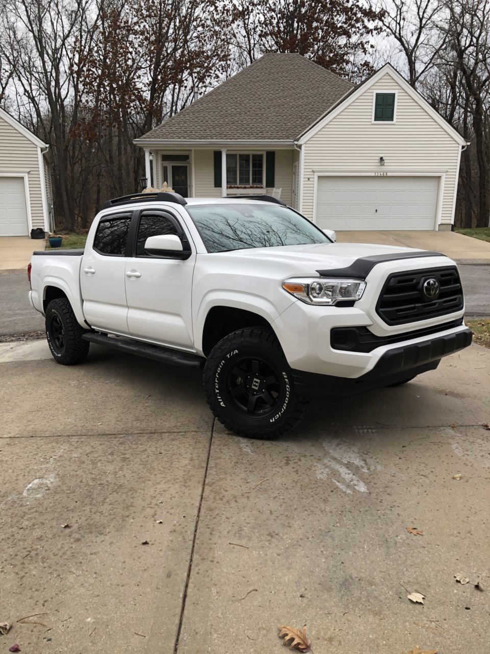

    im running 265/70/16 bfg ko2
    Rims are lvl 8 mk6 i think they are 16x8.5 or 8 with -10mm no rubbing at all. Hope this helps
