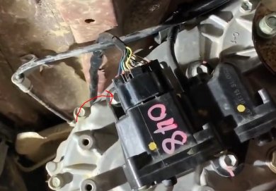

    I’m planning on running a NW fab doubler on a third gen taco. In order to run this, the marlin box, or any other doubler you need to extend the transfer case harness (amongst other things). Most folks cut and solder the wires longer to do this, but I’m interested in making a harness extension instead of cutting factory wiring.
    I’m having issues identifying the correct connector that is used on the transfer case motor box on the wire that needs extended. The connector is seen in this screenshot from TacomaDads YouTube video on the Marlin box install:

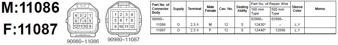

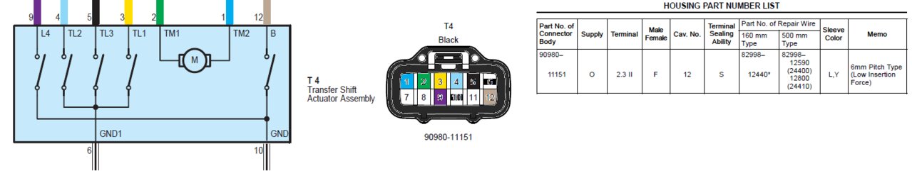

    The 12 pin black connector that plugs in to the transfer case actuator is this
    Gonks[OP] likes this.

    Damn you guys are good. Now, to try to find the make counterpart plug. Apparently that connector is also used on the ignition switch!

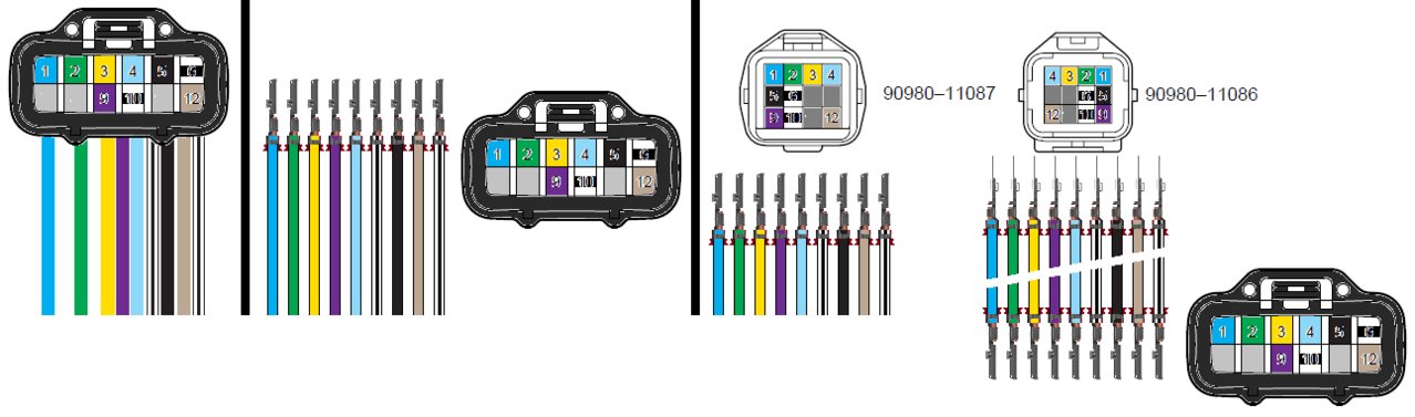

    That's going to be very difficult. I suggest you learn to de-pin the connector, get sealed mating ones then extend the wires and reuse the T4.

    I suppose my hesitation is because if I need to re crimp pins in the 11087 female connector (cut wires if I Bork it), as opposed to cutting and soldering the wires that currently exist, it seems to me that I just have added more work to get to the same solution… not having avoided cutting up the original wires.
    I guess I just need to weigh crimping versus cut and soldering. If you were to do something like this, on a wire that exists under the vehicle and will be exposed to moisture, what would you recommend doing?

    Not a fan of solder where movement is involved. The terminals in those connectors are the sealed kind. Even the connector has a sealing ring.

    That's why I recommend de-pinning...make added harness as long as needed.
