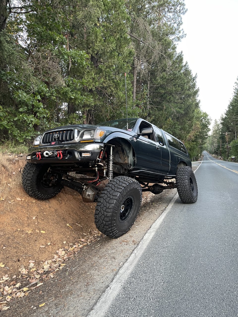

  17. Oct 2, 2023 at 9:00 AM
    #17
    03tacodude
    03tacodude [OP] Active Member
    Aug 22, 2023
    #431849
    39
    03 Taco on Tons & 40's
    they are 14’s going 16’s next year. But will be throwing them thru the fenders and bed. Hoping to be sitting about 1.25 inches lower than I am currently.
