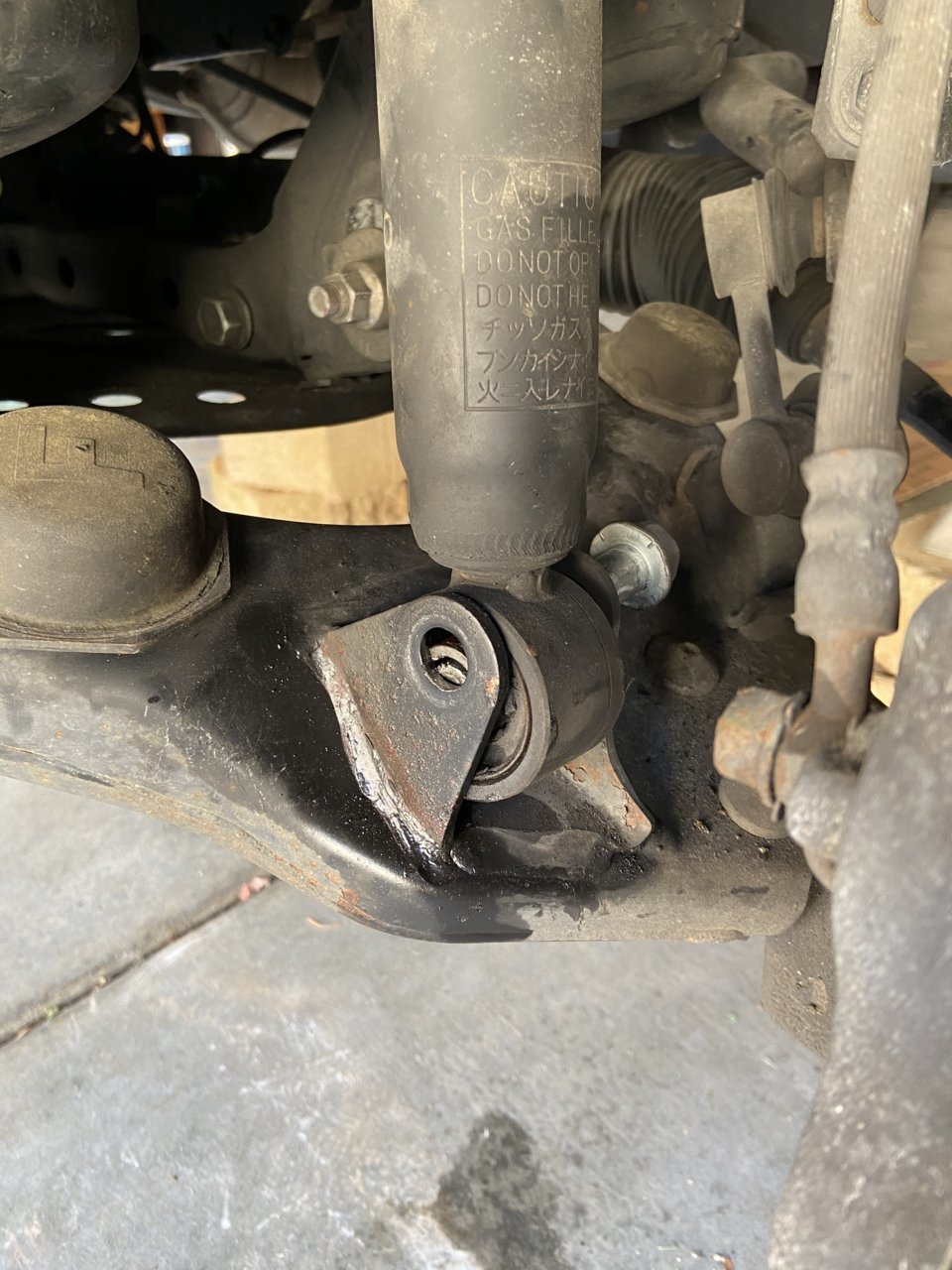

    So I have a 2002 Tacoma v6 rwd and I’m putting on a 3in lift spacer for now. I tried to install one before but I couldn’t because my strut was too long. I don’t want to take apart the uper or lower ball joints but I want to be able to get the lift in. When I try putting back the strut should I just push real hard on the lower control arm so it can go down a little. Or what should I do. I have a pic on what I mean about it being too long.

    Use a jack under the lower control arm to push it up or if that fails use a bottle jack between the upper control arm and the body to push it down, use a block to distribute the force so it doesn't completely screw up the fender well.

    Without disassembley you don't have alot of options.... could try a combo of both jacks. If you could expose part of shock hole then you could, from the opposite side, insert a spud tool (like a pointy round chisel but much longer and beefier) and pry up enough to get the bolt pushed in. Then hammer the bolt home and hope the threads don't fuck up on the way through (depending on how much tension is on the LCA)

    Get a long pry bar between the bottom of your shock and your lower control arm and pry up till the holes line up and slip a bolt in. When I did new coils on my 4runner I had to have my wife stand on a long pry bar to be able to get a bolt to go through. It was more then I could do by myself.

    You’re short half an inch
    if you push down on the caliper/hub area is there any vertical motion?

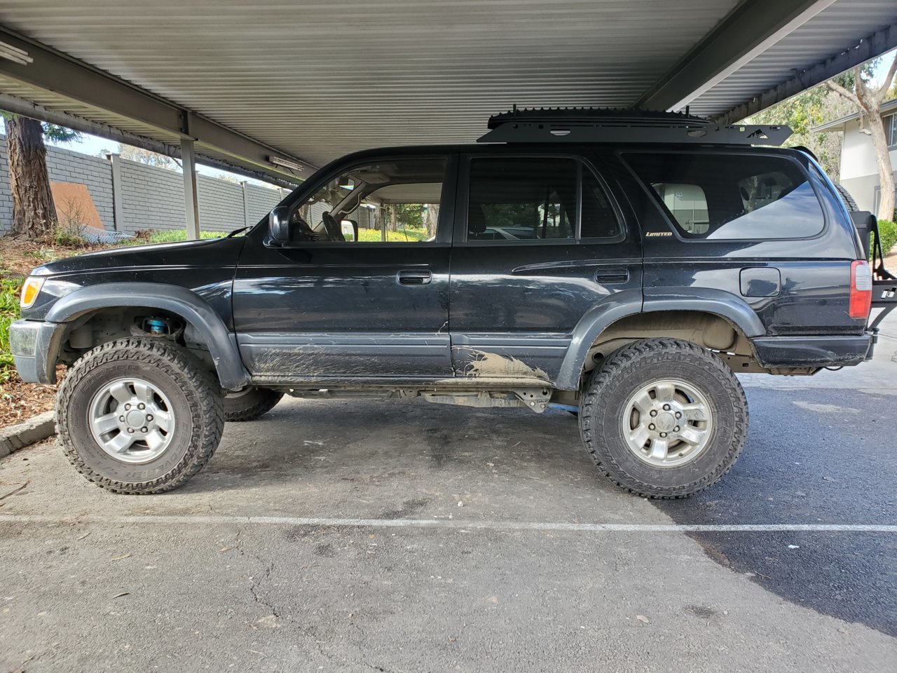

    What lift does that white Tacoma have.
    CygnusX191 likes this.
  20. Feb 19, 2021 at 5:22 PM
    #20
    JKO1998
    JKO1998 Well-Known Member
    Jun 2, 2015
    #156578
    53,031
    Utah
    Faded flares and brown center caps
