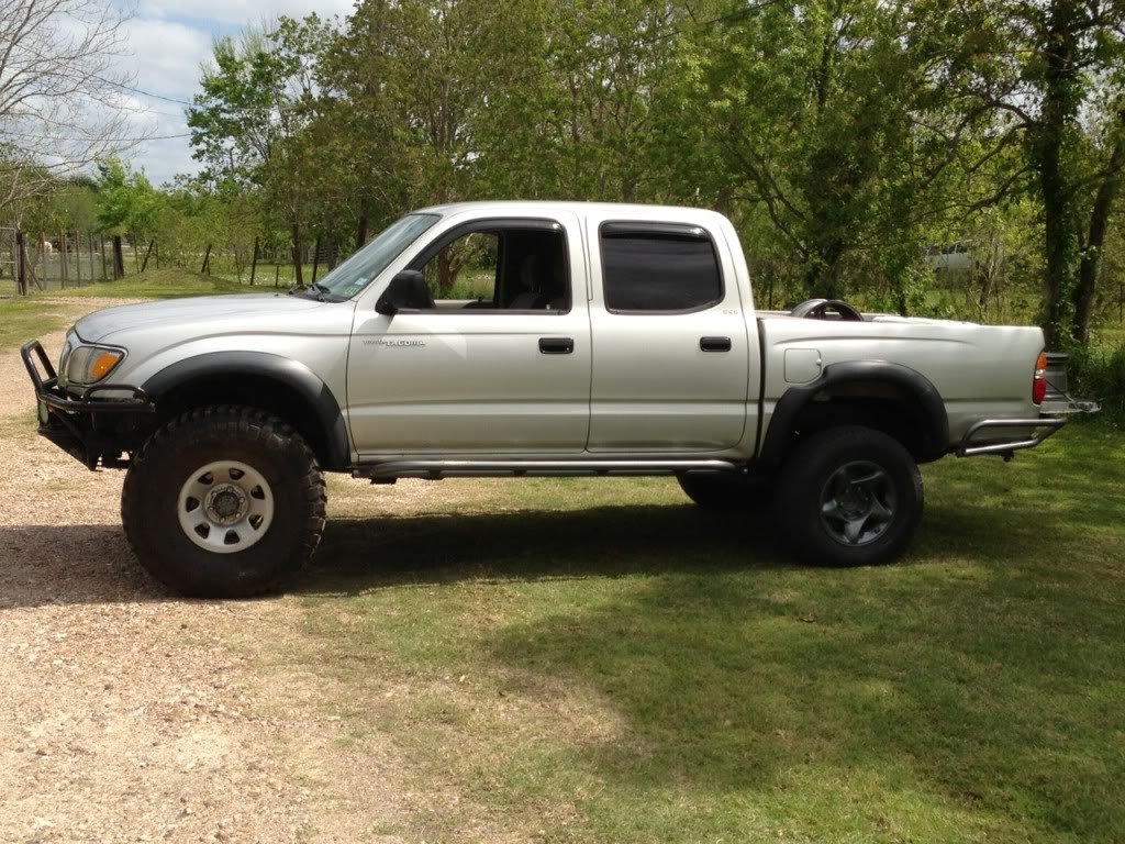

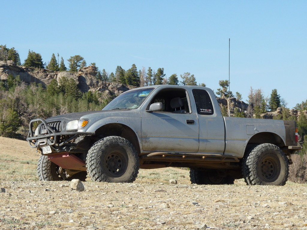

    pics of truck?

  7. May 20, 2013 at 4:08 PM
    Madjik_Man
    Madjik_Man The Rembrandt of Rattle Can
    Dec 2, 2009
    #26893
    19,725
    Colorado Front Range
    1998 Ext Cab 3.4 4x4 TRD 5MT, 2004 DC 3.4 4x4 TRD
    45acp's
    He trimmed a lot though.

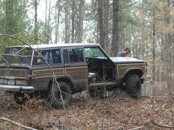

    I had 35's on my Jeep with Waggy 44's front & rear and 4.5" lift. I had a 1" body lift, trimmed fenders/flares, and ford shock towers...... all that to allow the SUA to flex without hitting.

    Test fitting 35
    421BD895-187C-40AA-AFC5-2117F3908EDF-124_bb9f8c9e439036f799e6fba40f831539ac107b07.jpg
    FB783BEB-DC1D-4069-A950-7353CA661215-124_dcb9cd4831eb30b19d4e98f1c66e8f03a8fb4349.jpg
    Here's another guy with 35's
    X2
