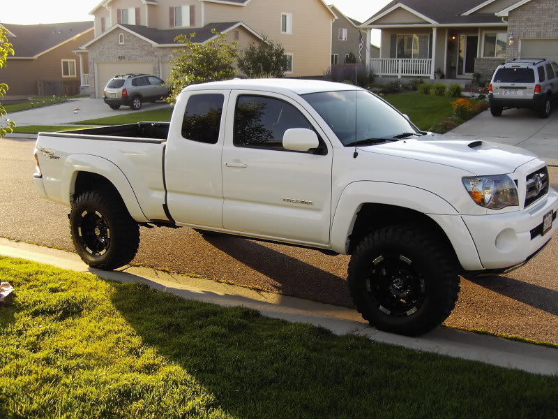

    Bilstein 5100 shocks set at 2.5" (not quite 3" but hey") and a 1.5" AAL
    This will allow you to run up to a 285/75/16 (with mild trimming)

    Here's some pics of Tacomas with Bilstein 5100s set at 2.5" with 1.5" Add a Leafs
    285/75/16 KM2 MT Tires
