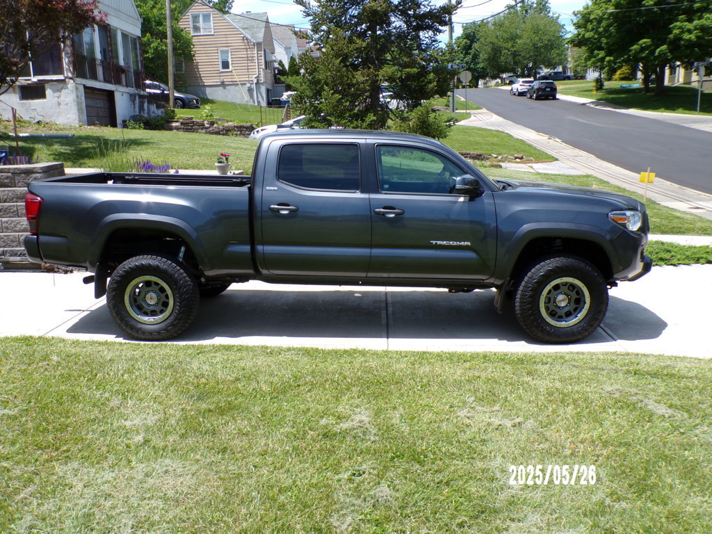

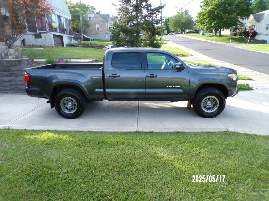

    Eibach Stage 2 Archive Garage MD 265/75R16
    Don't know if this helps you or not but I just installed an Eibach stage 2 coil over set on the front and Archive Garage MD springs with Bilstein 5125s on the rear. I believe the Eibach coil overs will lift the front a max of 2.75". I haven't adjusted mine up but got around a 2" lift out of the box. The Archive Garage MD springs lifted the rear 3". I also changed out the front axle bearing with a ECGS bushing. I'm running TRD Beadlocks with Nitto Terra Grappler G3 265/75r16.
