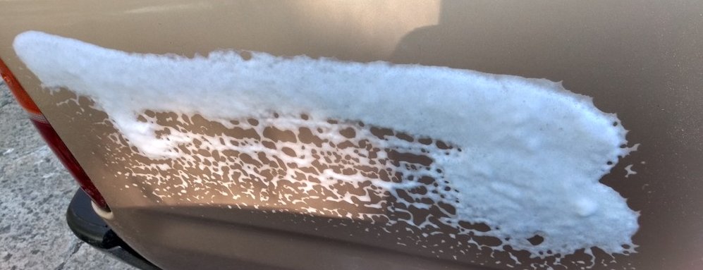

    Bud and Tar Remover for adhesive residue.

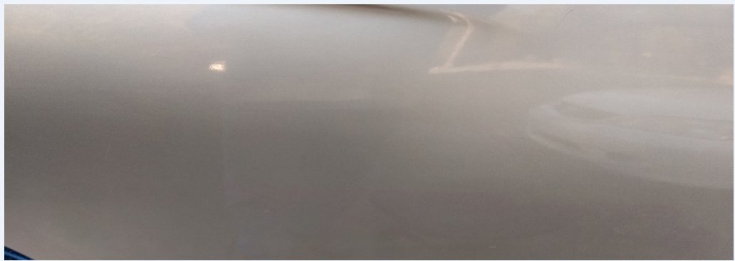

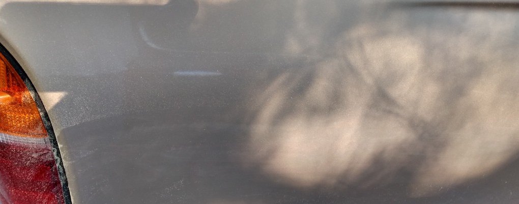

    After. Note the ghost image. I used an identical decal to cover the old area.

    Great photos, thanks. The "ghost stripes" can be difficult to see, which is a good thing, and even more difficult to capture in photographs.

    I think it will be about like what I saw on my gold. It sat outside in the Texas sun for many many years. The ghost of TRD appears in the 4th picture above.
