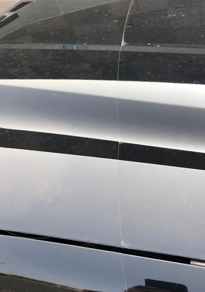

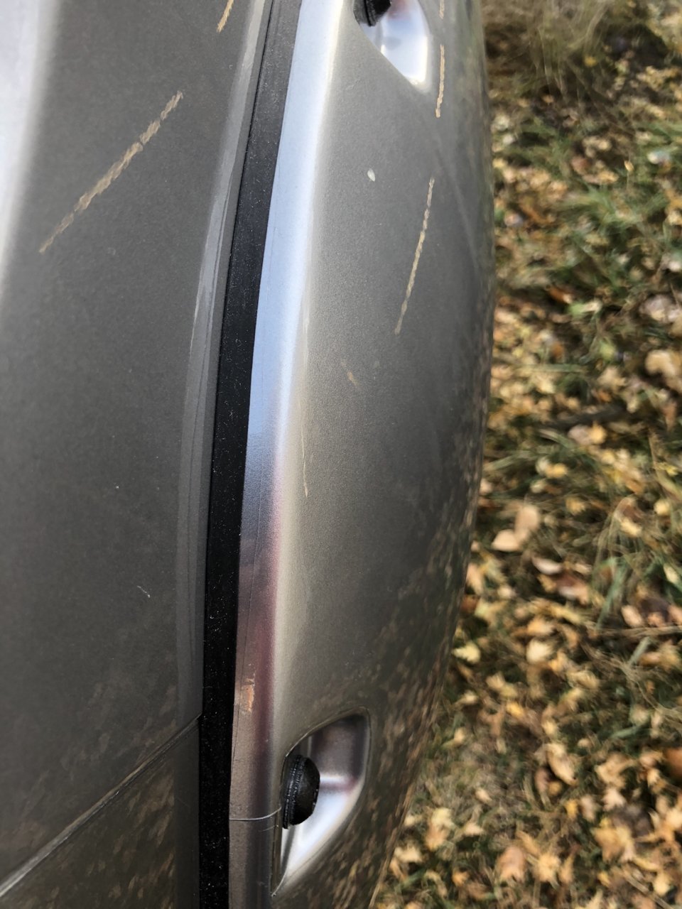

    My truck came cursed with this 3M Gold paint protection film (clear bra) that I'm disliking more by the day. The film edges stand out after some rain and help accumulate dirt between washes -- I'd rather have it gone. Anyone willing to share their experience removing this... stuff?

    Removed the three pieces of awful front end plastic with the help of some hot sunshine. The stuff was strong and peeled off cleanly. It took some elbow grease and patience to pull off the large yellowing hood piece. Extra adhesive on wrapped edges came off with goo gone. Feathered out seam line with polish and wax and looks so much better.
