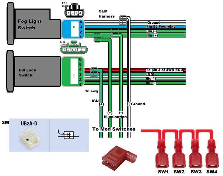

3M taps to OEM harness for IGN, Ground, and switch Illumination (+)&(-)

    Hood Struts, My version Fogs always ON, Map & Overhead Light Mod,
    That's if you have Differential Lock Switch....
