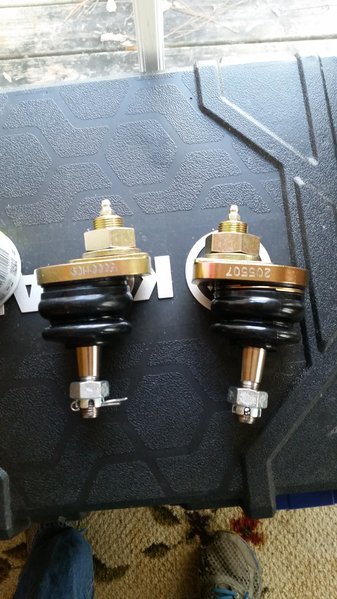

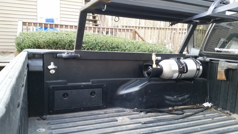

    20160212_172122.jpg 20160213_145624.jpg mounted co2 tank and Guinness bottle opener plus got new spc ball joints with grease fittings for my uca project.

    Gotta have it vertical during use don't you?

    From my research it has to be vertical to use because the co2 liquid had to be at the bottom of the tank. If you mount it sideways you have to unmount and stand it up to use it.

    Yeah it's got to be vertical to use. I couldn't find a vertical mounted area that I wanted and would save room so this was best spot for me.

    Cool just checking. Those daystar bumps at the bottom of the page the ones you got? I'm looking at wheelers super bumps or something similar.

    Yeah those are the ones I'm using. I didn't want to spend alot on bumps so these were the best bet, plus they are long enough to trim down if more up travel is needed. I wish I didn't cut them so quickly bc like a month later I went from regular bilstein 5100s to the b110s so I had to take some HMW plastic and make spacers to extend them.lol
