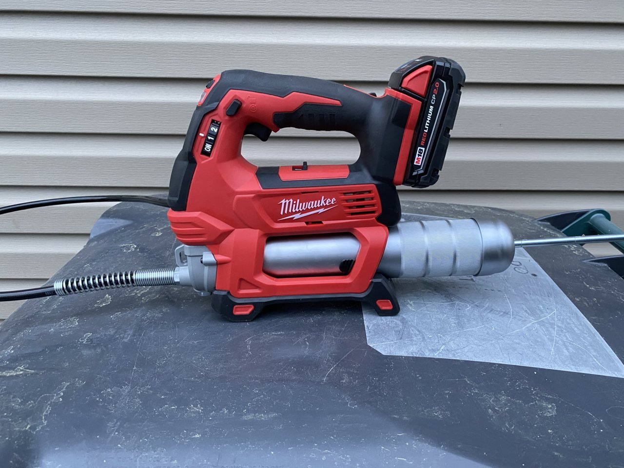

    I've got the M12 version and love it...skid steer has 18 zerks, makes quick work of hitting them all for sure!

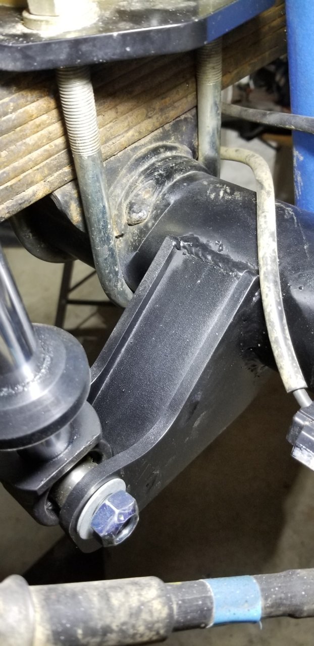

    Drivers side is done, just waiting for the paint to fully dry before I mount the resi. Passenger side should go quick now that I "know what I'm doing." The welds aren't pretty but I think they'll hold. I'll find out for sure in 2 weeks at Chris and Shannon's!

    Welds aren't as bad as you think. Better than my garbage!

    I'm my own worst critic. Plus out of position welding is harder than practicing on a bench, but overall I'm happy with them. They will definitely be tested!

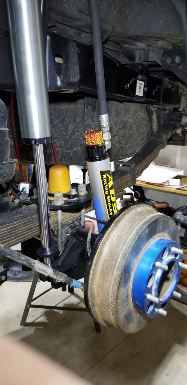

    I did notice the shock is about an inch longer fully extended than the leaf pack fully extended, so the leaf pack will essentially act as a limit strap.
