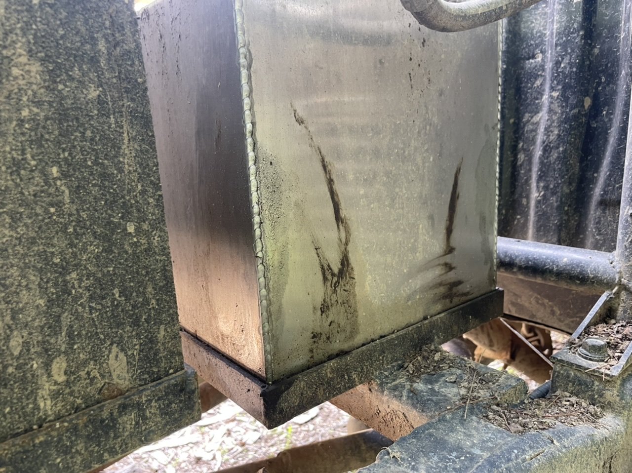

    Cracked another fuel cell :(

    Is it hard mounted? Wonder if you'd be able to extend the life by putting some rubber around where its held in
    One interesting thing about aluminum, is that aluminum doesn't have an infinite fatigue life. Whereas some materials like steel will be able to endure an infinite amount of cycles at XYZ loading. So if its vibrating a lot, then aluminum will eventually crack and depending on conditions, it could be a looooong time or a short time. Some rubber or something may help to lessen the affects of vibration and make life longer

    Yea this is tank #3 that has cracked at the welds. The other ones were different shapes and I thought the shorter seams of this cell would help. It does sit on a 1/2 rubber pad and has the same rubber on the mounting brackets so it’s isolated from the frame. I’m going to try a polymer cell, which means redesigning the whole setup again.

    Two words: cell cage.

    Yea the polymer ones have a cage or steel box they live in.

    Long travel suspension?

    Like put suspension on the cell? I like it!

    Yes. It's the only solution.

    I’d have to agree on this.. not sure what the compression rate is on valve springs (or something of the like) are. But 1 at each corner compressed some, and the nut locked down to the bolt so it doesn’t loosen might suffice. The only other thing I can think of is, mounting it to only one side of the frame so the torsional flex between the frame rails is removed.

    It’s currently mounted on a 1/4” thick steel 2x4, so i don’t think the mounting platform is flexing. I think I’m going try this one https://www.jegs.com/i/RJS-Racing-Equipment/140/3924801/10002/-1

    Does you current cell have any kind of baffling in it? Just curious. if not, is the fuel itself sloshing around at weight and that is the possibility of the cracks. I dunno after that.
