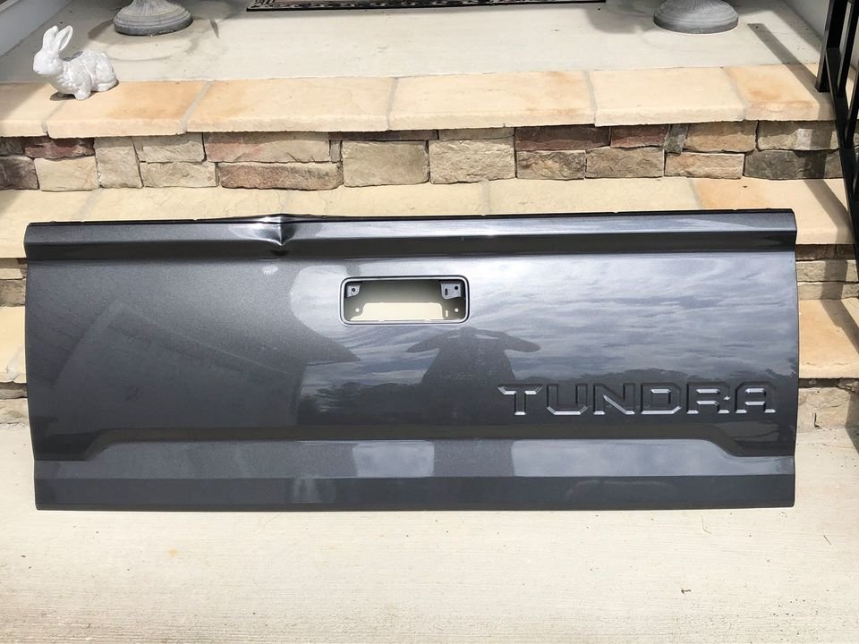

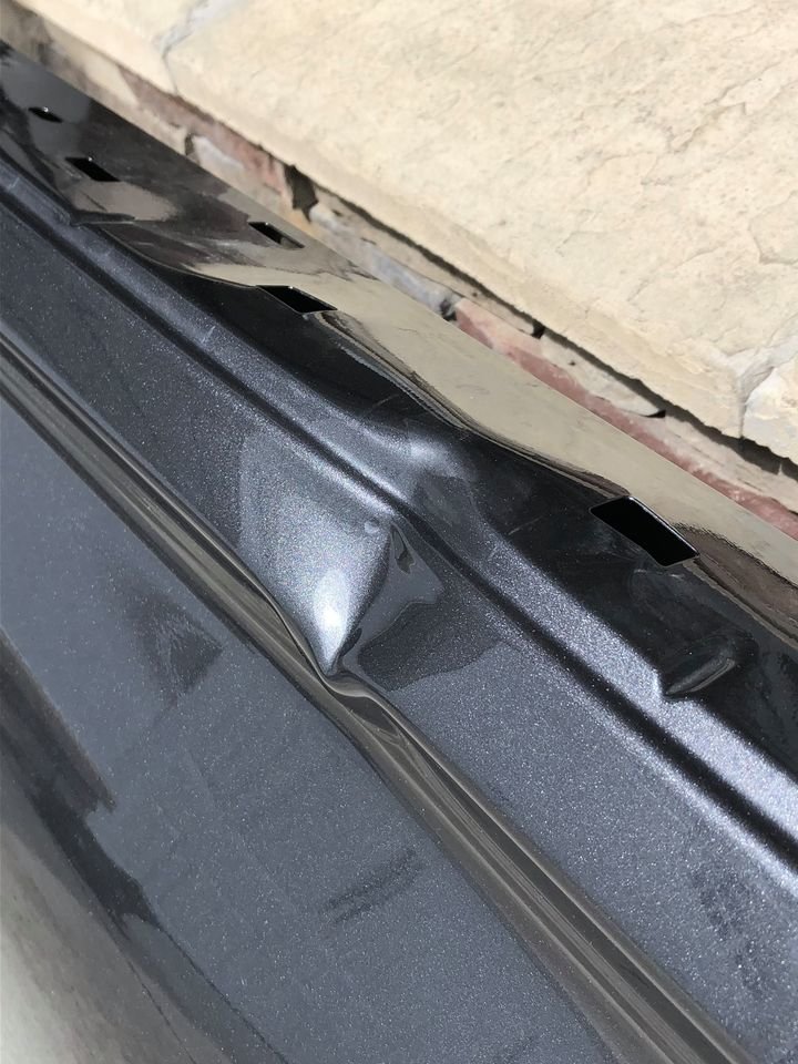

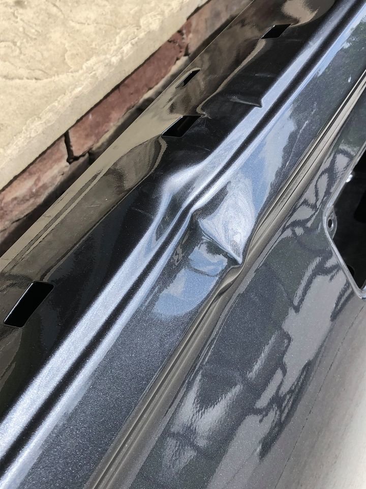

    I've got a PDR question for Chris. If course it's impossible to say without getting your hands on it, but is something like this fixable with PDR? Being right on two creases is what makes me so unsure. This isn't off of my truck, I'm just asking for a curious friend of mine. He destroyed his current tailgate and can scoop up this one for $150.

    That's worth it even if it can't be restored, at least in my nonrequested opinion :hattip:

    He's gonna buy it regardless, $150 is a steal. His current plan is to just cut out that section from his current tailgate and weld/blend it into the new one since he's a fabricator. I was just curious at the feasibility of it just being popped back out because that would be a much better repair IMO.

    The metal can definitely be reshaped to maybe 90%. The paint is under a lot of stress and has a good probability of cracking when it’s flexed in the opposite direction to be fixed. Its something I would attempt but not expect to be perfect. But that being said it’s definitely worth $150 and even if you have to put a little touch up paint on it
    is it aluminum?

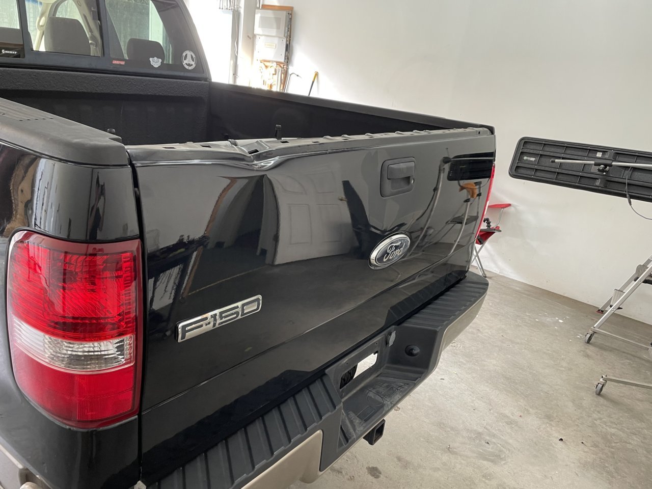

    This is a similar one, I’m looking for the after picC94AA5D9-05F1-4207-AD3A-A6C0A66E24AF.jpg

    He’s planning on repainting it white to match his truck anyways so that’s not too much of a concern, thanks for the input! I believe it’s steel.

    No problem! Steel will be easier to reshape.
