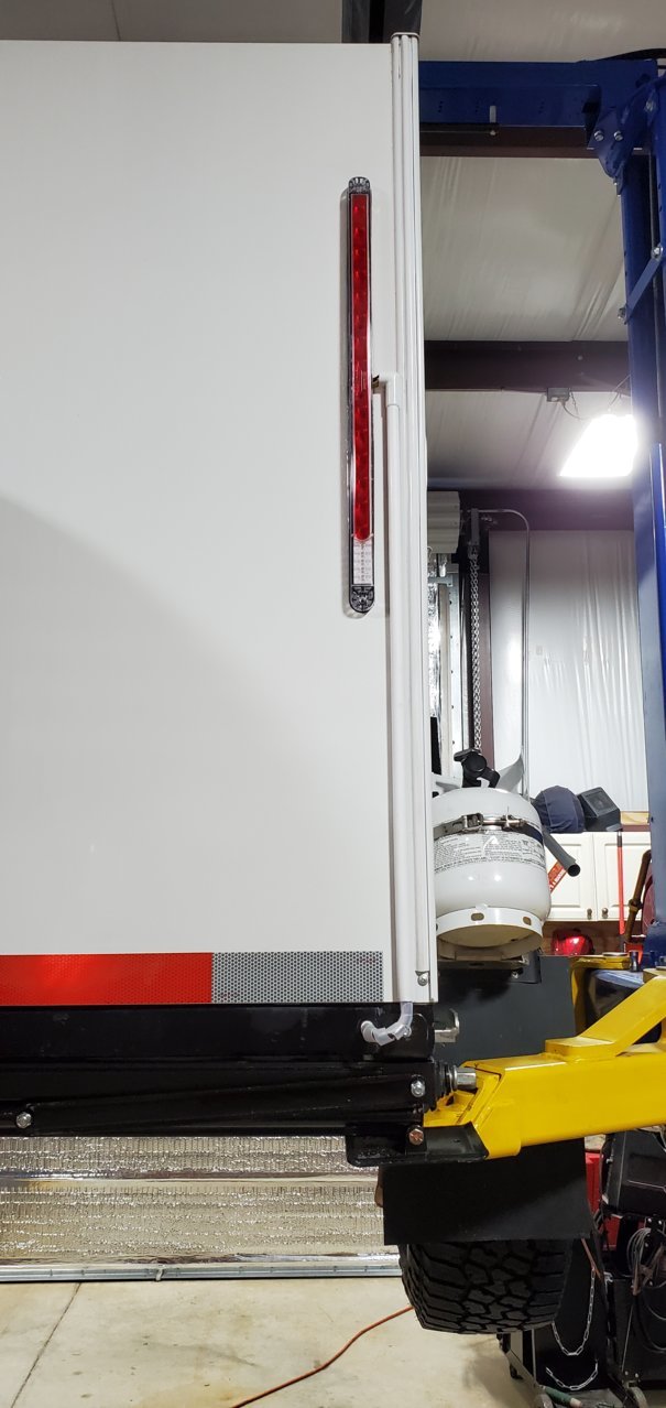

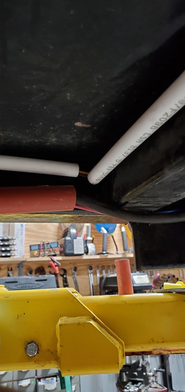

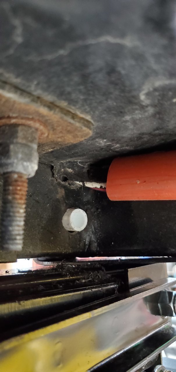

    Well if I can't get this wiring finished up before to late tonight or early in the morning tomorrow, I'll be throwing the hammock kit up (preferably vs. tent)...
    • Passenger side:
      • Finished running the 4 rear tail light wiring (brake/turn, tail, backup, ground) tapped the ground and tail light for the fender front/rear marker light, ran it home to the front box/harness tie-ins.

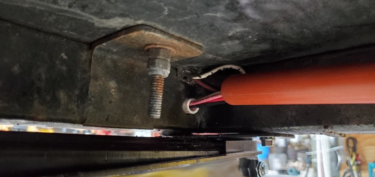

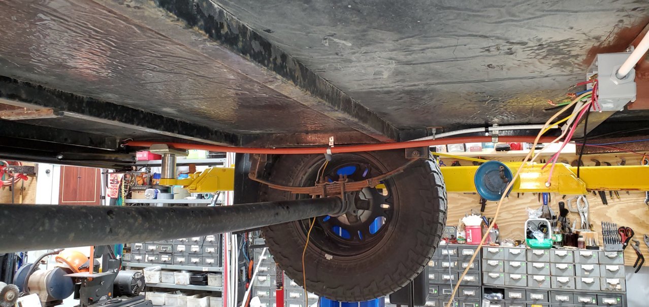

    • Still working through the driverside. Running 3/8 pex to the fender marker with just the hot and ground. Then running the 12v fan-tastic fan hot and ground, the 110v single insulated line, and the 4 wires for the tail light wiring
    Hafaday and 3pooches[OP] like this.

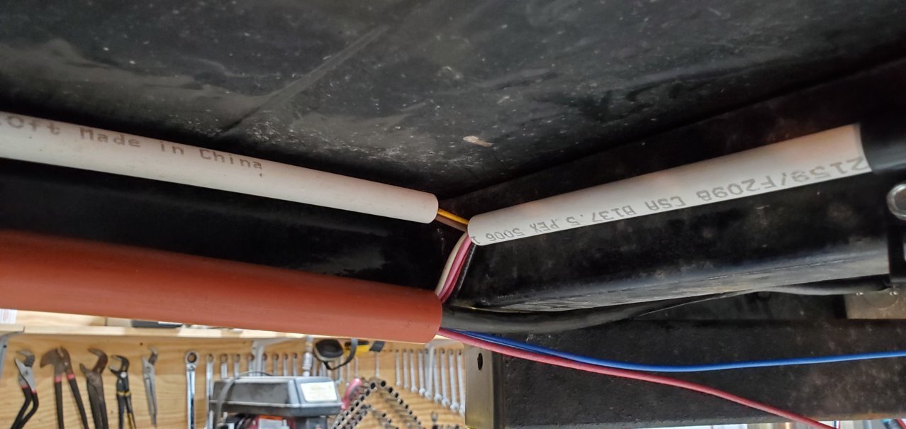

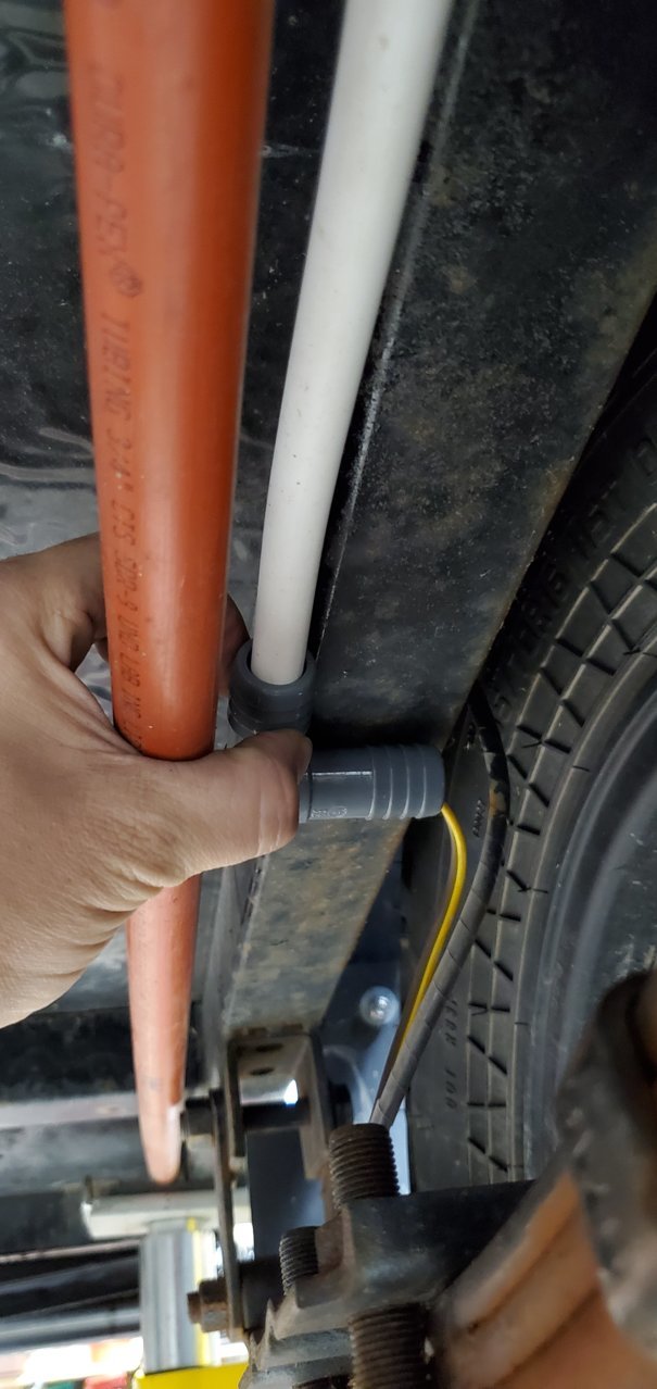

    Good use of pex:thumbsup:

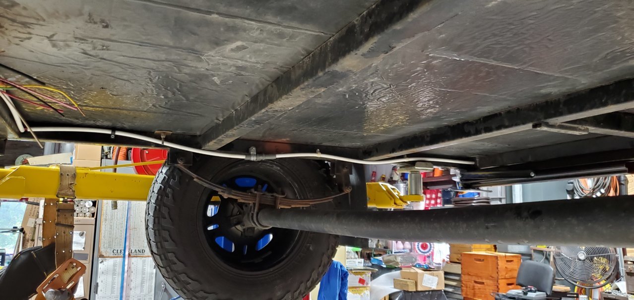

    is that axle bowed?

    Gives it a little extra bounce going down the road.

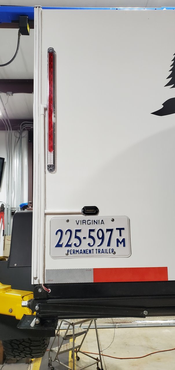

    Yes...:bananadance::boom:well at least it plays into the timbren axle-less.upgrade down the road!
    Did make progress, looking like it might be road worthy, got a few hours of buttoning up wiring up to the fender marker light on driver side,.then solder and heat shrink the main junctions in the box!!!
    I'll update y'all in the morning once I'm heading up, likely early afternoon arrival.
